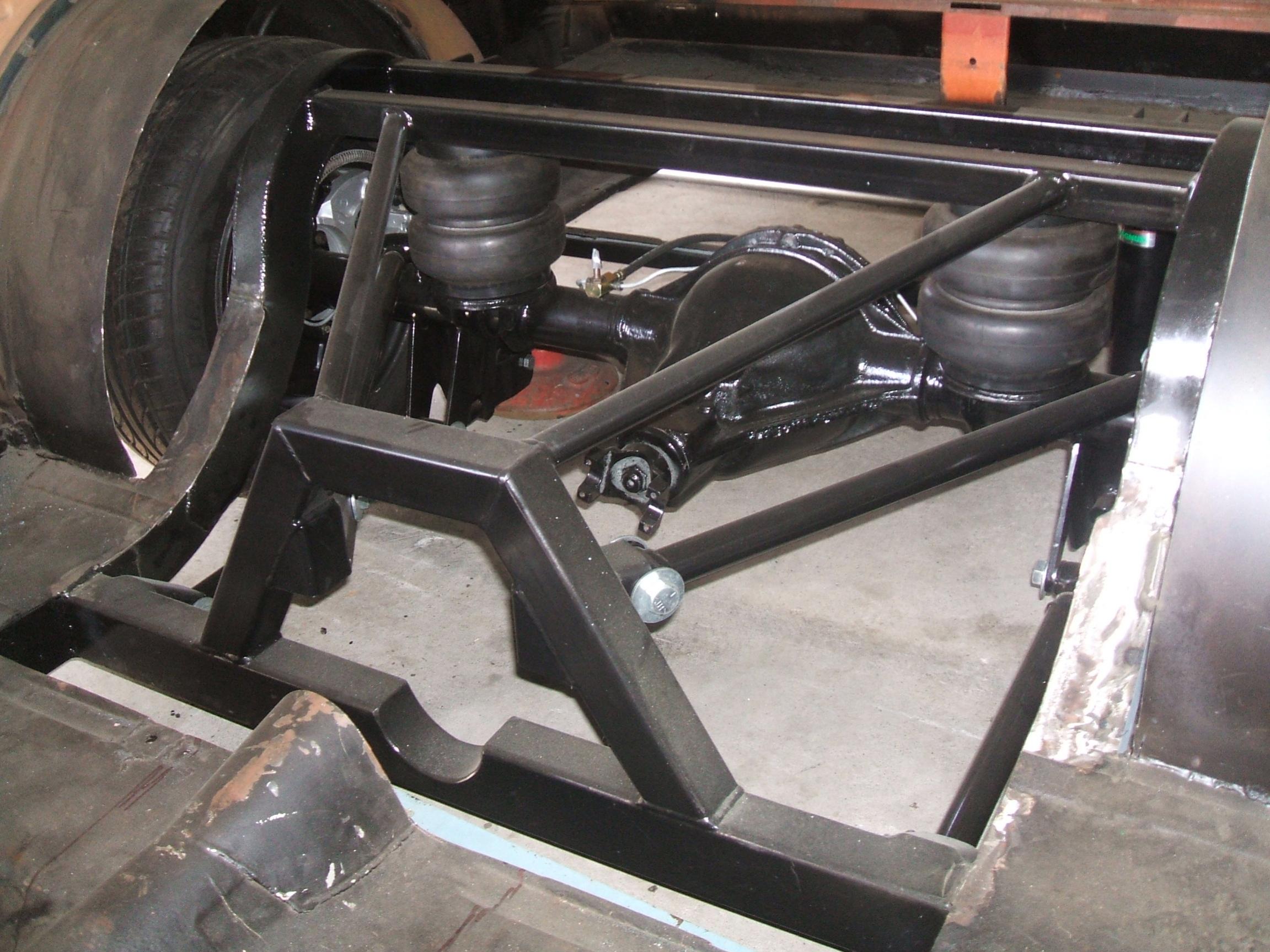

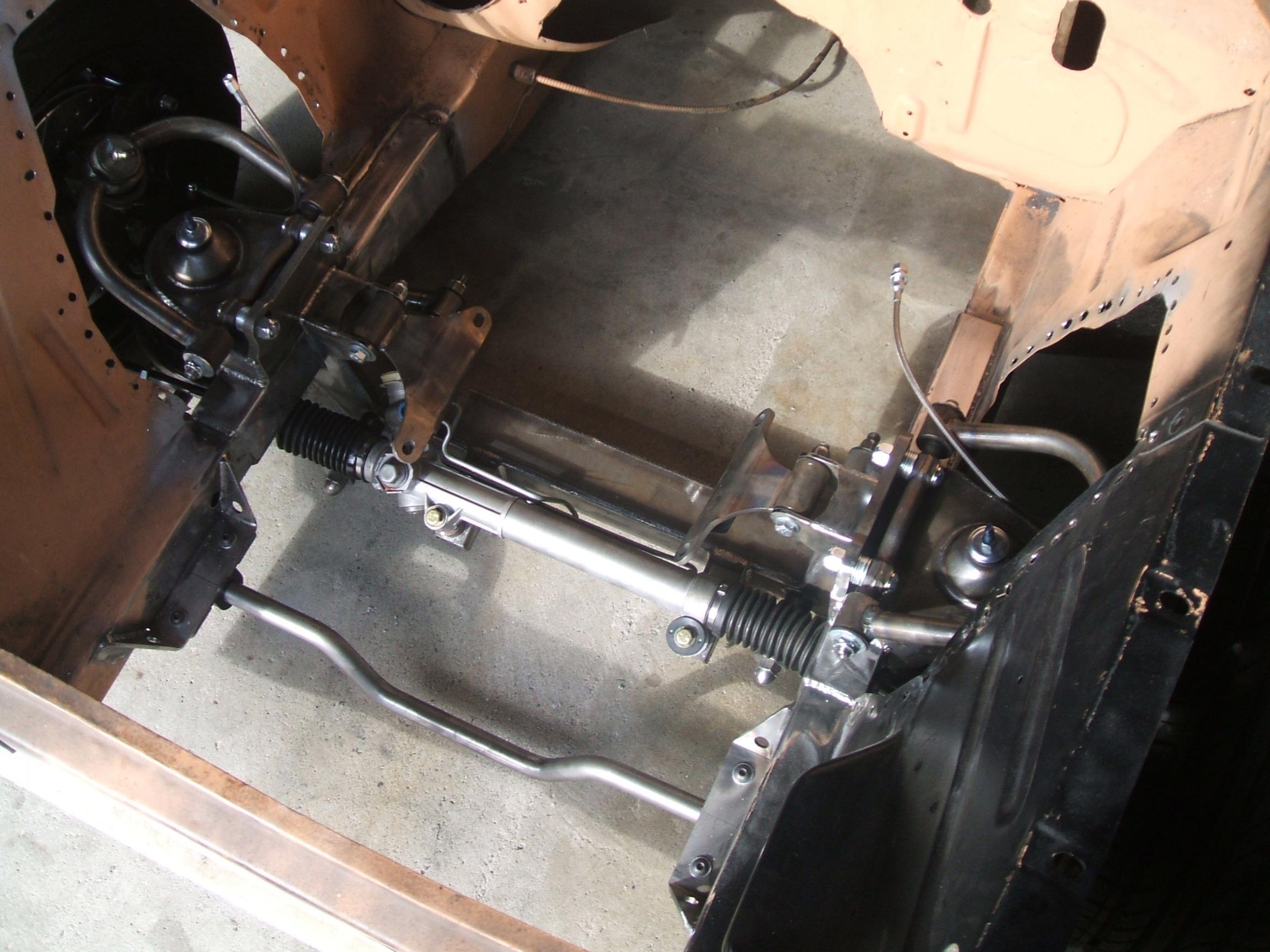

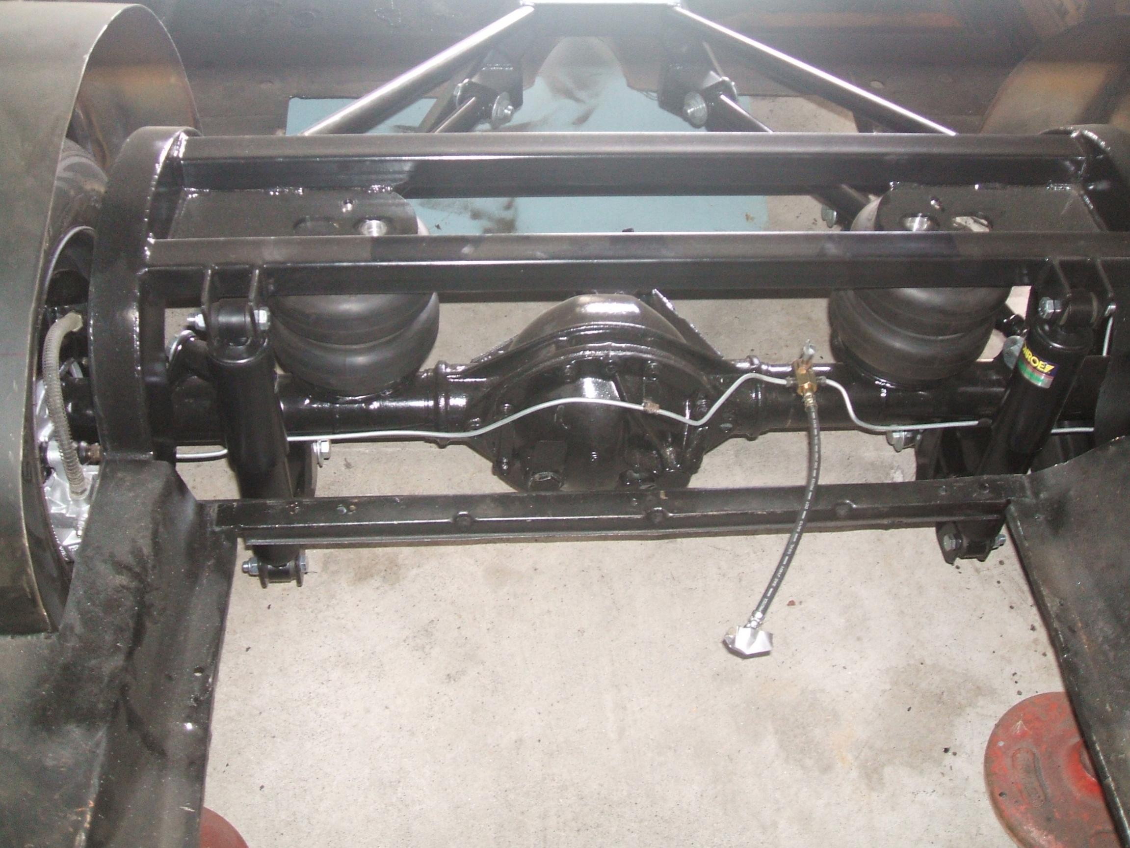

    Some real nice work been done on some of these old falcons on this thread! Mine is in storage for now, but when I left it had just installed the TCI front end and finished the rear set up.. not as pretty as some but you make do with what you have.. angle grinder and a welder

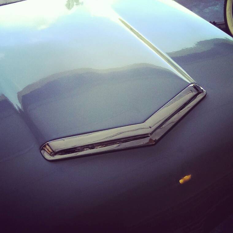

    I finished the hood today. Color sanded and buffed it this morning, and this afternoon the chrome shop had the boomerang done. Sweet timing.
