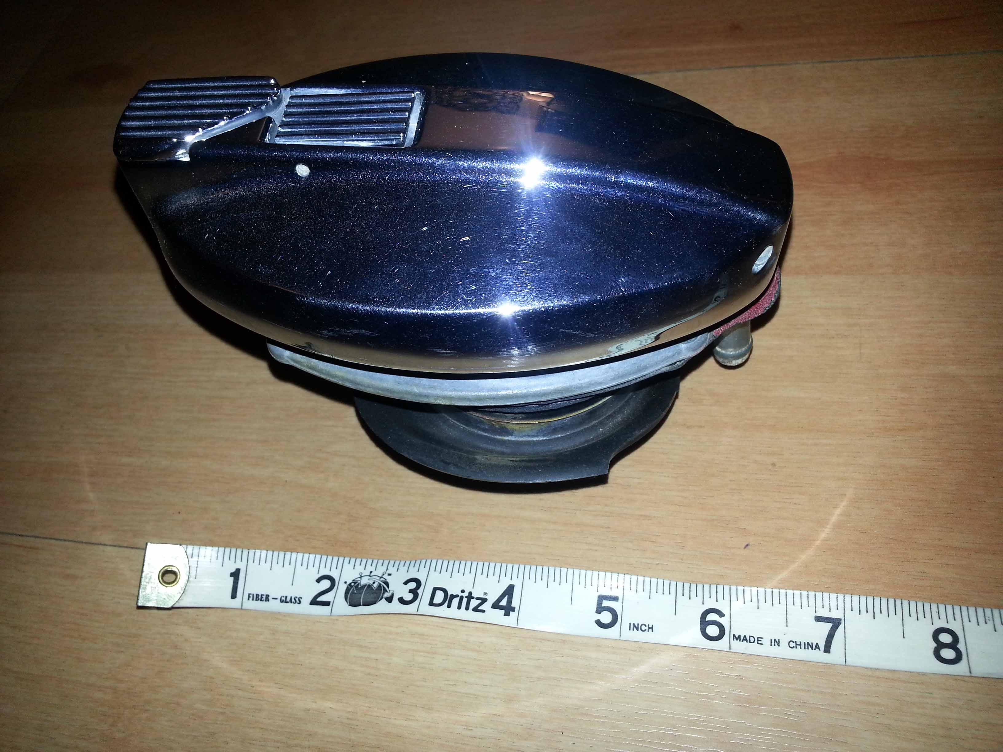

    Got the Jag cap, for $30, delivered. Just need to fab up a little recess, and drop it in to the quarter panel.
    Even though it is a later model part, it still, to me, has a 60's vibe to it.

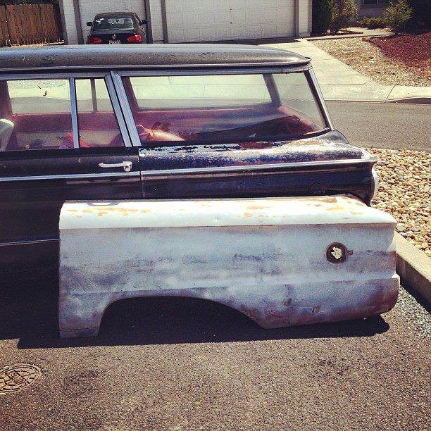

    They are still out there I bought a quarter recently

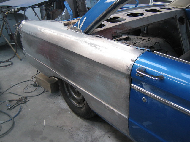

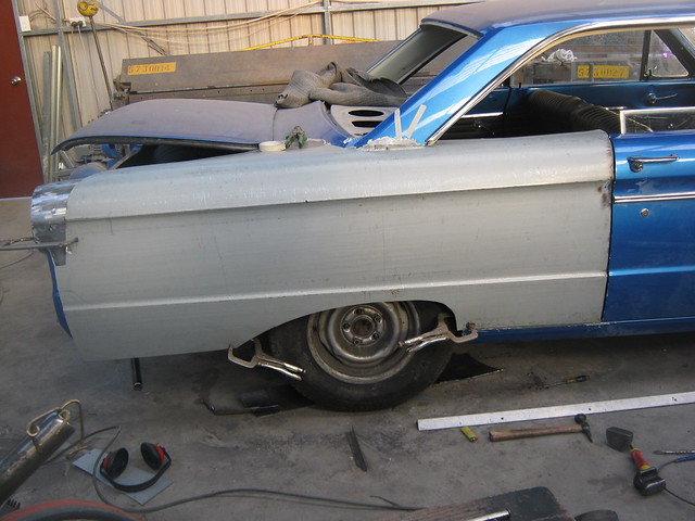

    I posted these on the metal shaping thread and thought you Falcon guys might be interested too :) This particular Falcon had been in the wars and had had a few different sections welded in here there and everywhere. first the old...
    and the new ...was best to cut it off and start fresh
    was a bit of a trick getting the gentle curve into the upper bodyline ,but it worked out pretty good and needed only a minimal ammount of filler to finish ,mainly on the joints.
