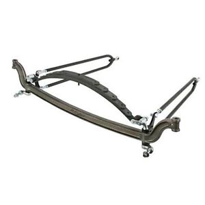

    OK< I sold the wagon and I'm picking up a 62 Falcon coupe on Friday, I am going the way of a g***er I think, do I have to use those twin spring dropped axles, or do you guys think the cars weight is lite enough to where I could run the mono spring with hairpins?
  22. 1971BB427
    Joined: Mar 6, 2010
    Posts: 10,137
    1971BB427
    from Oregon
    Depends on height, and weight. The higher it goes, the more the transverse spring setup will be affected by the weight of the Falcon. Of course the spring weight rating will also have some affect, and might need to go a little stiffer to avoid handling issues on a Falcon.
    I have a friend who has one in his GTO, and runs coilovers for shocks, as he races it, and says it got squirrelly above 100 mph. The shocks solved that issue, and his car has been over 160 mph in the 1/4 and is stable. Of course he's not doing a ton of turning, just minor corrections.

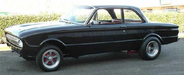

  23. stickerdick
    Joined: Jan 26, 2013
    Posts: 149
    stickerdick
    I don't want to go high at all, I'm doing a "g***er" but not a "G***ER"! I want to have my version of what a street racer might of looked like if I could have driven in the 60's, I like the ride height of the black car, the white car is the one I'm picking up this Friday.
  24. 1971BB427
    Joined: Mar 6, 2010
    Posts: 10,137
    1971BB427
    from Oregon
    I think you'll be fine if you're going that close to stock height.
  25. gimpyshotrods
    Joined: May 20, 2009
    Posts: 24,629
    gimpyshotrods
    You can get the stance of the black car with just taller springs. That's about 2" to 2-1/2" over factory ride height. A Mustang V8 spring, from '65-'66 and a 1" isolator would put you there, for about $100.

  27. 1971BB427
    Joined: Mar 6, 2010
    Posts: 10,137
    1971BB427
    from Oregon
    But it wouldn't say g***er like a real straight axle will! And after owning/building numerous straight axle cars, they can ride and handle well if you know what it takes to set one up.
