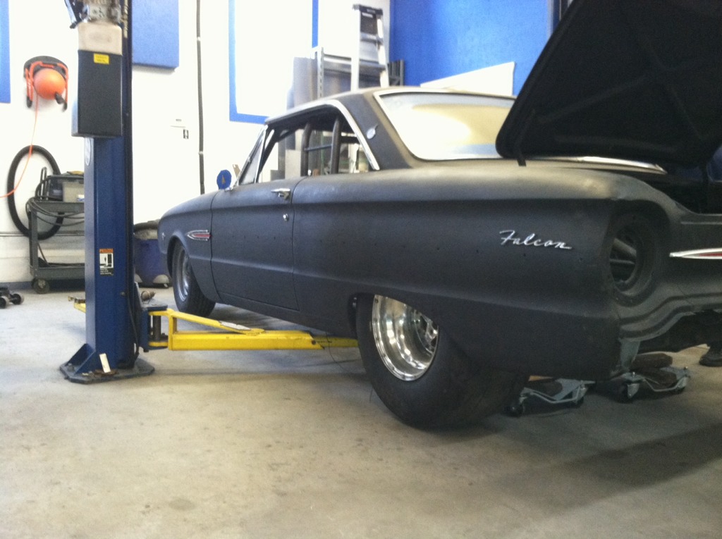

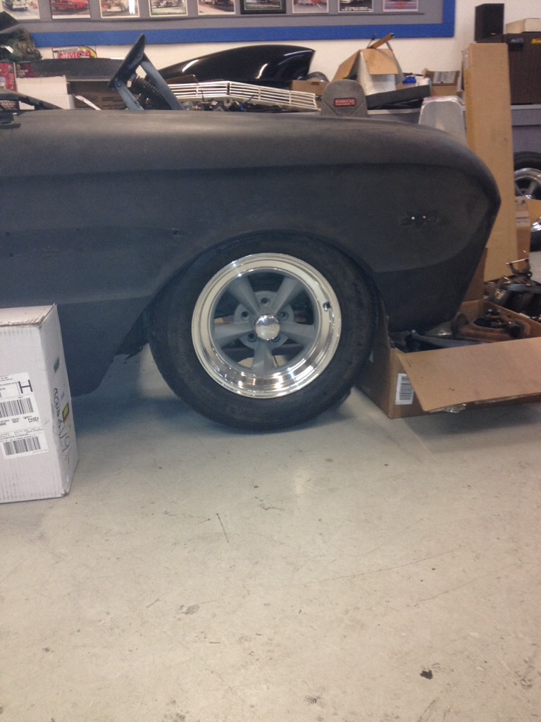

    How 'bout we get back to something a little more interesting? My junk's in the weeds. ImageUploadedByH.A.M.B.1394684696.336402.jpg

  23. OlAZGuy

    That's what we need. More pics of you Falcon. ****.

    What the hell is goin' on inside the cabin? :eek:
    Yer' such a tease....

    It's a race car man! SFI 25.2 cage. It looks kinda like a jungle jim inside.

    Now that I like! Are you leaving it satin black or putting a vinyl wrap on it like all the cool kids are doing?

    If his other race car (school bus yellow, LOL!) is any indication, I don't think so...

    Can't afford paint right now so it is what it is. Gotta make some serious fender modifications for the tires but other than that...
