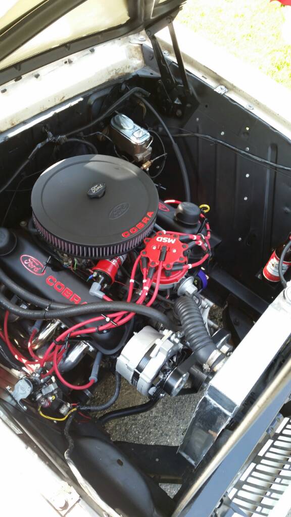

    I'm not sure what right is but I've done something i find right ha. Full Mustang 2 front end with KYB shocks around, full 5 lug conversion, ss brake lines, discs, 67 shelby master cyl, 67 8" rear, built 5.0 HO, t5 world cl*** ****** and soo on.. never would know
