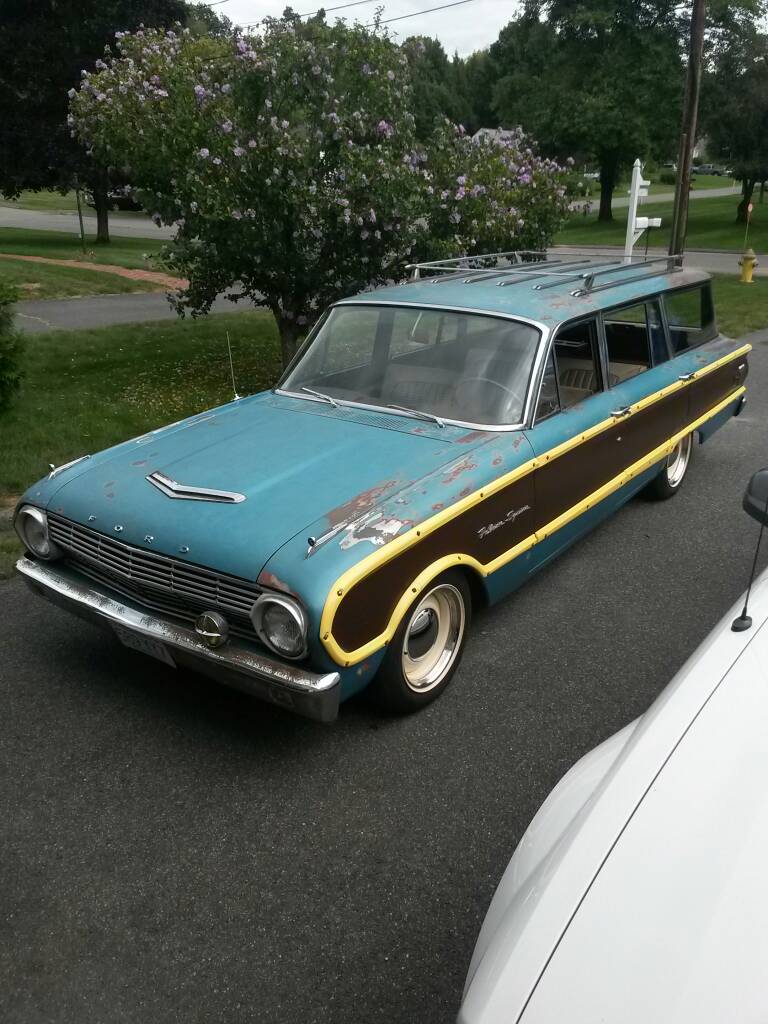

    I kinda like that paneling on the blue wagon.

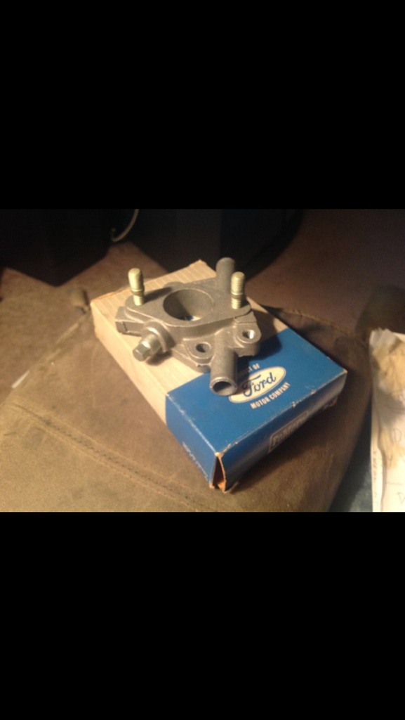

    I was looking at my 200 today and it has the carb spacer that looks like this ImageUploadedByH.A.M.B.1409276041.236065.jpg
    What's the water lines for?
  24. gimpyshotrods
    Joined: May 20, 2009
    Posts: 24,585
    gimpyshotrods
    It was supposed help improve fuel atomization during cold weather.
