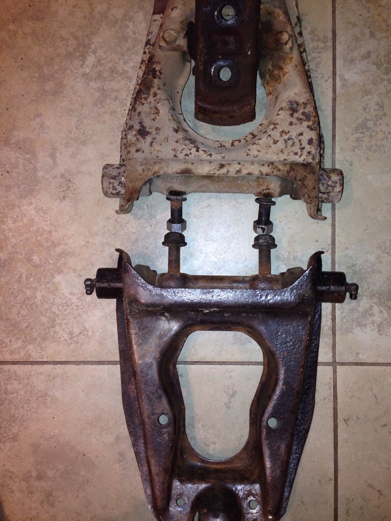

    When I bought them I was told they were off a 65. ImageUploadedByH.A.M.B.1411441122.245806.jpg
    The top one is off my car the bottom is the one I just bought. As you can see the end caps on the bottom one are longer. Do these grease fittings look big?

    There are smaller ones. Those are circa '65 arms.

    Yours is a 63 right? Even with the shims in place the rear grease fitting hits. I would like to avoid drilling a hole in the shock tower for clearance.

    I wasn't sure if the towers were different. If I have to rebuild the uca I might as well buy new with the cost of shafts and ball joints.

    The towers are the same width where the control arm is '60-'66, Mustang, Comet, or Falcon.

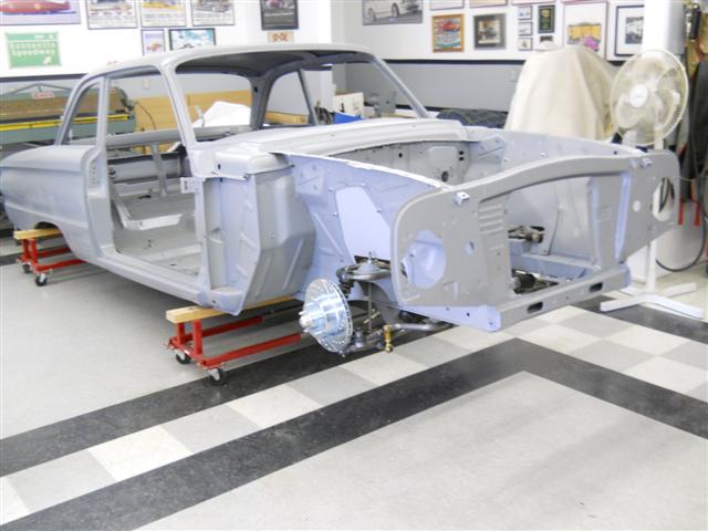

    The 260 mounts have the same spacing as all the other Windsor based SBF engines.
    You'll need the right and left rubber insulated engine mounts (Rock Auto DEA A2220 and A2221).
    The V-8frame mounts:
    http://www.falconparts.com/ford-falcon-auto-parts/pc/1960-1965-V-8-FRAME-MOUNTS-65p492.htm ,
    And the intermediate brackets:
    http://www.falconparts.com/ford-fal...1965-V-8-INTERMEDIATE-MOUNT-BRACKETS-p547.htm
    It looks like this.....I'm using an 87 E7TE 5.0/302 block.
