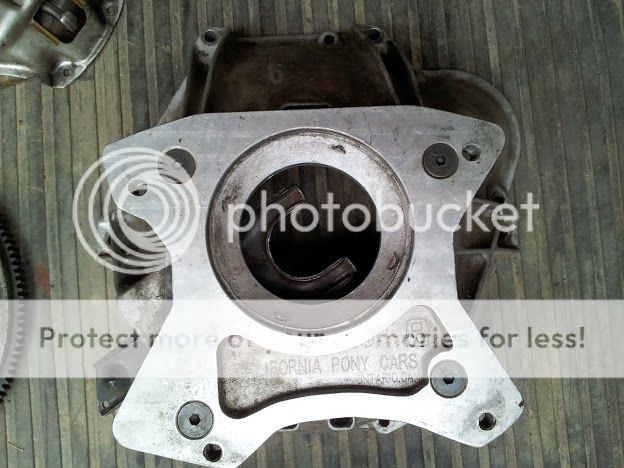

    Trying to identify the bellhousing I used when I did the T5 swap. The whole mess was a swap meet score. The CPC adapter came with a Bell, clutch, flywheel and starter.
    The starter is going out. I remember that the starter from my 63 3spd/170 did not bolt up so I used what was included. Just looking for an idea of what to order.

    It looks like a 9" Falcon-6 clutch bellhousing.
    If the starter is held on with two bolts, and not three, you would ask the parts jockey for a starter for a 1965 Mustang, with a 200.
