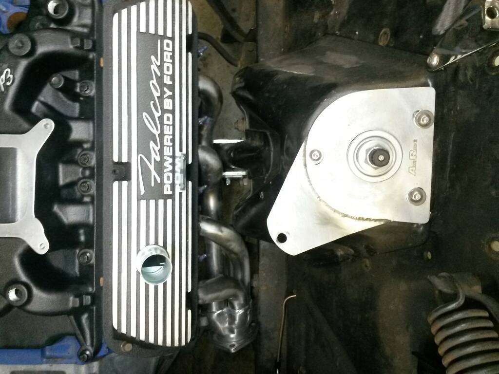

    Sanderson headers in my 63.. trans is not attached just testing they are close !

    Hard to see in the pic, but I suppose it clears the steering box okay?
    Ordered my 289-302 based/AOD set last week.

    Yes clears it just fine , don't knoW if the steering box for the six is smaller but you should be very pleased

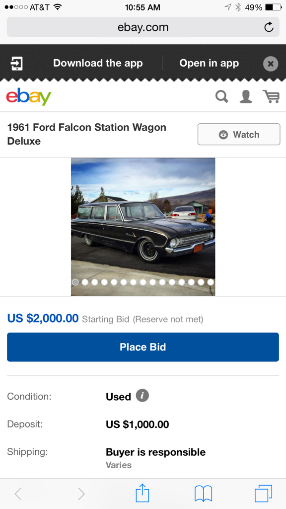

    Well as much as it saddens me to say it. I just put my 1961 falcon wagon on eBay, if anyone knows anyone looking please let them know. ImageUploadedByH.A.M.B.1421781469.736091.jpg

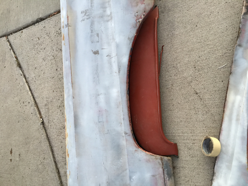

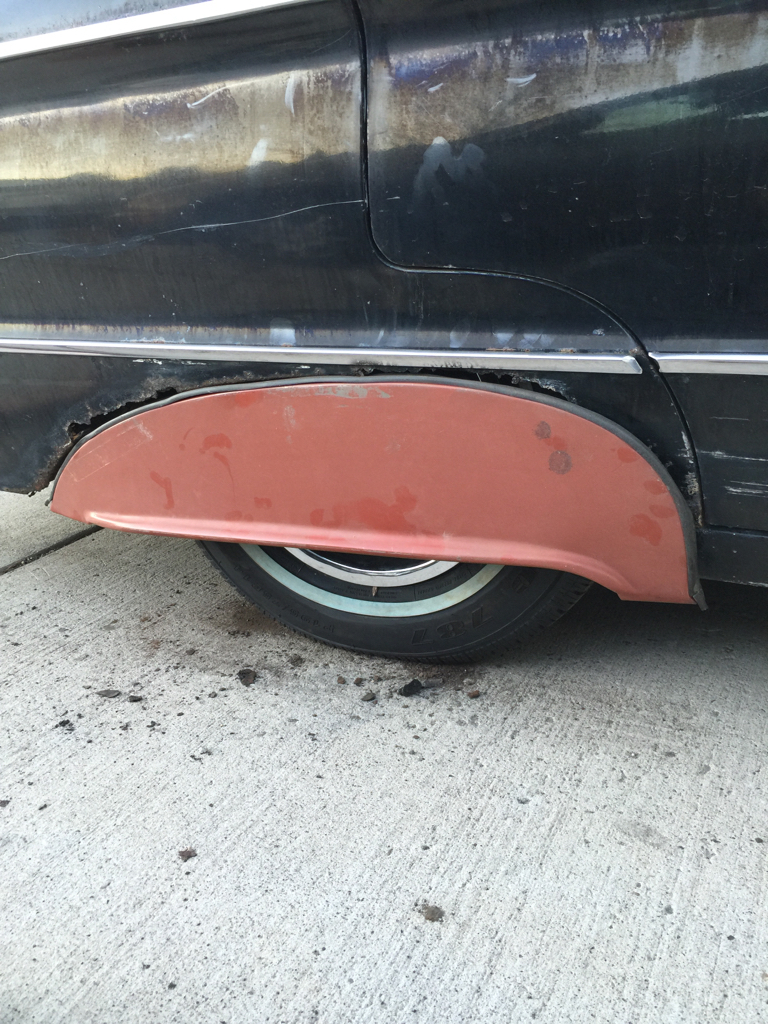

    I bought these from someone on here hoping that I could make them work for the falcon. Maybe someone can help me figure out what they're for. I would need to modify them a LOT to make them work for the wagon.
    ImageUploadedByH.A.M.B.1422235727.647610.jpg ImageUploadedByH.A.M.B.1422235780.154717.jpg ImageUploadedByH.A.M.B.1422235807.038834.jpg ImageUploadedByH.A.M.B.1422235836.528224.jpg
    In the 2nd to last picture you can see how much would need to be trimmed to work for the wagon.
    I ***ume they are fox craft the last pic is the stamping on the lip. ImageUploadedByH.A.M.B.1422238561.010363.jpg
