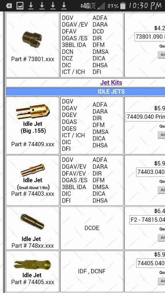

    For those of who who have a weber carb. Which idle jets do I need the big or small one on a dgav. Im going with primary 60 and secondary 50.
  26. gimpyshotrods

    I was bidding on one at the time but didn't win. I was a little confused when looking online for the jets. It appears that the big or small idle jet will work for the dgv series but only the small idle jet for the df series. http://www.carburetion.com/Weber/weberJets.asp
  28. Falcon61wagon
    Joined: Mar 15, 2014
    Posts: 133
    Falcon61wagon
    from Indiana
    Looks like the 74409.**x is the primary and 74403.**x is the secondary.
