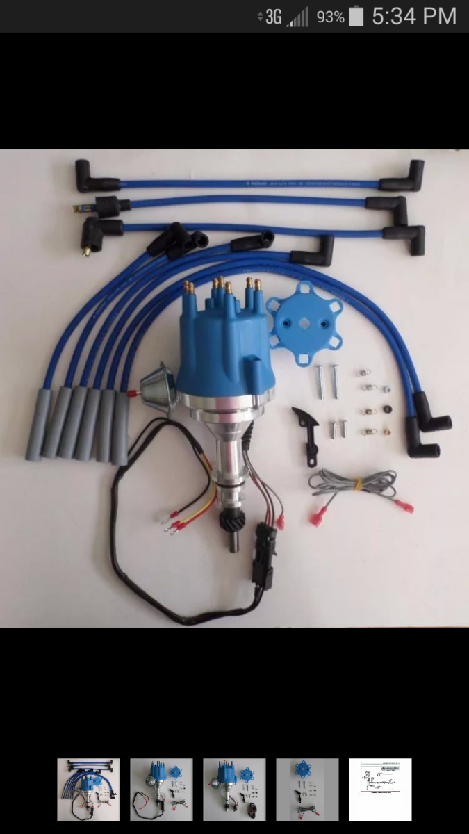

    I have not done much to the falcon this summer but still have been collecting parts. I picked up a used dura spark II and recently saw a new hei dizzy for the six, sporting a small cap. I was wondering if anybody else had tried this one and if the cap is considerable smaller than the regular size.
