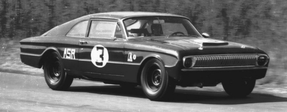

  23. hotroddon
    Joined: Sep 22, 2007
    Posts: 28,240
    hotroddon
    There were 3 I know at least one survived and has been restored. there were called the Challenger Falcon's Holman challenger.jpg .

  25. gimpyshotrods
    Joined: May 20, 2009
    Posts: 24,585
    gimpyshotrods
    The originals, if I remember correctly, are a 3"chop, and a 3" section.
