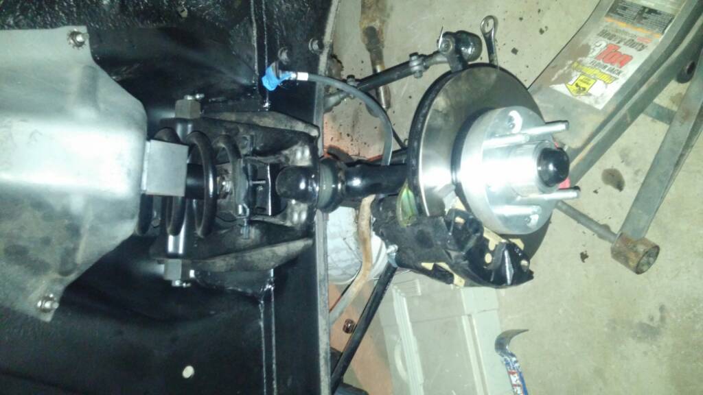

    I sand blasted the 7mm wheels sprayed them with urethane and the found out the dog dish caps wouldn't fit (shaking my head as I type). Is there an alternate cap that would look good? I'm trying to stay close to stock but I don't mind suggestions. Also I couldn't figure out how this clip that came with the pads was supposed to be used.

    :D I do believe that is called an anti rattle spring.
    Good luck.Have fun.Be safe.
    Leo

    Yes, but how is it used on this particular application.

    :DThe narrow side goes in the puck.It keeps the brake pad from ratteling.
    Leo

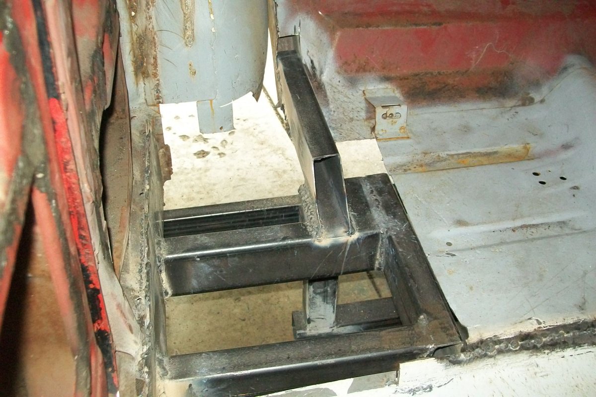

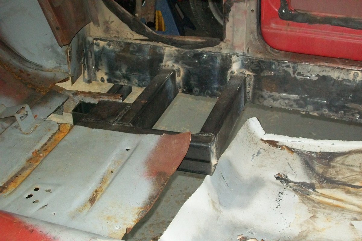

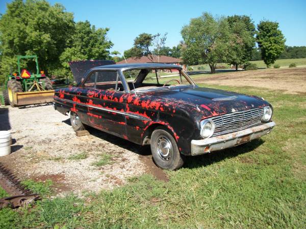

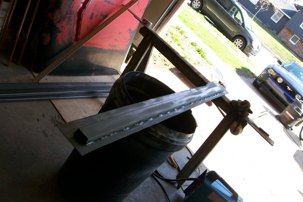

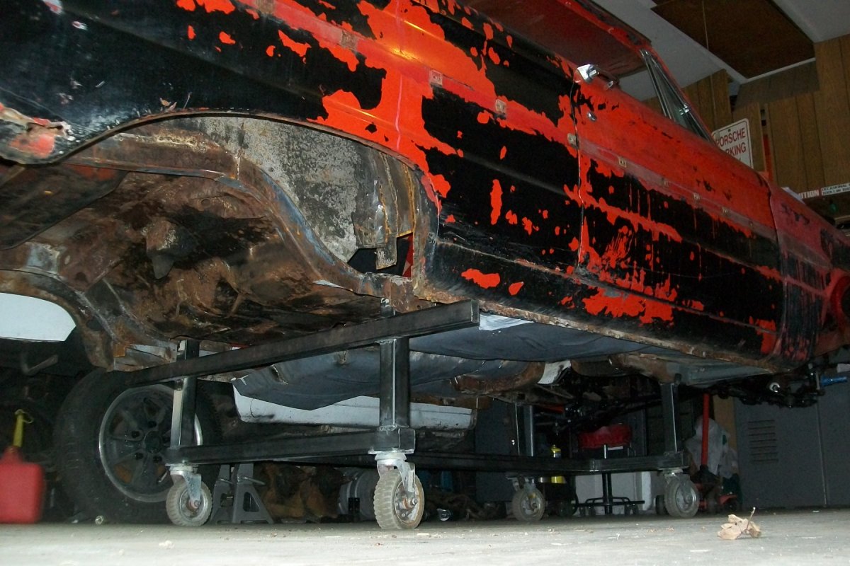

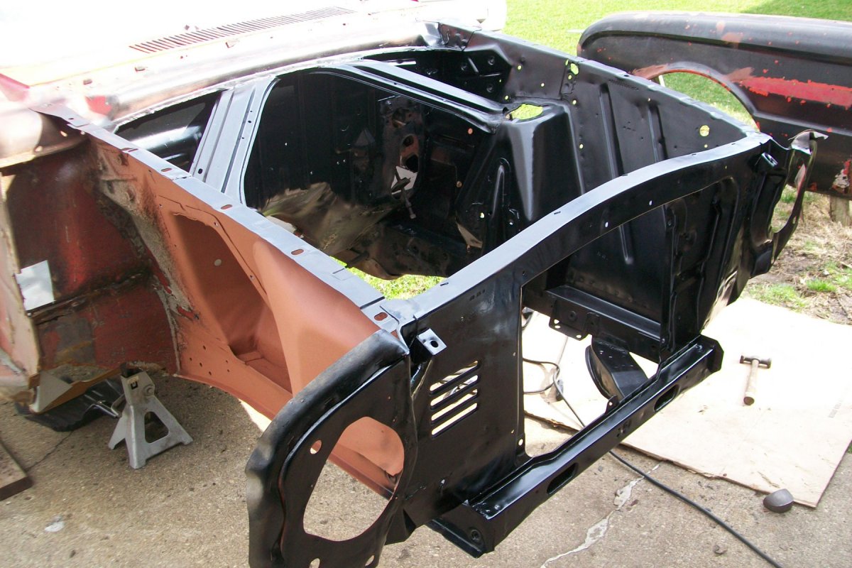

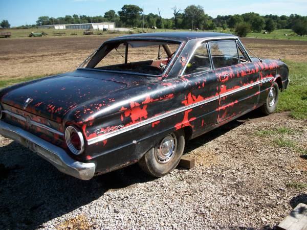

  5. New guy here, here are a couple of before and during photos of the 63.5 hardtop I picked up last fall. It's a bit of a basket case I'm afraid. It was originally a Rangoon red/red interior car with bucket seats and console and three on the tree. So far I've put new floors and inner rockers in it ( did the rockers twice but that is a story buy itself). I've mini-tubbed it and am now working on the rear sub frame section.
    One thing I've done that I haven't seen talked about is to put some 1X2X.120 wall tube inside my rocker cavity. It is welded to the back side of the inner rocker sheet all the way down and then the front torque boxes tied in like normal. My rear frame rails are 1.5X3 tube and tied in directly the rocker tubes. I guess my question is do you think I'll still need to put in a more traditional set of subframe connectors in addition to the tubes I put in my rockers? I'll be running a 347 with a toploader four speed and 3.73:1 geared 8.8 rear.
    Hopefully, by the end of this project, I will learn to weld worth a ****, cause so far I **** at it!! I'll get a lot of practice though, lol.

    IMG_1150.JPG I put 4" x 3" x 0.120" steel the full length of my rocker channels in my '63 convertible (the convertible has a bigger inner rocker and the 4x3 slip-fit nicely). Spot welded on the tops and inside channels, fully welded on the bottoms and around the torque boxes. No need for added subframe connectors after that.

    Good idea shared with me by a fellow '63 convertible owner. Pay it forward.

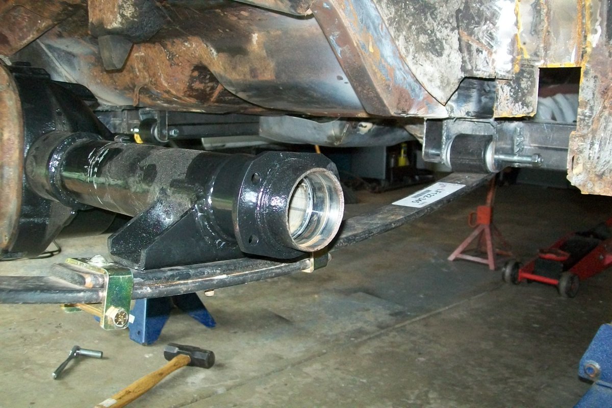

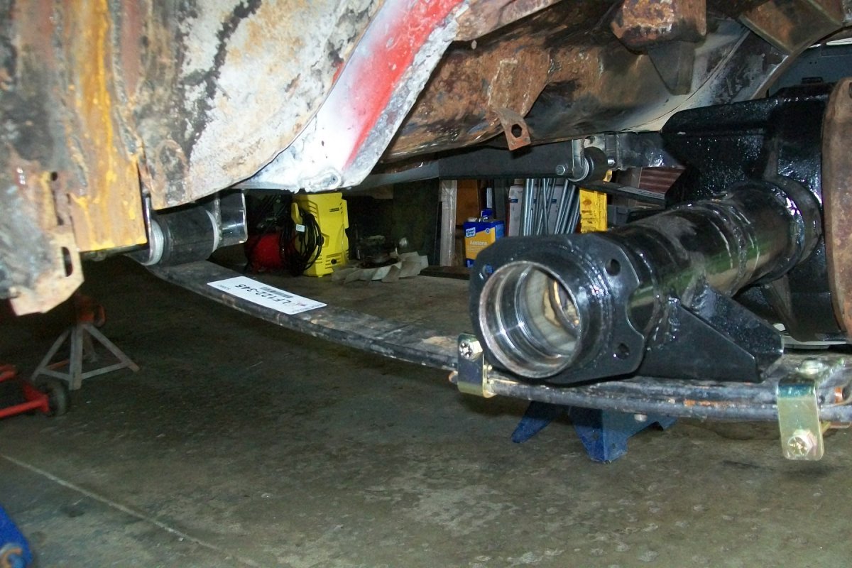

  18. Again got some time to work on my 63.5 hardtop, this time fabbing the new heavier spring mounts. Lot more to go, but I guess it's a start lol. 100_3922.JPG 100_3923.JPG 100_3917.JPG

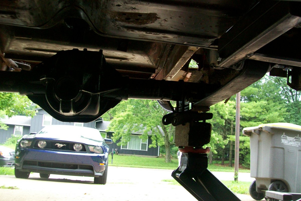

  24. Got some more work done this weekend. Got the new rear torque boxes welded in and tied them to the rear frame rails. Also fit up the narrowed 8.8 rear on the mono leafs. Almost felt like progress! Still, more welding, grinding, wire wheeling, etc....
    loudbang and Gammz like this.
