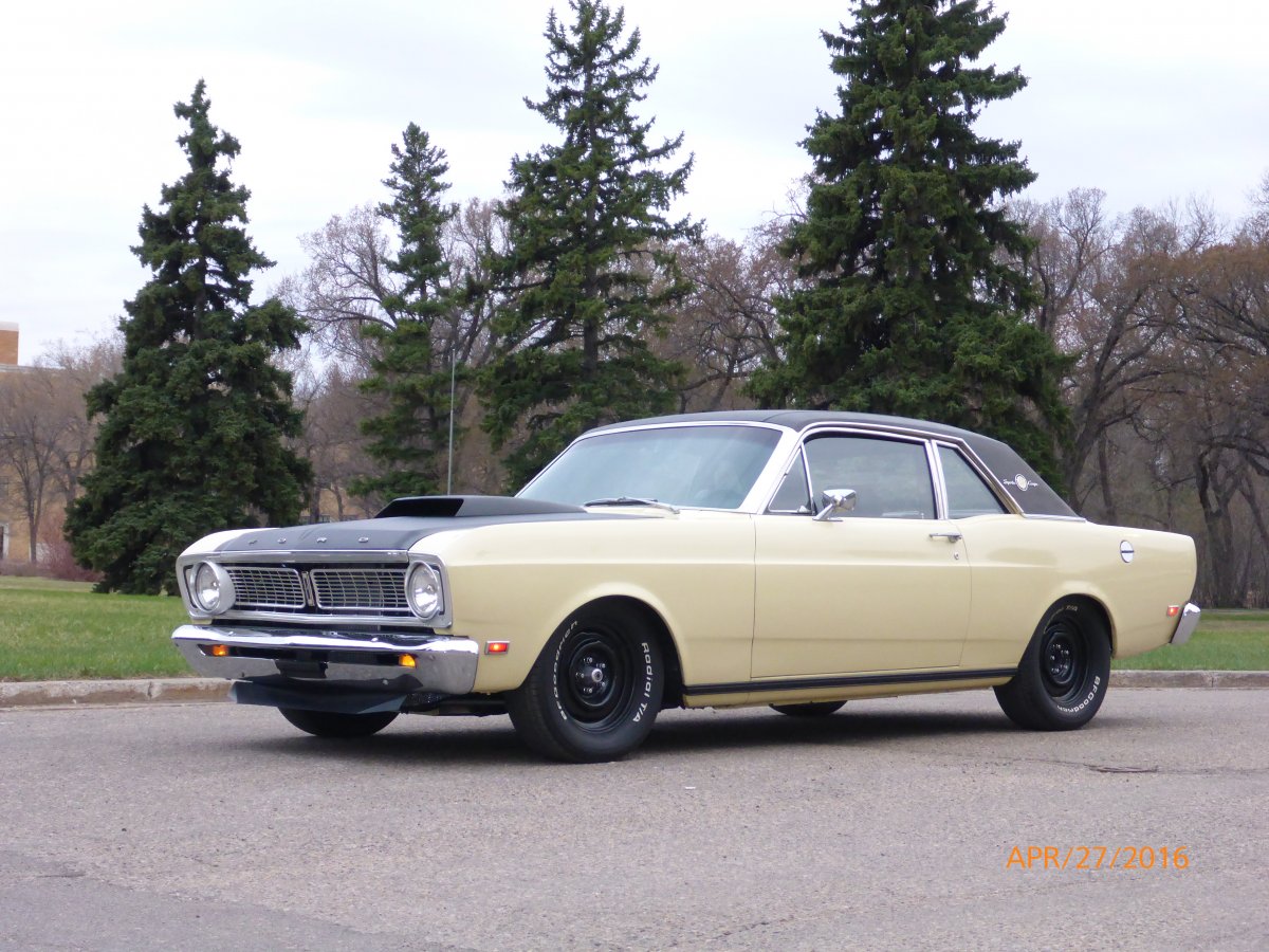

  14. P1020502.JPG P1020239.JPG A very good friend & I spent 6 months last (2015) Fall/Winter/Spring,completely rebuilding my Falcon.(less body & paint).
    I realize that they are only stock once, but in this case "stock" was boring.
    My car started as a 69,000 Mi., 1 repaint survivor. All stock.
    We installed a 331 stroker based on a 5.0L that Dyno'd @415 HP w/399TQ.
    The trans. is a C4 with shift kit & 3300 stall converter.
    The rear end is the stock 8" with a posi unit & 3:55 gears & Moser axles.
    We also lowered the car 3' all around & installed frame links.
    We converted the car to 4 wheel disc brakes.
    The undercarriage, engine compartment & trunk were cleaned & detailed & new carpet, gauges & a B&M floor shifter were installed.
    I had the new exhaust installed & took the car directly to our local car show(Majestics),
    where I spent a couple hours cleaning & detailing before the show.
    I know, I know, this sounds like another episode of (insert any popular "car" television show here), but we honestly finished with just a couple hours to spare!
    All the hard work paid off, I won 1st place in my cl*** as well as a being chosen for a Big Brothers Canada Choice award!
    Since then I have put on about 4500 trouble free miles.
    I can't get enough, it is a completely different animal!
    I am pretty proud of this car as it is the only car that I can honestly say I've finished.
    Sorry for the O/T vehicle but the ***le said "Falcons Done Right"
    This also creates a new problem, what's next.
    I have since acquired a more HAMB friendly project that I will start on in the spring. see above.

    Very cool Big Bird, but definitely not HAMB material. Nice Shoebox, I'm sure you'll do it justice!
