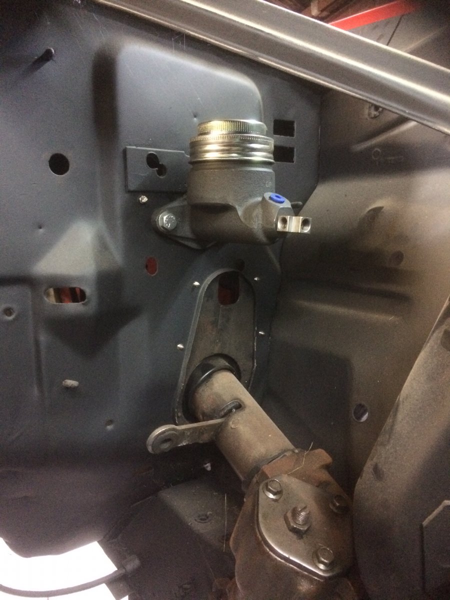

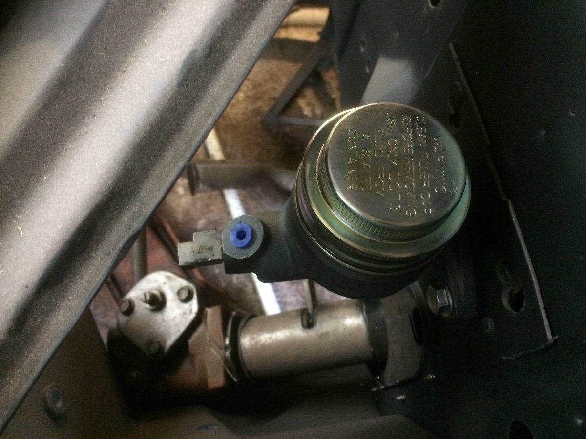

    Can anyone provide a picture of the engine bay brake line routing from the m/cylinder? I have a t-piece and brake light switch (not shown) as well as the split union as pictured, all of which came off it, but can’t figure out which lines are T’d where.
    Does the rear come off one outlet on the master and the fronts off the other? Or does it not matter?
    63 Falcon by the way

  6. 62rebel
    Joined: Sep 1, 2008
    Posts: 3,233
    62rebel
    Right side feeds rear brakes, front port feeds front by going to a splitter. Brake light switch on top port. Best I can remember.

  7. Gammz
    Joined: May 10, 2015
    Posts: 806
    Gammz
    from Lincoln Ne
    Mines other way round. Pressure sensor is on the bottom. But yeah. One to the rear and a spilt fitting to the front for left and right.
  8. Boulderdash
    Joined: Jul 24, 2009
    Posts: 154
    Boulderdash
    Thanks guys, that's great. Just wanted to be sure before bending any brake lines

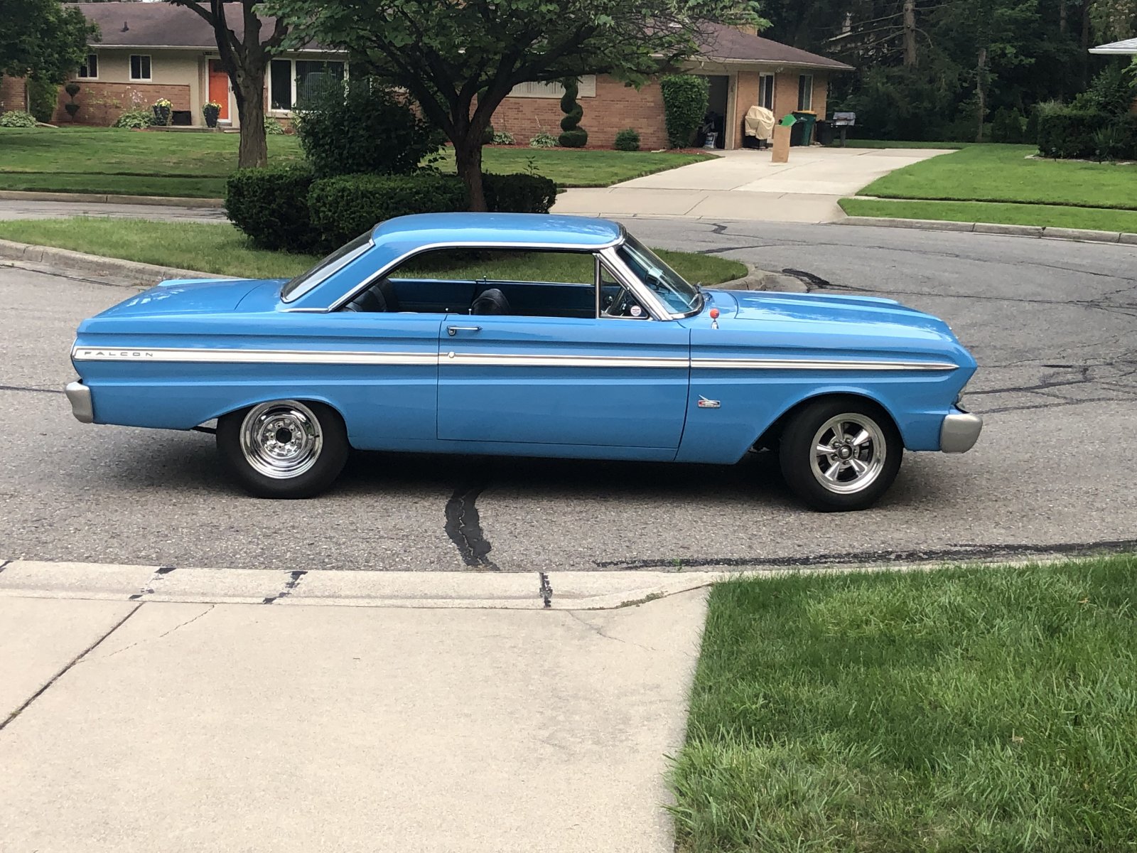

    loveoftiki
    from Livonia,Mi

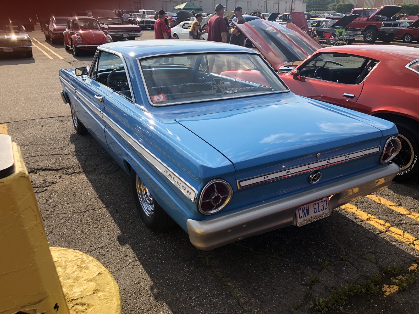

    Mines finally on the road…gotta do new leaf springs, frame connectors, and my traction masters…but she’s running well…plenty of power..sounds like a beast…no leaks, runs cool, great oil pressure….only regret…should of put in a mew steering box… 23634C79-6A18-4D84-B7D9-28CB02053899.jpeg DDB67E02-16F5-4D06-B9D7-B3CD5B662BE8.jpeg 22E8599C-2DD9-4B31-A02C-08B7DDDEF129.jpeg 35FC2AC8-71DC-4F90-9CAD-B3DC15BE877A.jpeg 85C11A78-2E94-4AAD-B868-8CD1E1A768B5.jpeg ABC5008D-95A6-49D7-AB00-760D7943FD94.jpeg 9D2C9171-00AA-4B9B-80CB-B0BEB0FE608A.jpeg
    Silva, shortypu, Deuces and 4 others like this.
  13. loudbang
    Posts: 40,349
  14. loveoftiki
    Joined: Nov 11, 2006
    Posts: 9,190
    loveoftiki
    from Livonia,Mi
    Thanks…I’m pretty happy with it so far. Still getting used to it…had a ohh Sh****t moment when I thought I was in 3rd gear and wanted to down shift into second…..nope I was in Second…quick chirp of the tires and high Rev of the motor, and my heart coming out of my chest..never upshifted so fast in my life
