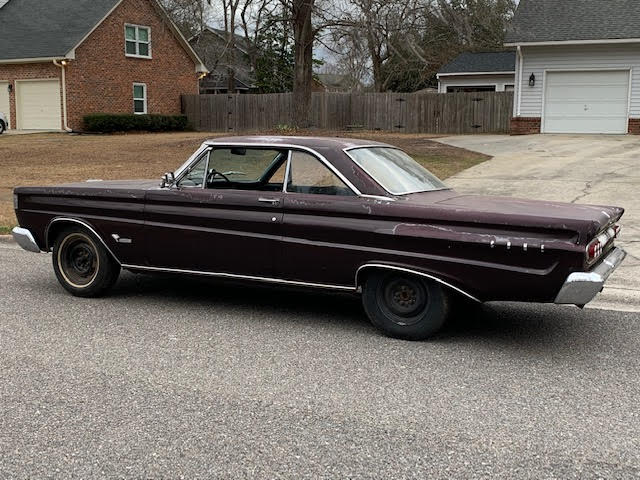

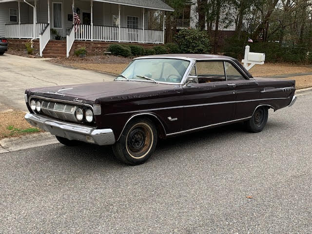

    This one is WAY out of my usual build range, but I have always had a soft spot for these little hard tops.
    Very patina'd dark maroon. Original color, but not original paint.
    I don't get all goofy about numbers matching stuff, but she is an original K code Mercury Cyclone with all the cool emblems, dash tach and correct vin. She rolled out of the Cincinatti Ohio plant in May '64 dark maroon, black bucket seats and autoflush.
    It ran when I picked it up, but the ****** is already on the ground.

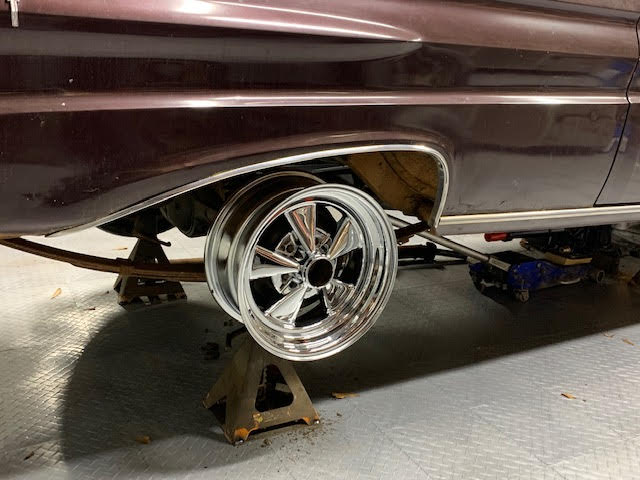

    I remembered why I quit being a Ford guy about 30 years ago. There are 76, 843 different flywheel possibilities for the small block Ford.
    You can still buy Cragars new (made in the USA), but they are not 50 bucks a set anymore.
