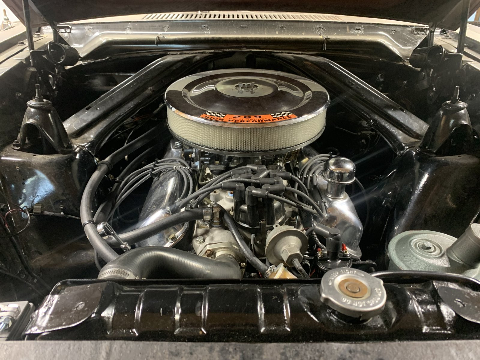

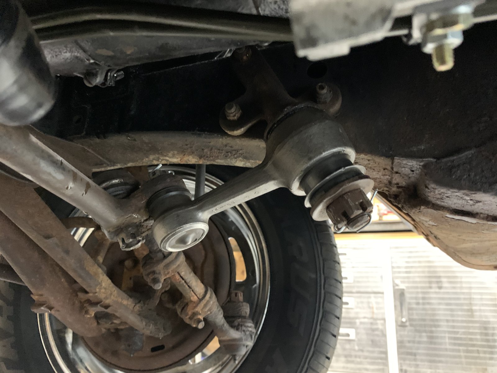

    More teeny weenie progress updates. After 3 different idler arms, I found out this idler is Cyclone specific. I was kind of dreading trying to beat the old one off, but it didn’t put up a fight.
    Just a bit of tiding up the engine. Pretty much done under the bonnet.

    The idler arm is specific to the ‘64 Comet V8 cars, (and maybe Falcon) in 1965 they changed the steering linkage to the same design as the new “pony car” except for the center link that is narrower on the Comet/Falcon. Now it is popular to convert to the ‘65 style, because of parts availability and better steering. The ‘64 had some bump steer. I converted mine to the newer steering in the early ‘70’s when I installed the Boss engine, and needed clearance for the headers.

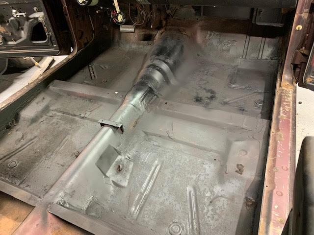

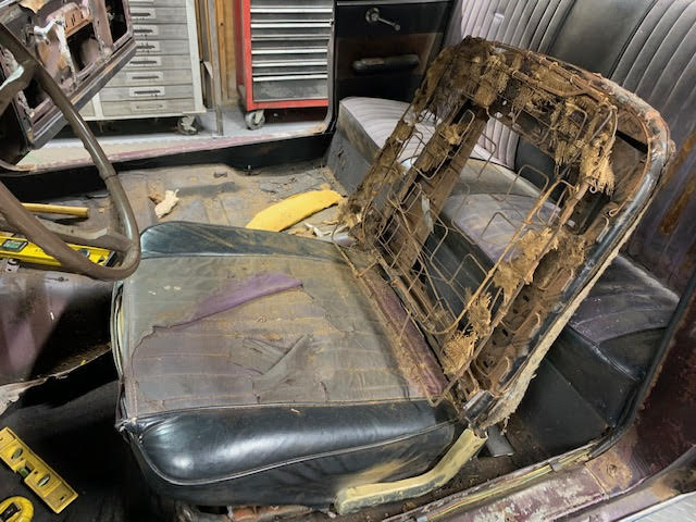

    Just a quickie Comet update...
    The floors had a few tender spots. Not enough for new pans, so she got a couple patches.
    I'm not scared of a project, but the OG seats were not happening.

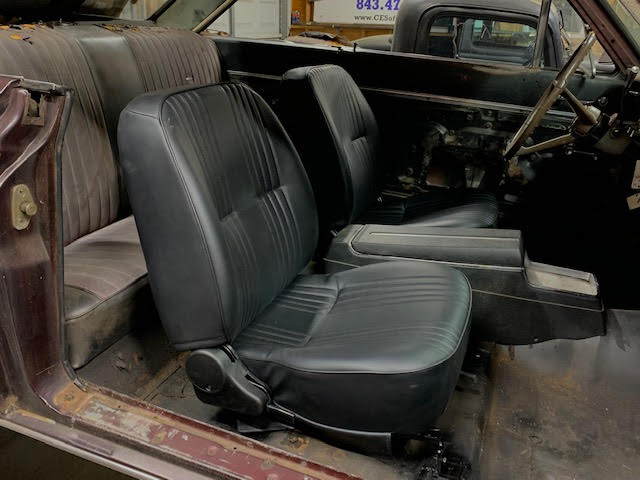

    New set of buckets from Summit. I wasn't sure how these were gonna look live and in person, but they are way nicer than I expected. Might not be perfect for a hard line traditional A-V8 highboy, but they suit this little car just fine.

    Those seats look like they belong there.
    Are they the Procars?

  24. Project is moving along swimmingly!!!!
    the seats look right at home !

    Yep. My upholstery guy wanted a thousand each to do the originals not including the seat covers and I wasn't tough enough to do them myself, so I gave the Procars a shot.
