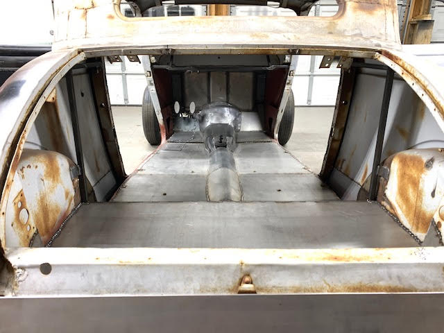

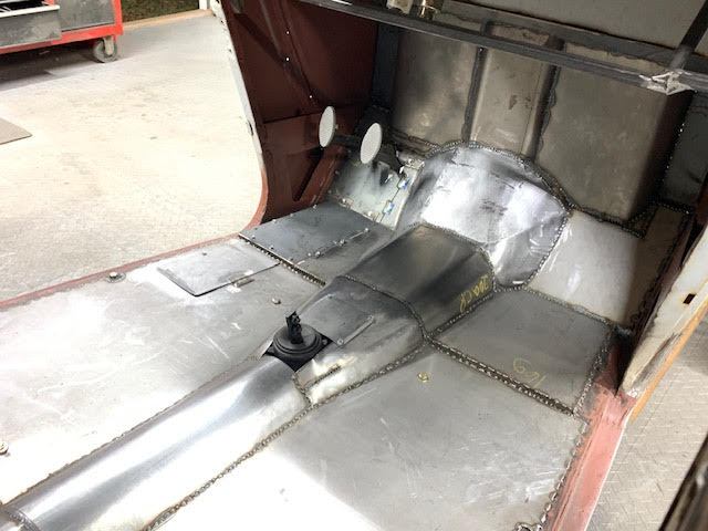

    Here is your Christmas update. Last we checked in, the car was still Flintstone floorboard.
    No in progress pics, but how exciting are floorboards anyway?
    Once a project has floorboards, I consider it a whole car. Yea, a whole car!

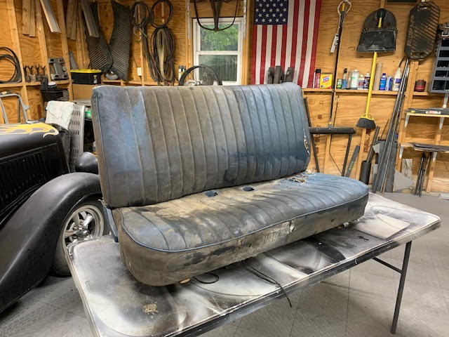

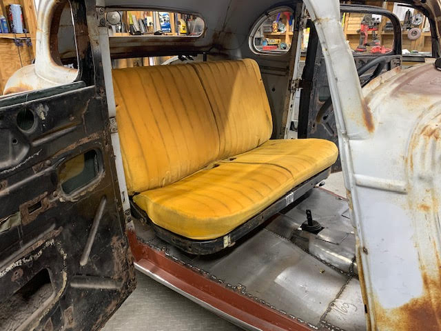

    Plucked a bench seat from a Chevvie S10. Not sure if it was a murder scene or anything, but it was gross.
    Narrowed about 6 inches. Measure once, cut twice and you will get to add an inch and a quarter back to it.
    Cut down the foam and the rest is up to the upholstery guy.

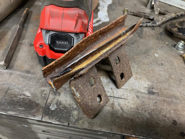

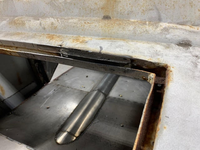

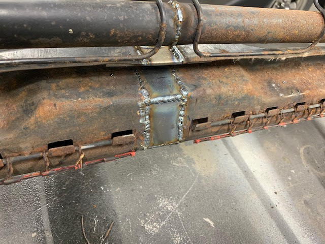

    The trunk lid hinge mount area was swollen with rust, so it had to go.
    Made a new channel and welded the hinge plate to the backside.

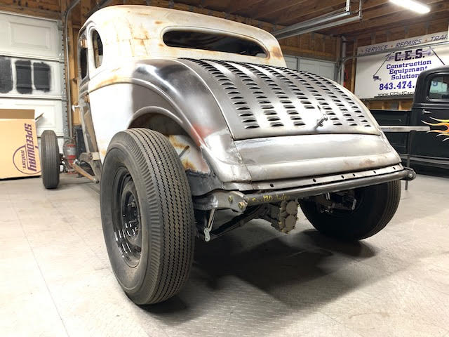

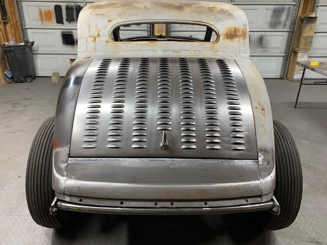

    Tack the trunk in place and make the hinge stuff fit around it. The bottom panel was a bit too tall, so it got cut off.
    Holy ****, it fits. Trimmed 3/16 off the top of the taillight panel.
    Here is the mostly finished product.

    Man that deck lid looks ***s!

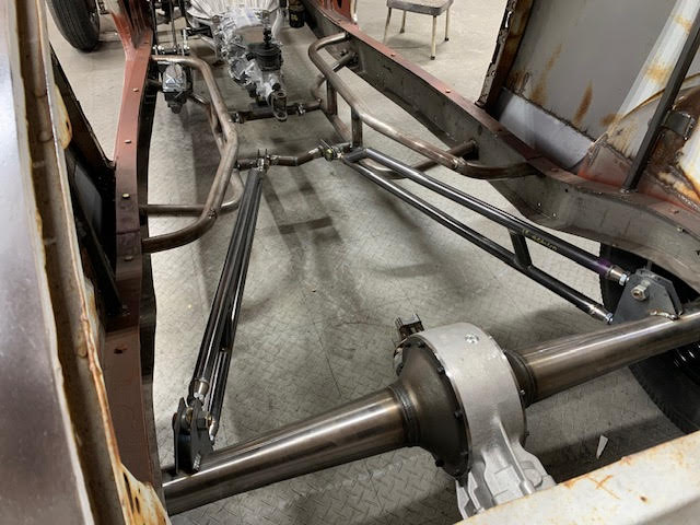

  9. Loving this build, I like the way you have mounted the ladder bar brackets high up on the diff housings so the bars don’t hang low at the rear.

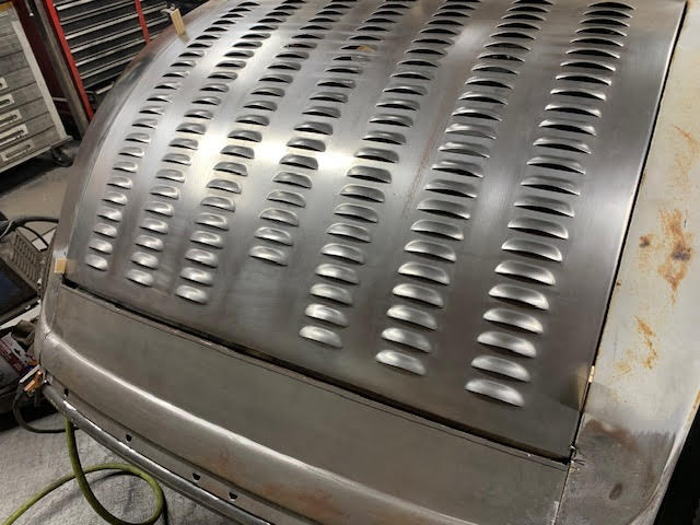

    Now for the dreaded 4 piece hood installation. Love an OG hod, but they are a pain in the balls to install. My good buddy @lo c dan up in Lexington jammed the top full of louvers. He did a fantastic job and is a super cool fella. He might even do some for you if you ask him real nice.
    Dan does great work, his louvers are straight and everything.
    And to my surprise, the hood pretty much fits.
