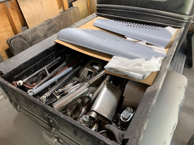

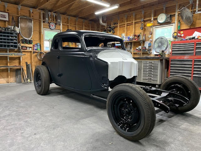

    So, this one single picture has been my last month or so. Still have to block sand the primer, but all the heavy lifting is done. Body work ****s, I hate it.
    On a brighter note, the chrome showed up. This car is a beater, but I am a ****er for chrome window frames. Now I have these beautiful window frames on kind of a piece of **** car... S and H Chrome, Madison Tennessee.
    Now, the ch***is comes apart for finish welding and paint. The engine is at the machine shop, Ross is almost done with my pistons. My upholstery guy has my seat. The car is completely dis***embled, but it is kind of on the down hill slide, might even have this heap running before the end of summer.
    See ya, -Abone.

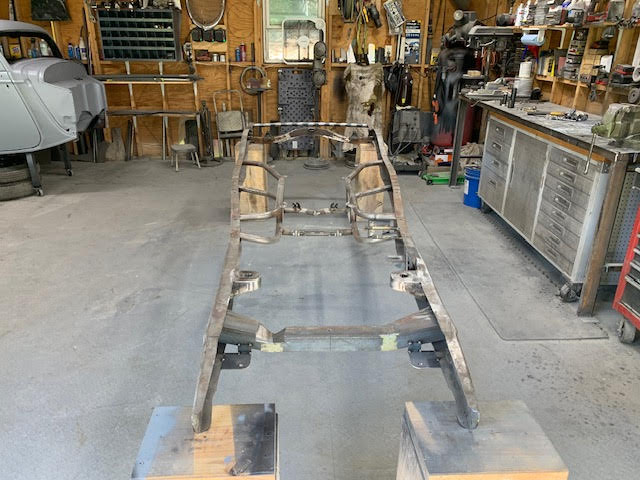

  14. flamedabone
    Joined: Aug 3, 2001
    Posts: 5,760
    flamedabone
    Some have wondered why I didn't box the frame before made the crossmembers. Well, I like to make all my crossmembers and bracketry weld to the inside C channel, then go back and box it so everything is welded to the boxing plate also. Definitely more time consuming and most likely not necessary, but it is the way I like to do it.

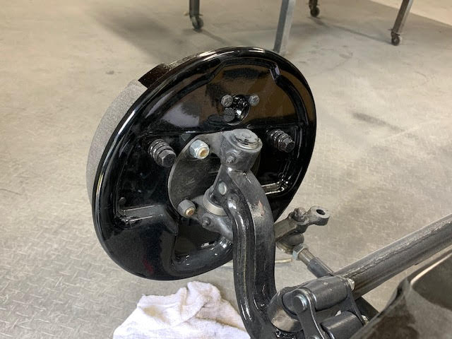

    Brakes are not very exciting.
    Ch***is not very exciting.
    Carburetors are kind of exciting. Charlie Price hooked me up.
    If all goes well, I should be painting the body this weekend.
    See ya, -Abone.

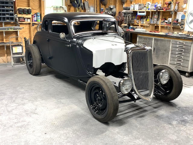

    Fresh report from the famous FlamedAbone Color Application Studio. The car is finally a color. Its...its...
    Dark grey primer.
    Its not black, I swear. It will flatten out a bit as it dries and it is very grey in better light.

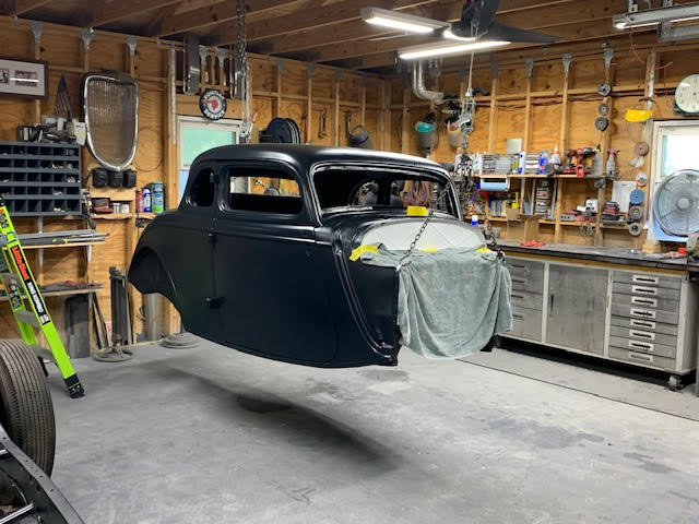

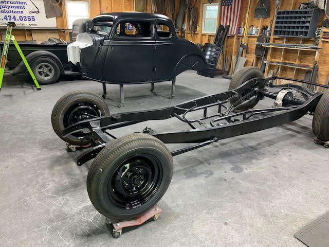

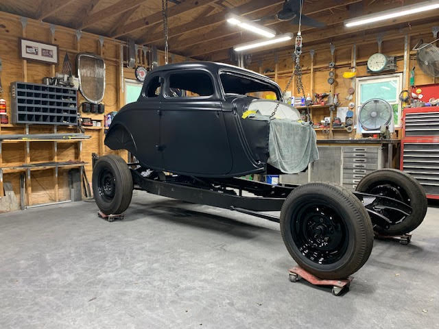

    Now to start sticking this little car back together.
    Danger is my business.
    Almost there....
    And, down. I have only dropped one '34 Ford in my time, didn't want to do it again.
    Decklid still fits.
    Here she sits, still in piston jail. I have some more busy work to do but this whole piston thing is kinda holding up progress.
    See ya, -Abone.

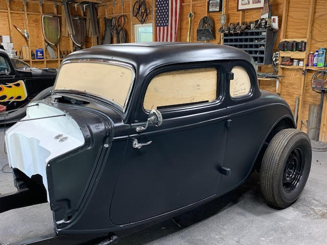

    After a long list of mother f-ing window regulators, the gl*** templates are done. Not only do they roll down...
    They also roll back up.
    Here is the whole set, ready for the gl*** dude.
    And, I finally got the roof insert finished.
