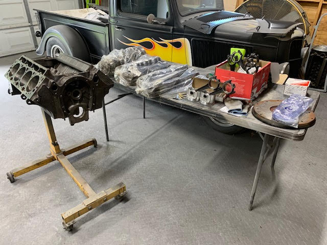

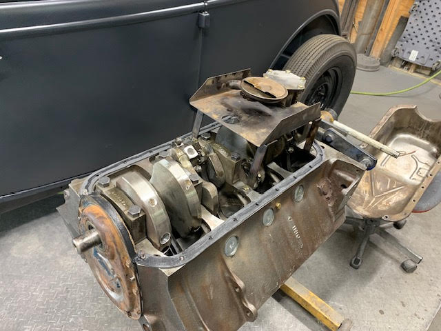

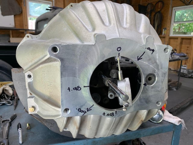

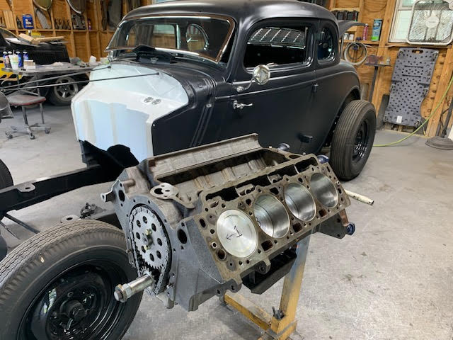

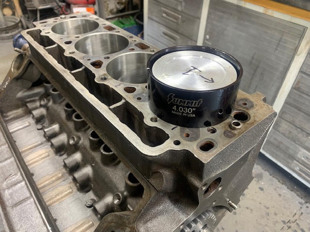

    FINALLY!!! got out of piston and machine shop jail.
    Crank is in, good time to dial in the bellhousing alignment.
    We are pretty********** traditionalists up in here, but this is one piece of billet aluminum I will NEVER build an engine without. The first time I used one of these, I threw my old school ring compressor that I have had since 1986 right in the trash.
    Kind of an odd windage get up, but it works.
    And there you go, 1962 Cadillac 390 short block
    all together. Mild cam, 9.5 pistons, rock stock other than that.
    Tune in next time, this*****er ought to be sitting in the car.

    Root is correct. Auto Tec will make whatever you need in a lightweight modern style forged piston. The 390 is a 4 inch bore, so I think it is a fairly common blank. The factory compression ratio is about 10 or 10.5, mine are a little more pump gas friendly, 9.5.
    -Abone.
