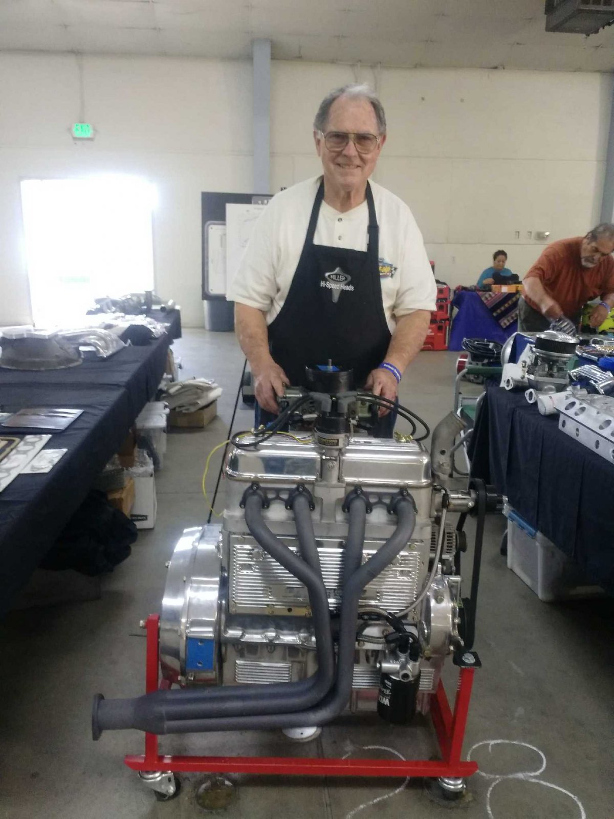

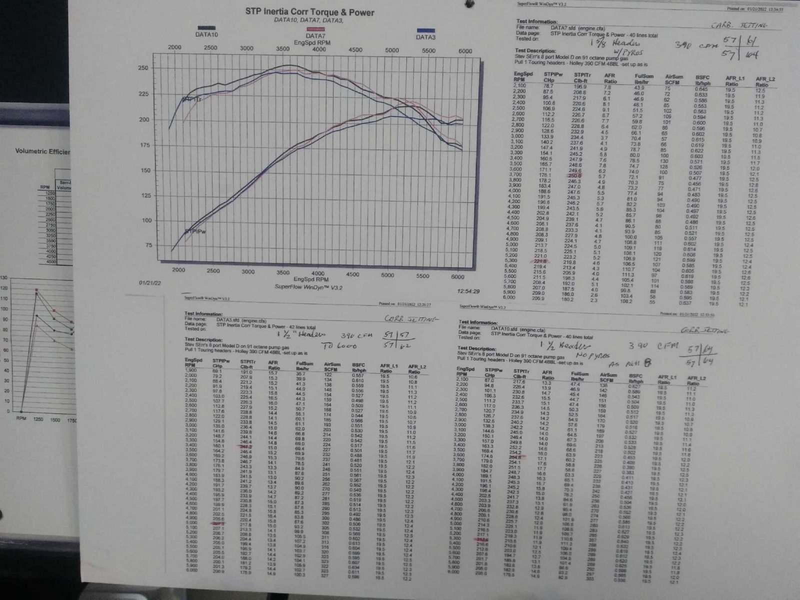

    DONOVAN D: 2022
    Over 200HP….mild build for longevity!
    Dyno sheet attached.
    Experimental 8 port OHV by :Steve Serr 6E134A36-95AC-4121-B74C-08992647D90E.jpeg 238DC3CA-85ED-4262-89B4-847F2B4457D7.jpeg
