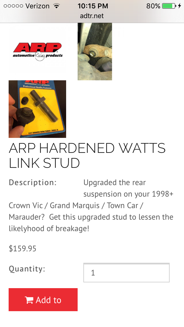

  27. Most everything is built or speced out at bare minimum requirements. That is because only a few people are willing to go beyond bare minimum.
    Folks drive 5 miles out of the way to save $1.00 on tank of gas, they will drive 15 miles to save $2.00. They do the bare minimum on their jobs, ride around on overdue repairs, they also don't want to get ****d on bolts and hardware.
    Example - seems kinda high, $2.00 for 10 pieces. 20 mins earlier Napa sold my buddies wife 6 connectors exactly like these for $12.00 @ $2.00 each.
    ARP stepped up to redesign a FORD bolt/stud because they break. Costs you $159.00. Ford sells them for $27.00 each ****TT,,, they are special order and come in 4 packs and you need to buy the whole pac. Costs you $108 to get the one you need/ That is exactly like the one that broke off flush in the differential. Ever have one of these let loose? Car dives like a forklift with busted pitman arm.

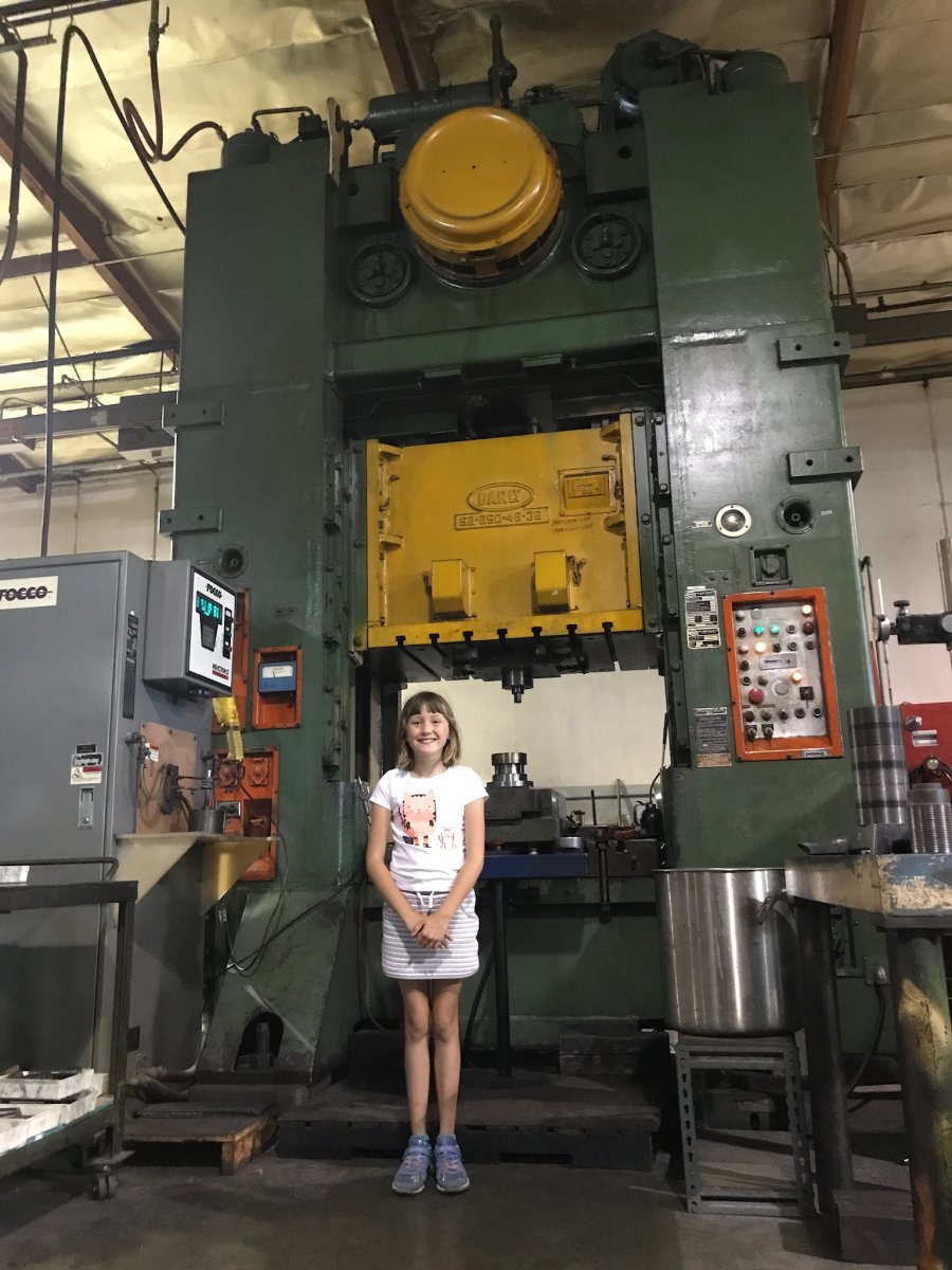

    View attachment 3530206 IMG_7928.JPG Doesn't everybody have access to a Danly 250 ton press to make their own bolts?
    We still make bolts here, this is the start of the bolts for the fuel tanks on the Space X rocket.. Inconel. Good stuff.
