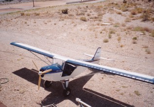

  18. nmpontiac
    Joined: Apr 24, 2007
    Posts: 1,235
    nmpontiac
    from Taos, NM
    I built myself an airplane a few years back, and found that you tend to be very careful with hardware selections when you're going to be putting along at 10,000 feet in something you built yourself.................. kitfox 2.jpg
