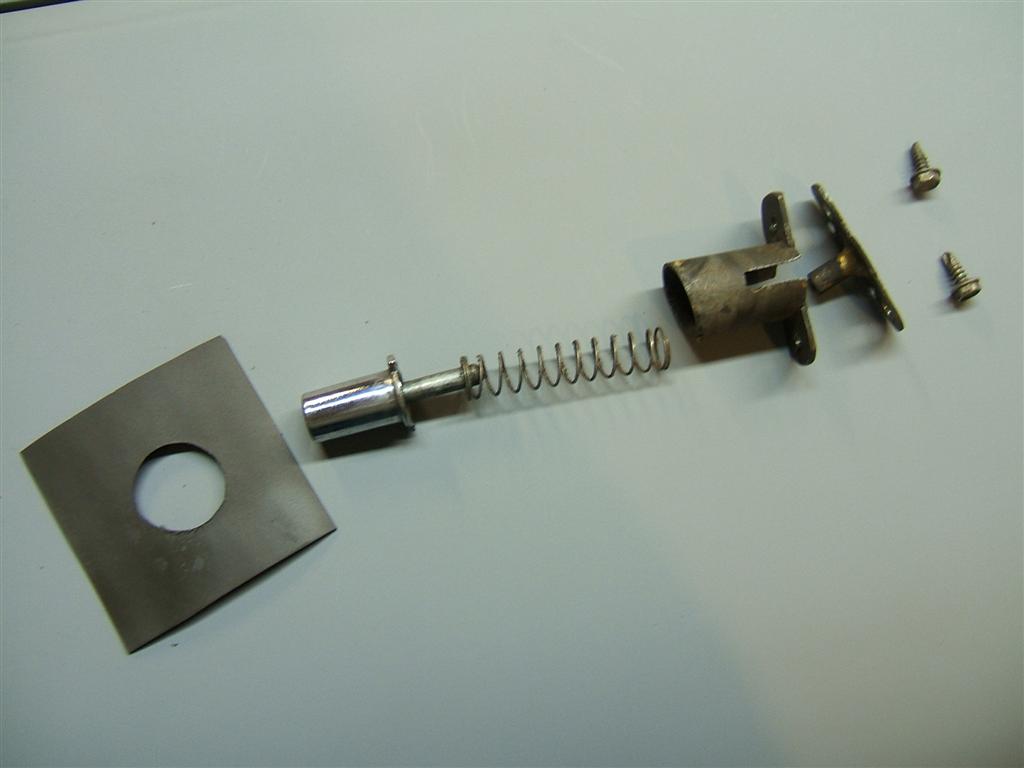

    Here's how I reworked 65 Mustang buttons to work.
    TWOCHOPS
