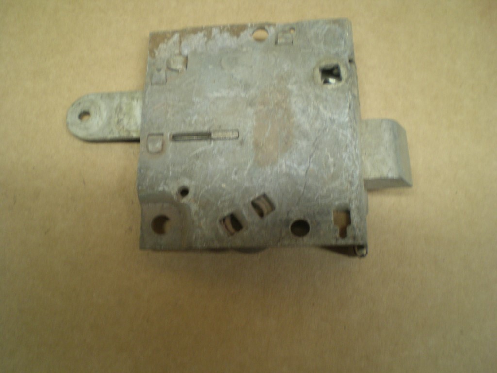

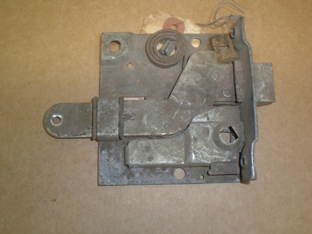

    Looking for any information on if anyone makes repo door latch like this. It's from a '49 international kb but looks like what I find pics of '40ish Ford cars. Haven't been able to find any. Thanks, Bill 20230912_165535.jpg 20230912_165527.jpg

    International used a latch made by Ford for late 30s early 40s cars. I was just hoping someone might recognize what it was used on .

    Took apart and completely wore out. Have seen some on the net that matches but no precise year.

    From what I find it is close to F1 door latch. There are some on the bay that are exactly like it but hate to buy another wore out one. Thinking about getting new repo F1 latch to try.

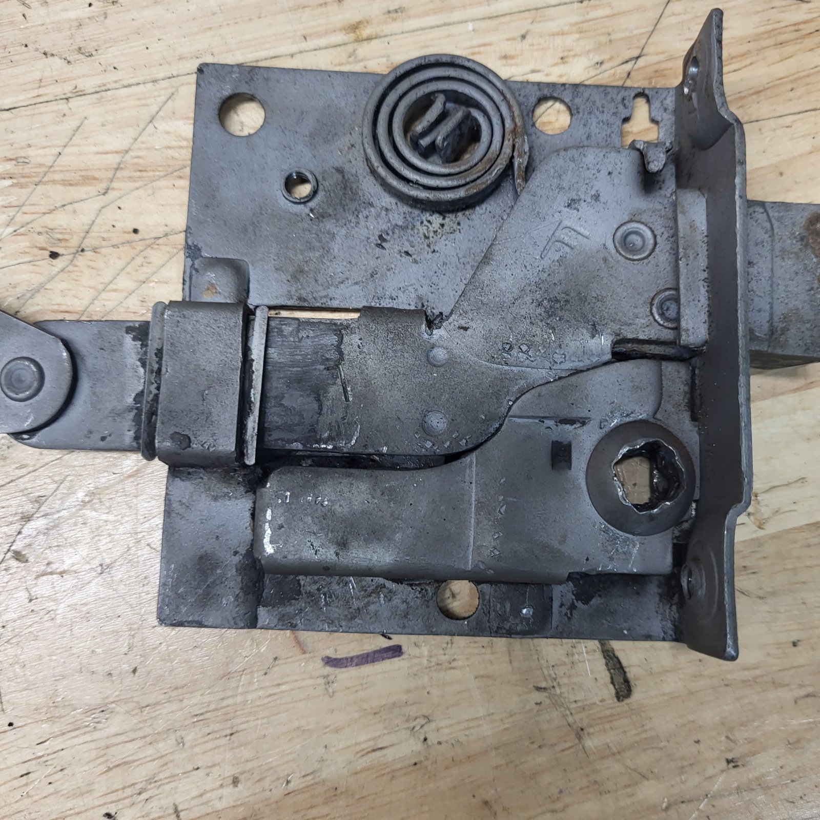

    Here's a couple pictures of a '35-'36 LH door latch for comparison. Early '37 would be the same except it would be flat instead of having the recessed mounting hole.

    Bingo! That's what I was needing to know. Thanks. Now to find one.

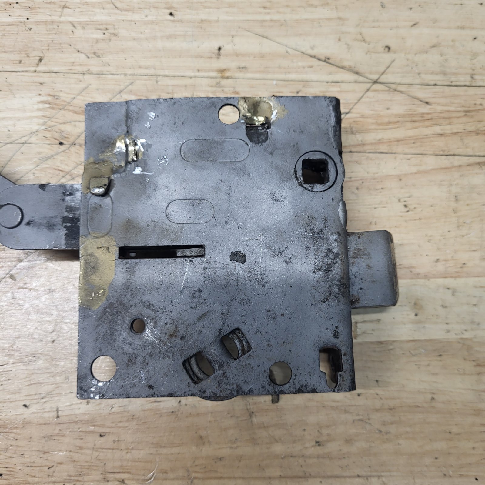

    Ok. I got brave and took latch back apart. After a good cleaning found some wear on one part and another that looked slightly bent. Did a little welding,grinding and straighting and seems to be working again. Thanks again.

    Just finished installing back in door and working great.
