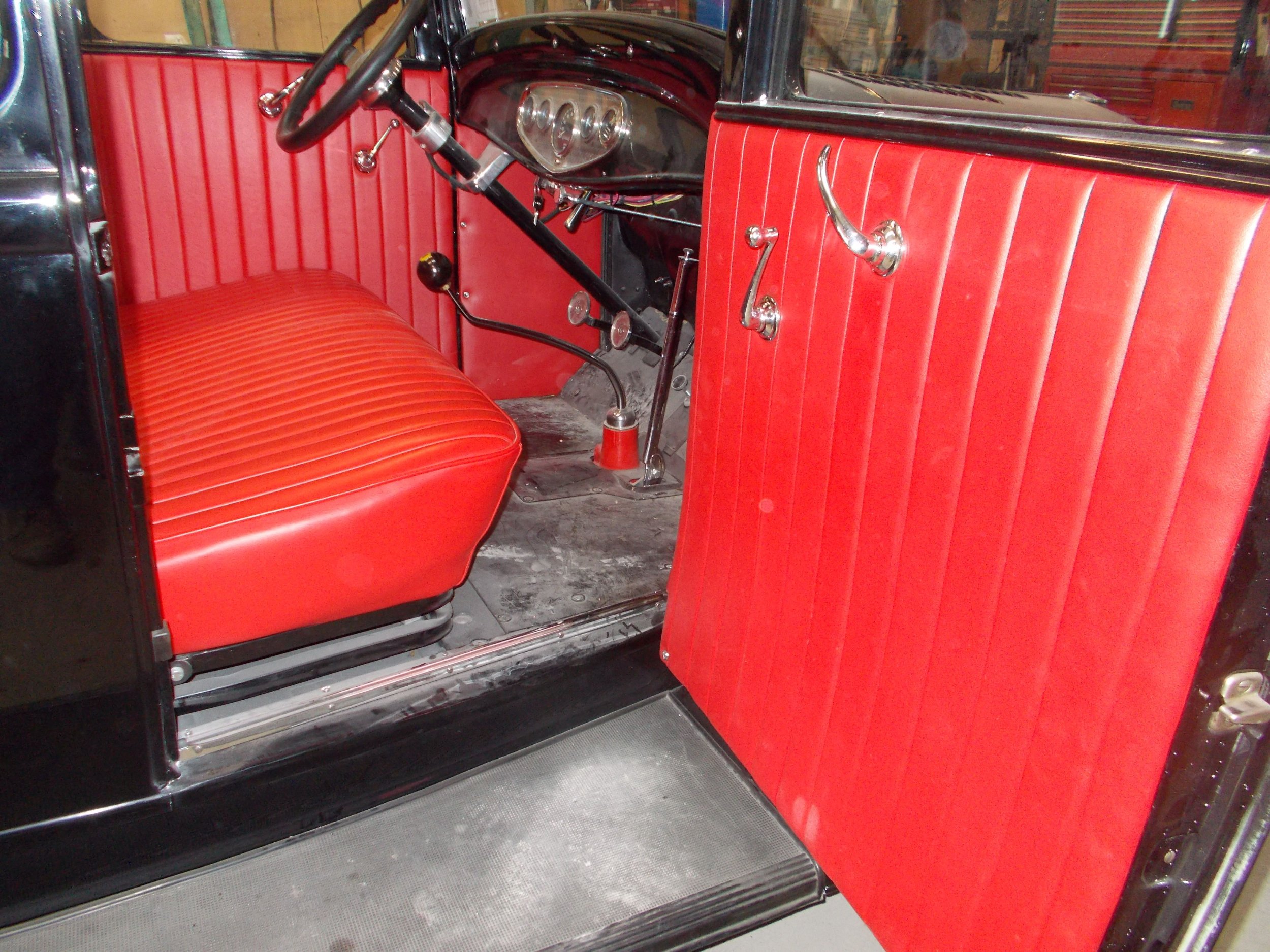

    I have this style door panel clips from the upholstery removed from my 1932 Ford.
    I made new panels and had them done in R&P. Now the original clips don't fit over the thicker panel. There are many wire clip options available by application, but panel thickness is not provided. Anyone got any help?

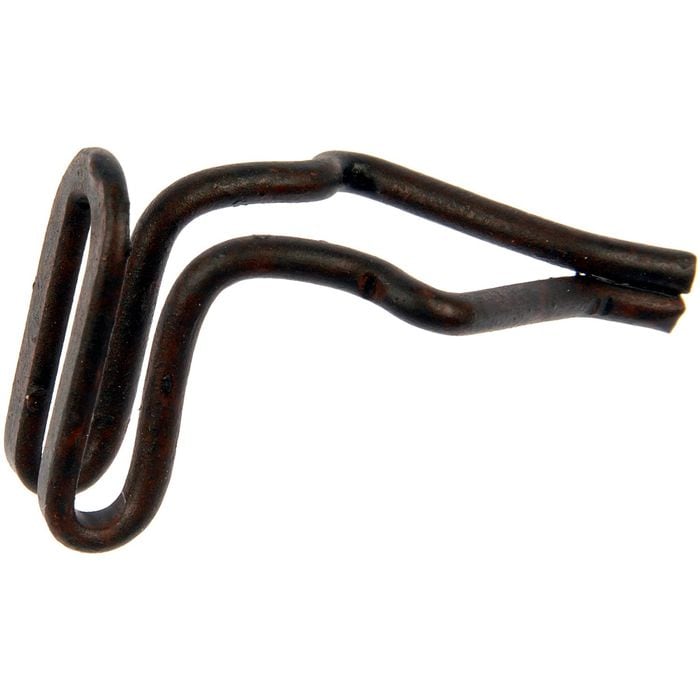

    Found them. Thanks for all the help. Ron
    Trim Clip Fasteners Auveco 2310 For the .125 Chrysler Dodge Plymouth Thicker Panel

  20. seabeecmc
    Joined: Jan 28, 2005
    Posts: 1,287
    seabeecmc
    Got it. Ron doose4.jpg doose5.jpg Trim Clip Fasteners Auveco 2310 For the .125 Chrysler Dodge Plymouth Thicker Panel

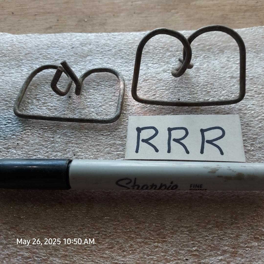

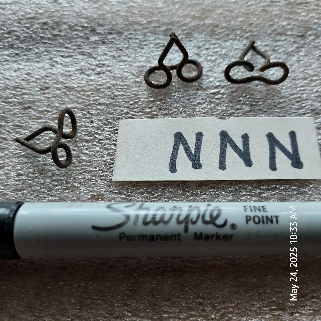

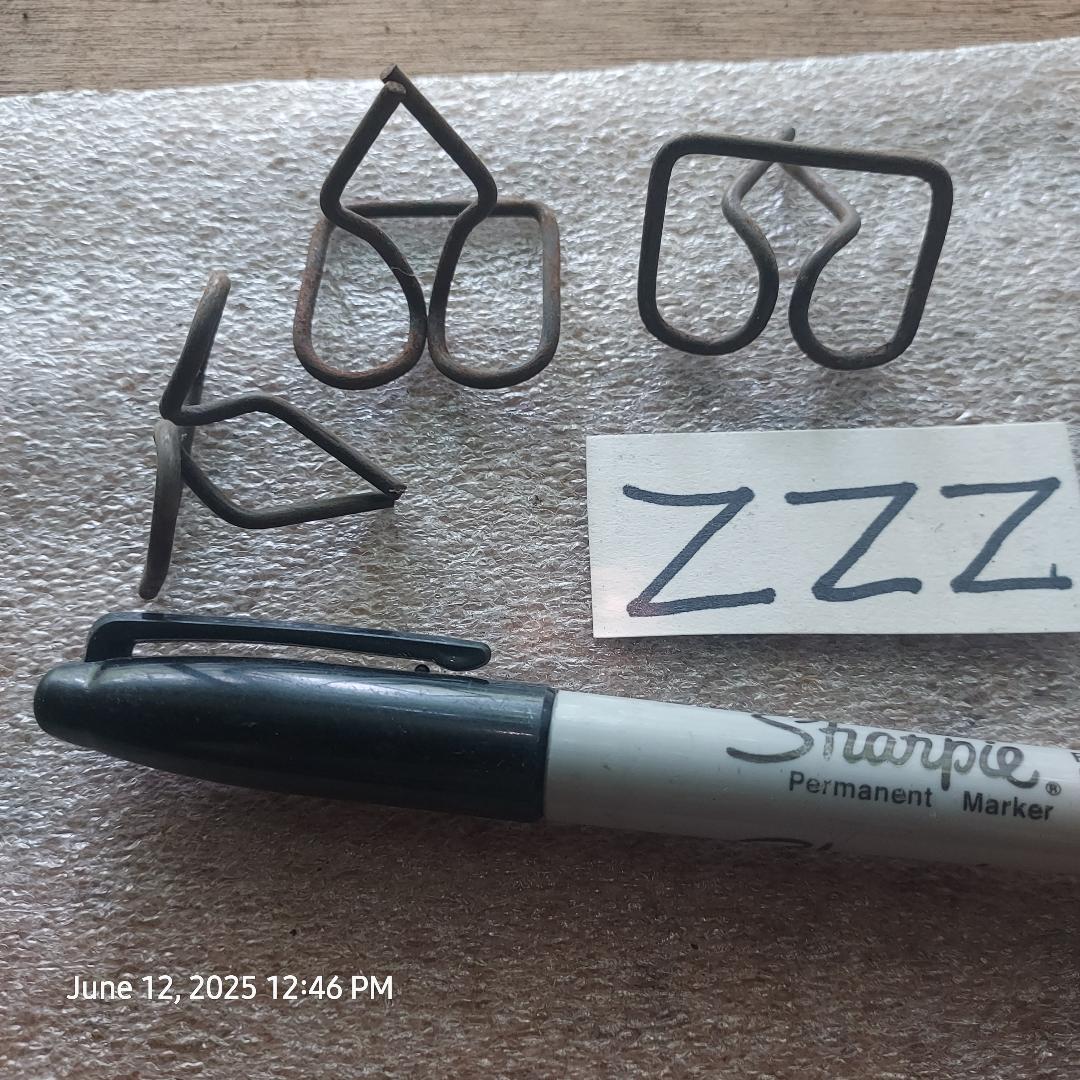

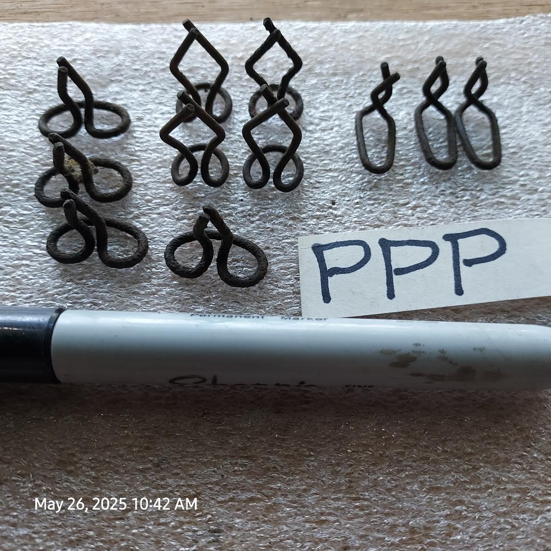

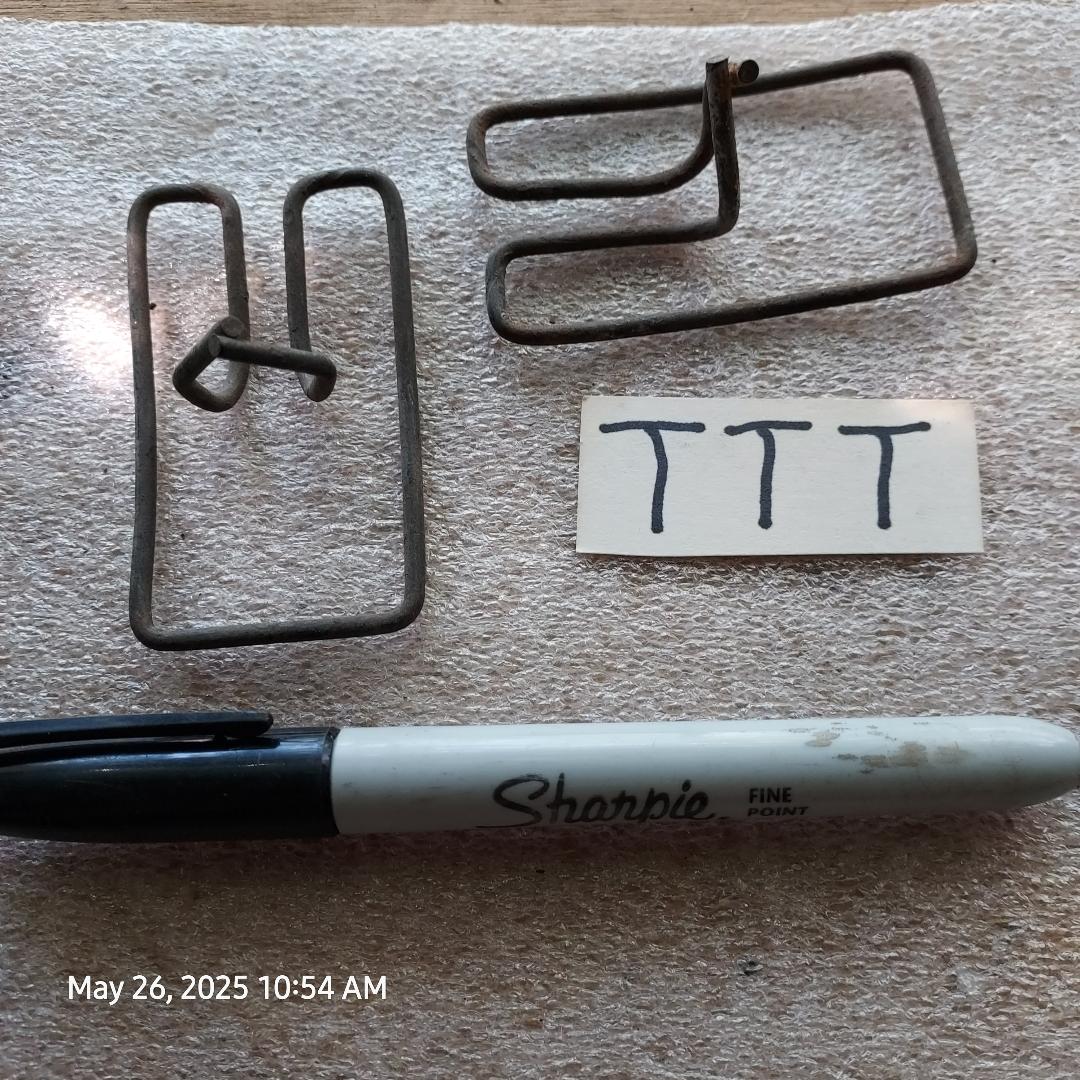

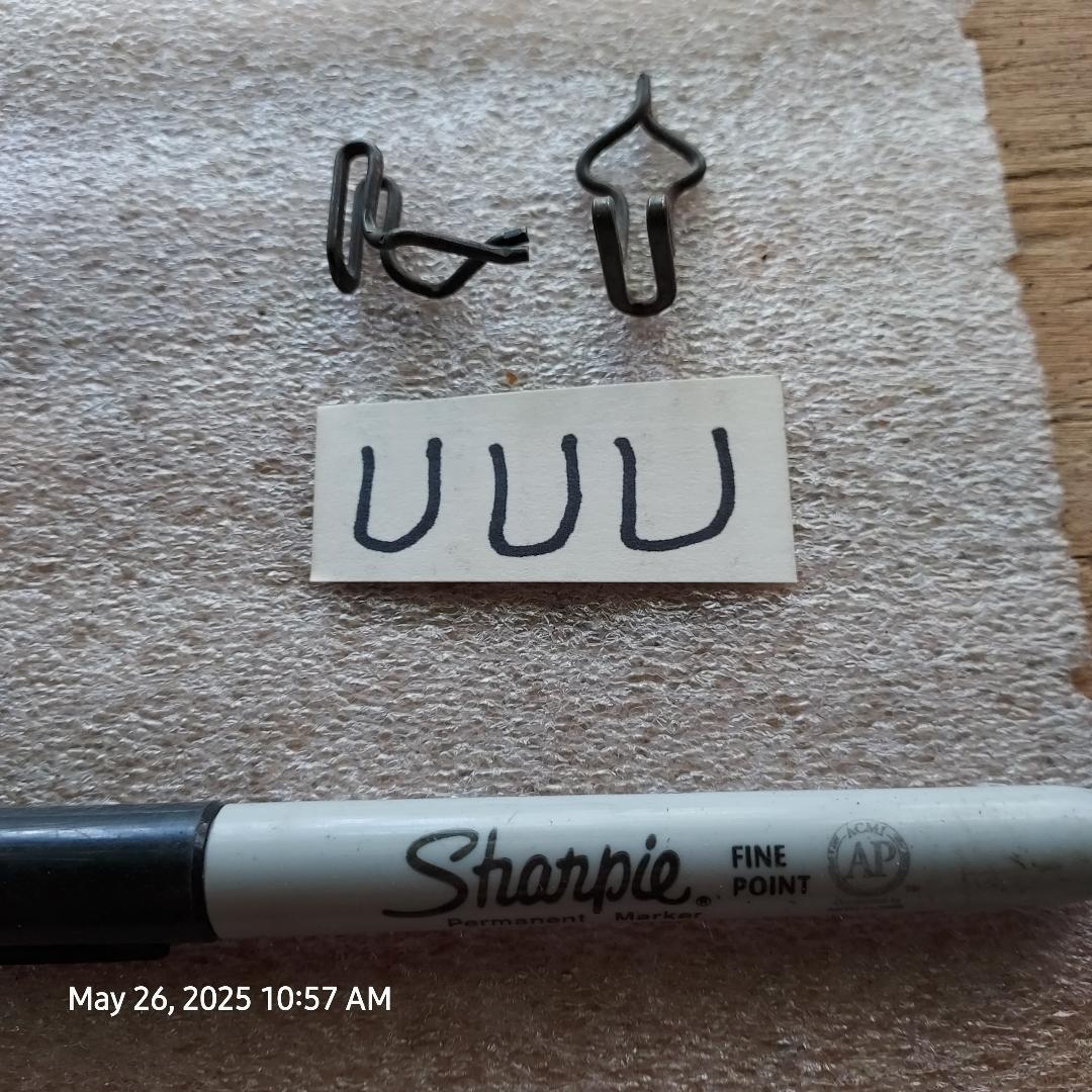

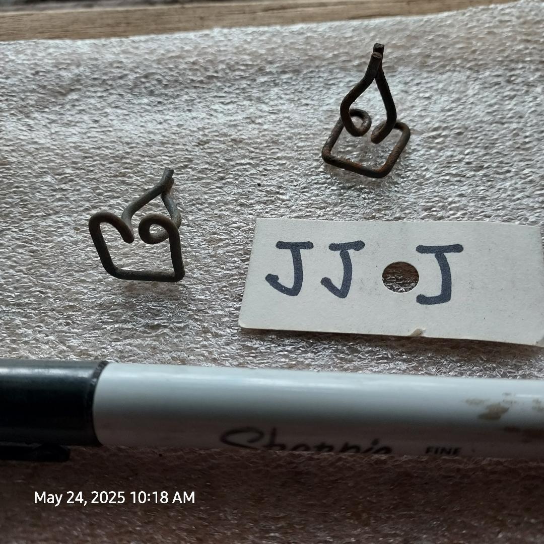

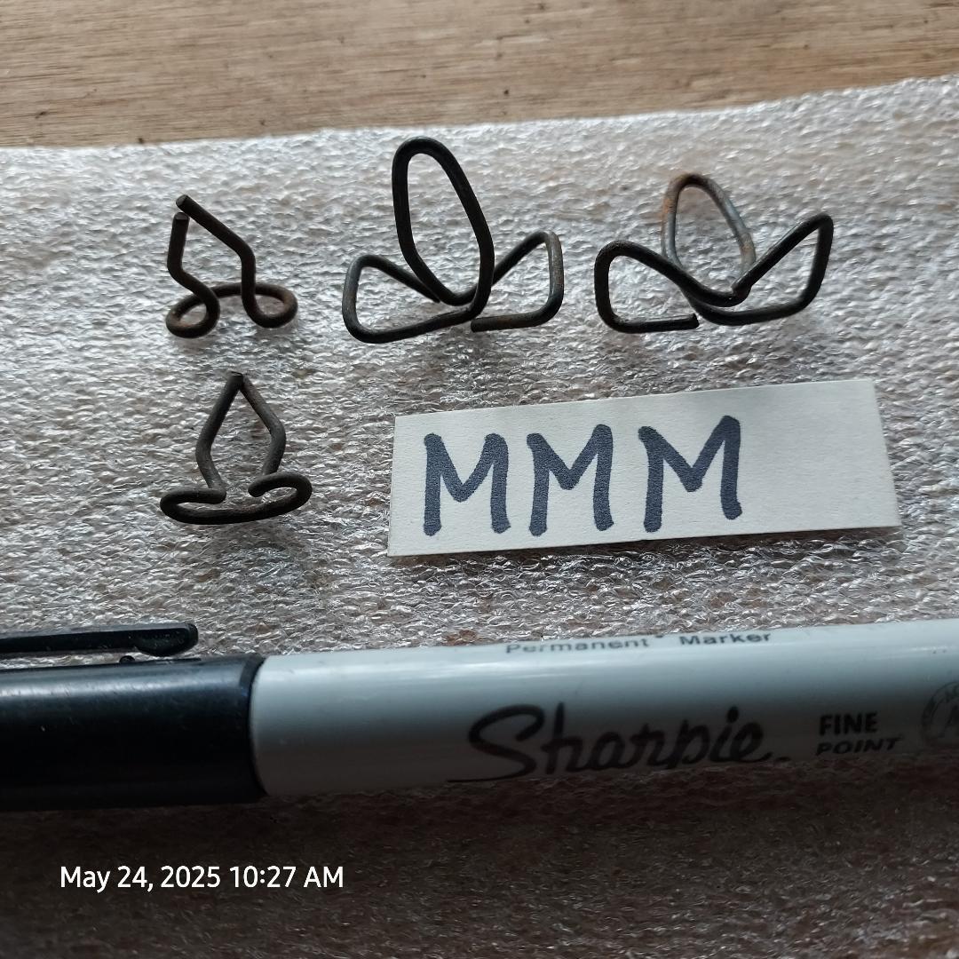

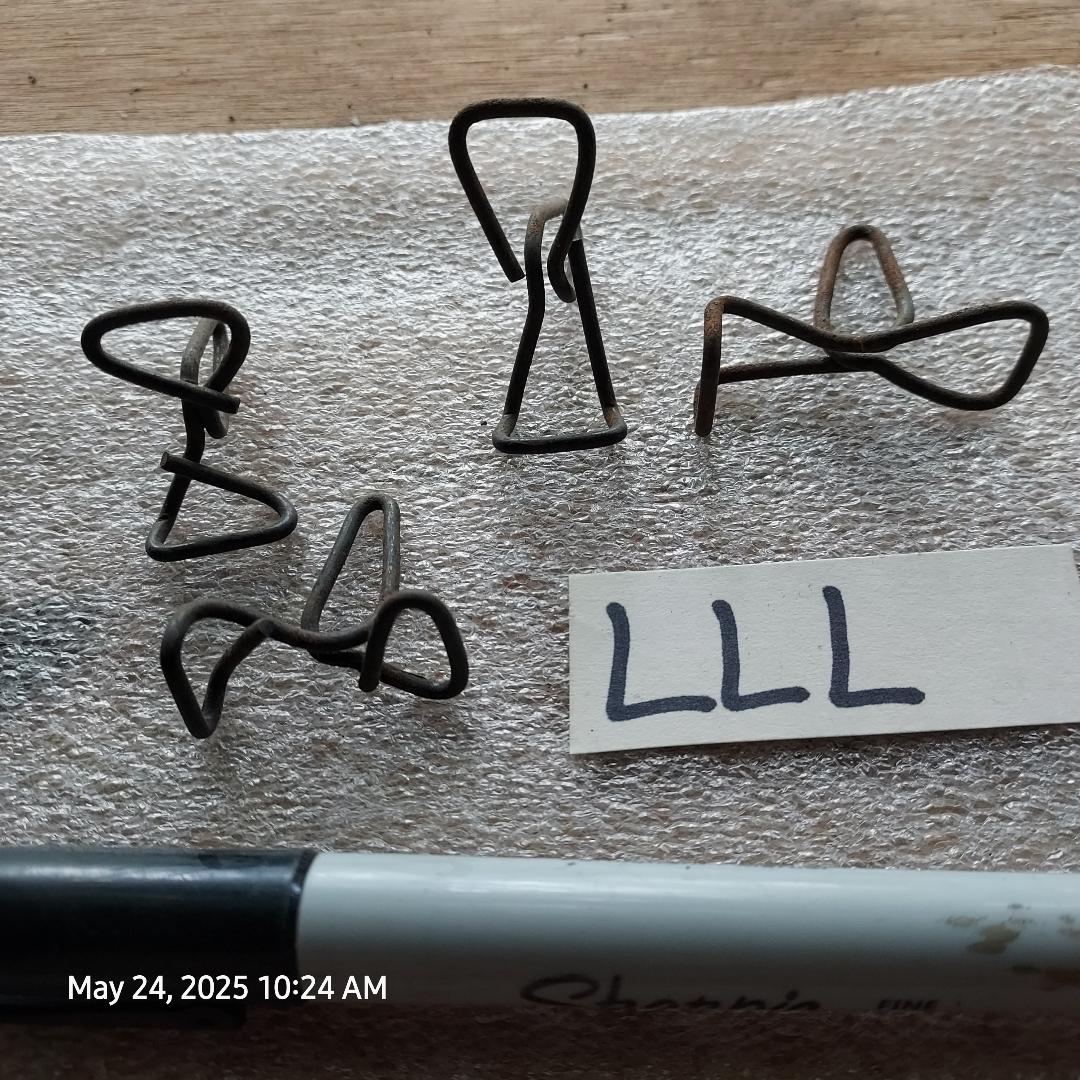

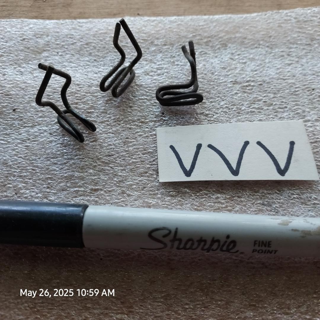

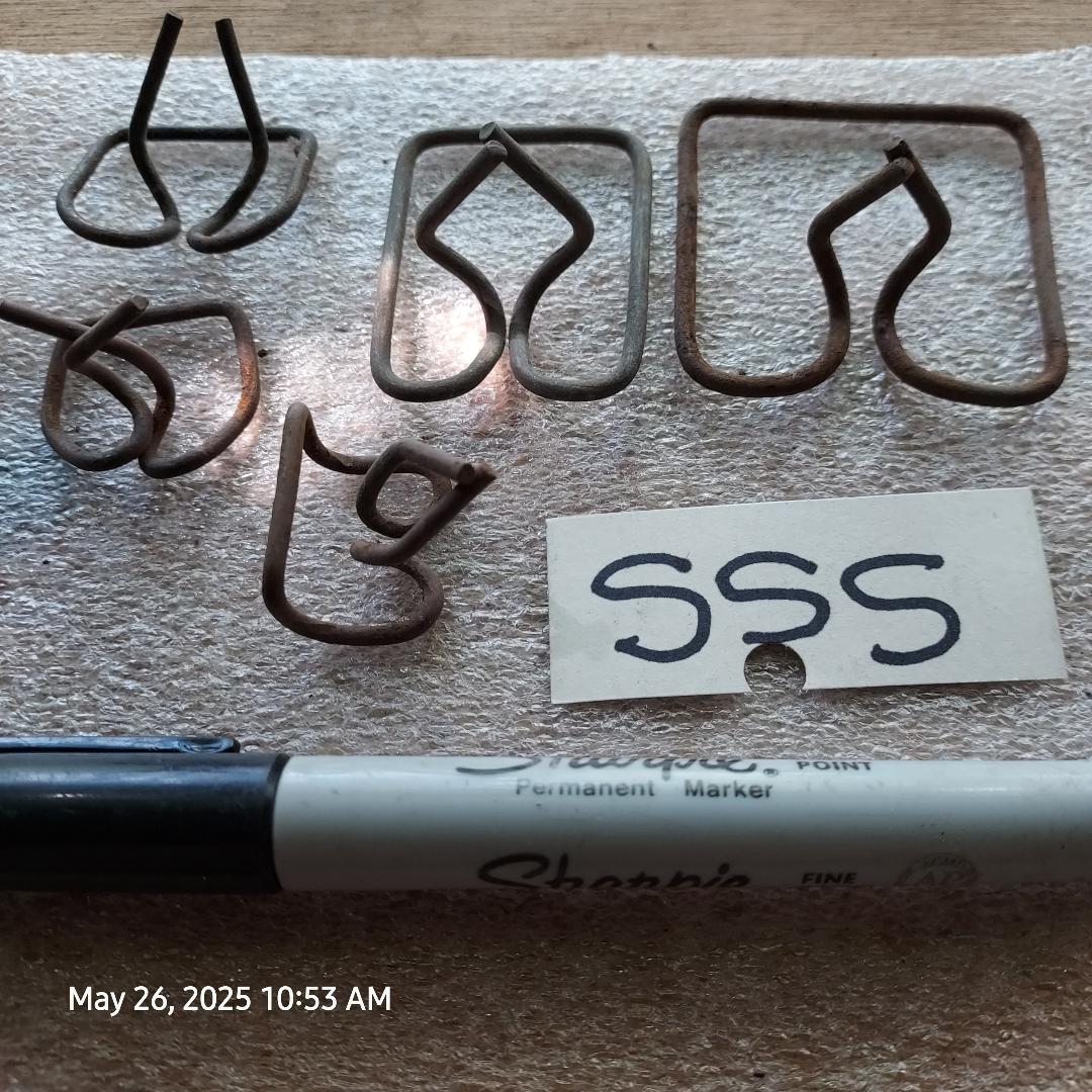

    maybe some of these might help? TCHHH.jpg TCIII.jpg TCJJJ.jpg TCLLL.jpg TCMMM.jpg TCNNN.jpg TCOOO.jpg TCPPP.jpg TCQQQ.jpg TCRRR.jpg TCSSS.jpg TCTTT.jpg TCUUU.jpg TCVVV.jpg TCZZZ.jpg

  23. seabeecmc
    Posts: 1,287
    seabeecmc
    Being tipped to the absolutely correct Auveco 2310 panel clips was the perfect answer to my issue. Thanks All, Ron
