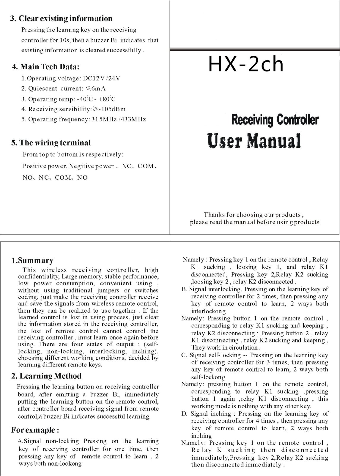

    If you are referring to those cheap "Fleabay" type remote relays. They have a generic setting from the factory that can do a "Max Headroom" [and do crazy things]
    Clear the codes then Re-set the remote to the relay and these problems go away [the same as introducing another remote]
    I had a winch remote go "random" on me [luckily It had a battery cut-off]
    And all the 12v DIY hidden sound systems in my house had them [they would randomly switch on in the middle of the night]
    I also use a 2 channel remote relay with my 2 garage doors [off a 2 ****on remote]
    Since clearing the codes and re-setting them I have never had an issue with any.
    Edit : you need to set them to single ****on "momentary" [like a garage door opener]
    Attached is instructions on how to set them [they seem to be universal]
