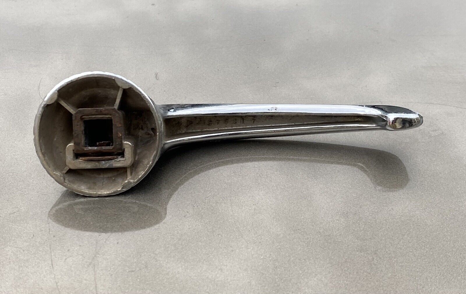

    This is what the back side of the handle looks like. That clip is not meant to be removed from the handle itself. You need a tool to push the clip over to line up with the square hole in the handle, then it'll slide off of the shaft. They made a special pliers for it but anything solid you can get behind the handle can push it over. I use one of those L-shaped bars that are used for locking a garage door, it's got a built-in handle and can be slid in flush with the door panel, works well.
    The rag trick does not work on this kind of handle, it's a totally different system.
