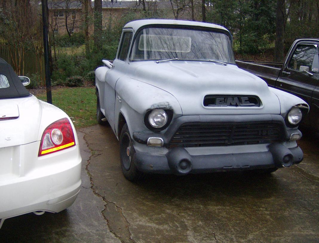

    This should be painfully obvious, but I can't seem to find the cause to this.
    When I open the doors on this pickup, they fly open a foot or so. To close the doors, you really have to slam it in order to get past whatever's binding.
    Once closed, the doors line up fairly well. The body lines look good and it sits well in the opening.
    I can't find any rub marks on the doors themselves, or the A pillars, or the rocker areas. There's nothing that's obviously binding with metal on metal.
    The door hinges don't appear to have any slop in them.
    I'm not looking to restore this. She's a bone stock 50 year old work truck that I want to run around town going to Home Depot or to the dump with.
    Is this common and possibly a door hinge issue or something else that I'm missing?
