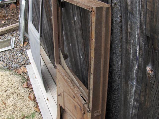

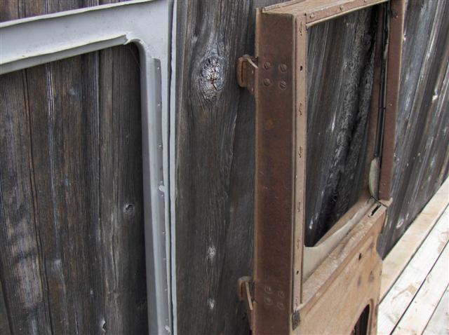

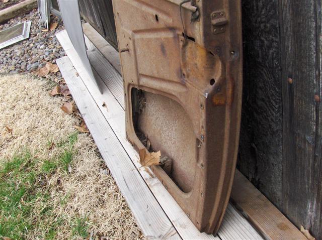

    Here are some pics of two small doors, one with the steel inner structure 24-25 and one of a wood 23 down. The front hinge structure on the metal door is the same as the 26-27 doors as far as i can remember, i don't have a 26-27 door here to measure. All the wood structure doors i seem to find are very nice, maybe because the wood rots out quickly and doesen't hold water, this one is chromeable lol. The smaller doors don't seem to fetch as much cash as maybe people don't want to go through the trouble to widen them but this can't be anymore work than replacing the bottom half on the correct door?

    I see the moulding contour around the window is a little different from the '26-7 doors, but not enough to discourage me. I think it's a great idea.

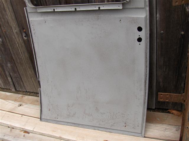

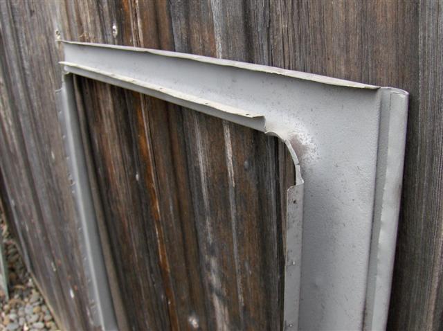

    26-7 T coupe door.

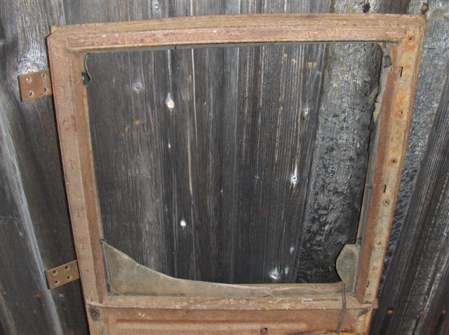

    Here's the pics of my doors that I took today: can someone tell me what year they are?

  16. They have the full metal structure, but look narrow. May be 4-door fronts. I have extra T doors, but I am always pulling in bodies without them, so don't usually sell doors. Same with model A 2-door doors. Another problem with the T coupe doors is they use different hinges on the 26 abd 27. One style is a 3 finger hinge and one isn't. I used to sell T tudor bodies with doors for like $750, but realized the doors were worth more than what I wanted for the whole car. T bodies are still cheap but include the cost of the doors. Pat.

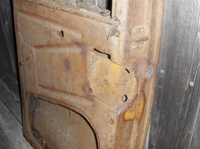

    Here are a couple of more pics of the same door i posted earlier, the door latch was just slightly diferent than the 26-27 t coupe door latch, although it fit and worked perfect on the later door. I was led to believe this was a 24-25 coupe door, and since the latch worked i ***ume it is.
    This doors stampings look different than the one electrodude posted, so his may be off of a for dor? Are all the center door t's doors round at the bottom or do some have square ones?

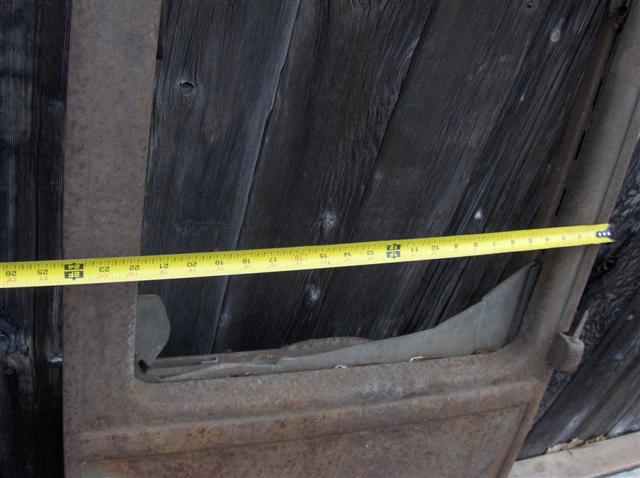

    They measure 20" across the beltline, so yeah, they're pretty narrow. So if they are fordor fronts do they still have value?
    117Harv, the one thing that stands out being different between our doors, besides the width, is that my window regulators seem to be more toward the center of the door, and yours seem farther forward.

    Okay, I'm an idiot...the doors measured 24" across the beltline today, maybe they swelled in this humidity? :p...or it could be that I just grabbed an old log tape I had the other day, looked at it today and had forgotten I had taken 4" off the end when I snapped it once:D
