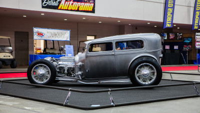

    this is the only image I could find but I can't blow it up large enough to see the detail, it goes all pixilated when I try

    It would seem that there's a drop box of sort's in the kick panel.

    Looks like a conventional box with short pitman linked to a bellcrank short arm with bellcrank long arm in position to work with typical drag link.
    Very interesting, looks like if done right it could be a good solution, but must say it looks a bit busy. Maybe if the upper arm and link were inside it wouldn't look so clunky.

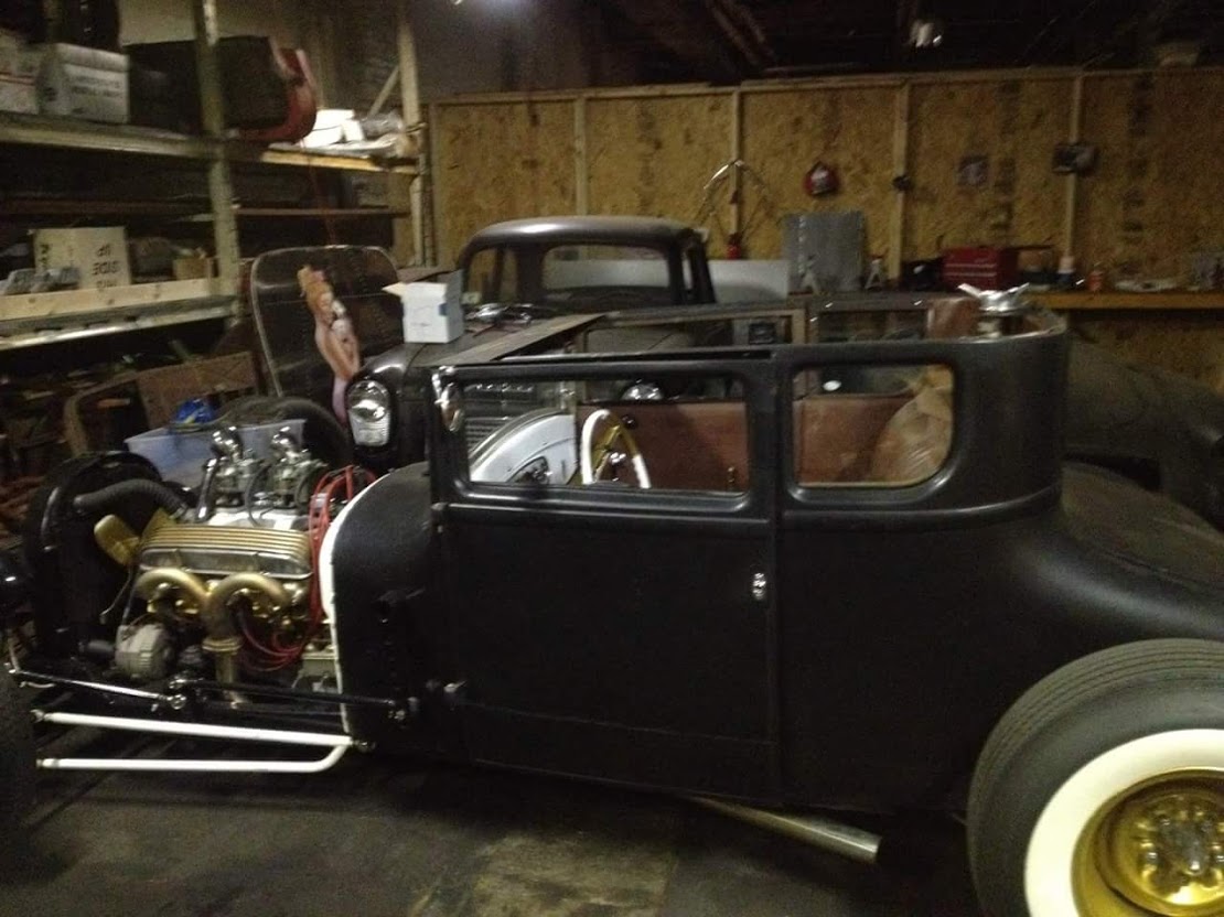

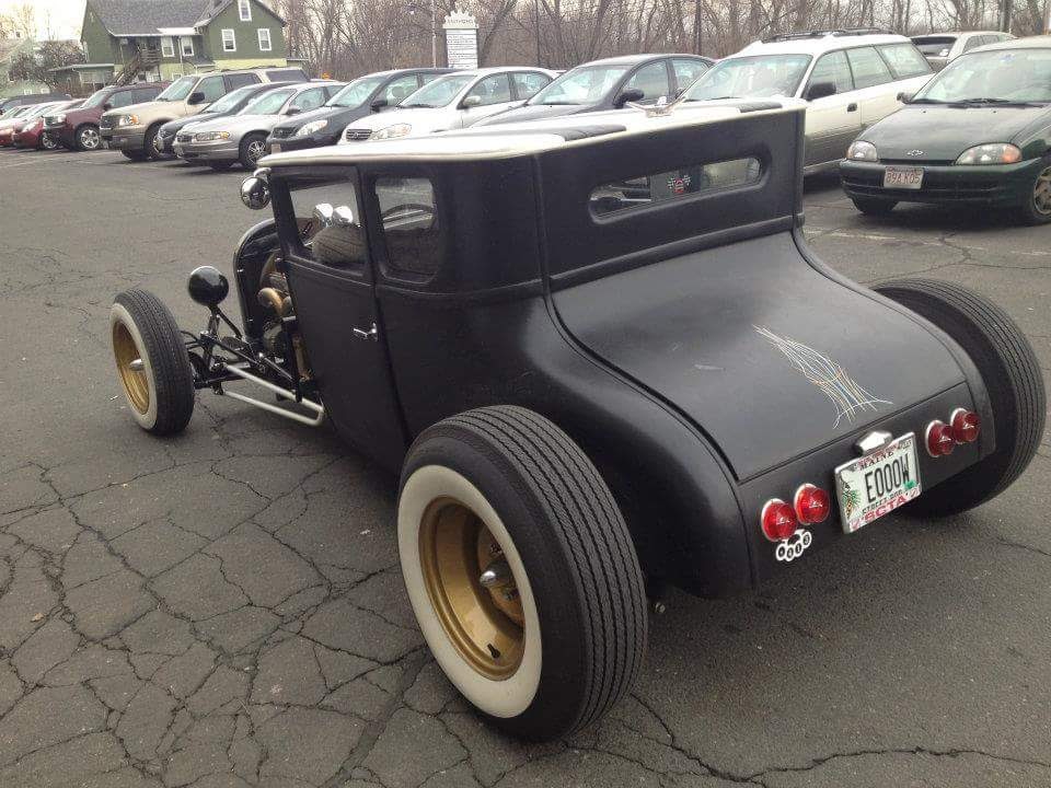

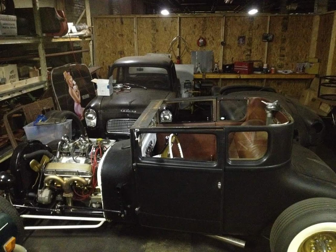

    I believe it was pretty common on old sprint cars or modifieds. I ran it my old cowl steered T coupe and it was slick. I'll see if I have pictures.
    It was a frame mounted idler arm that had a drag link from the cowl mounted pitman arm, and another from the idler to the steering hoop on the spindle. Similar to the A sedan pictured, but both drag links were "horizontal".
    Found some pics.

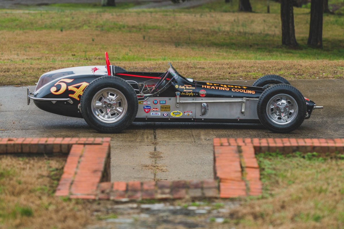

  12. I think it could be cleaned up quite a bit like the early sprint car pics that have been posted here recently

    That’s for stability and standard for a long link in the later champ race cars. That car only turned left.
