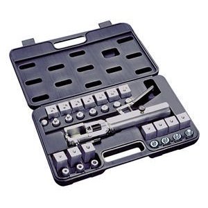

    If all I ever had to flare was brake like I might get by with the hand tool. Did it that way for 20+ years with only the occasional hiccup.
    But the '65 Mustang convertible (that was supposed to be my wife's birthday present two years ago, with luck it'll run this month) has brake lines (3/16 Cunifer, double-flares and -3 JIC), fuel lines (5/16 and 3/8 Cunifer with GM O-ring flares at the filter, JIC for hard-line-to-hard-line connections, push-connects for the hose connections at the engine, and a bead for the clamped hose at the tank/pump), power steering pressure line from the box to the hose (3/8 steel, JIC) and return/cooler lines (3/8 Bundy, JIC and hose-bead.)
    That Mastercool thing did them all (bubble-flare dies and three pumps makes a hose bead) and paid for itself as far as I'm concerned...now I'll just put some better tube benders on the wish list, a tube straightener will have to wait until I figure out how to make one...

    I use the Mastercool Universal Hydraulic Flaring Tool Set
    I've been getting perfect results every time, even on stainless steel lines.
