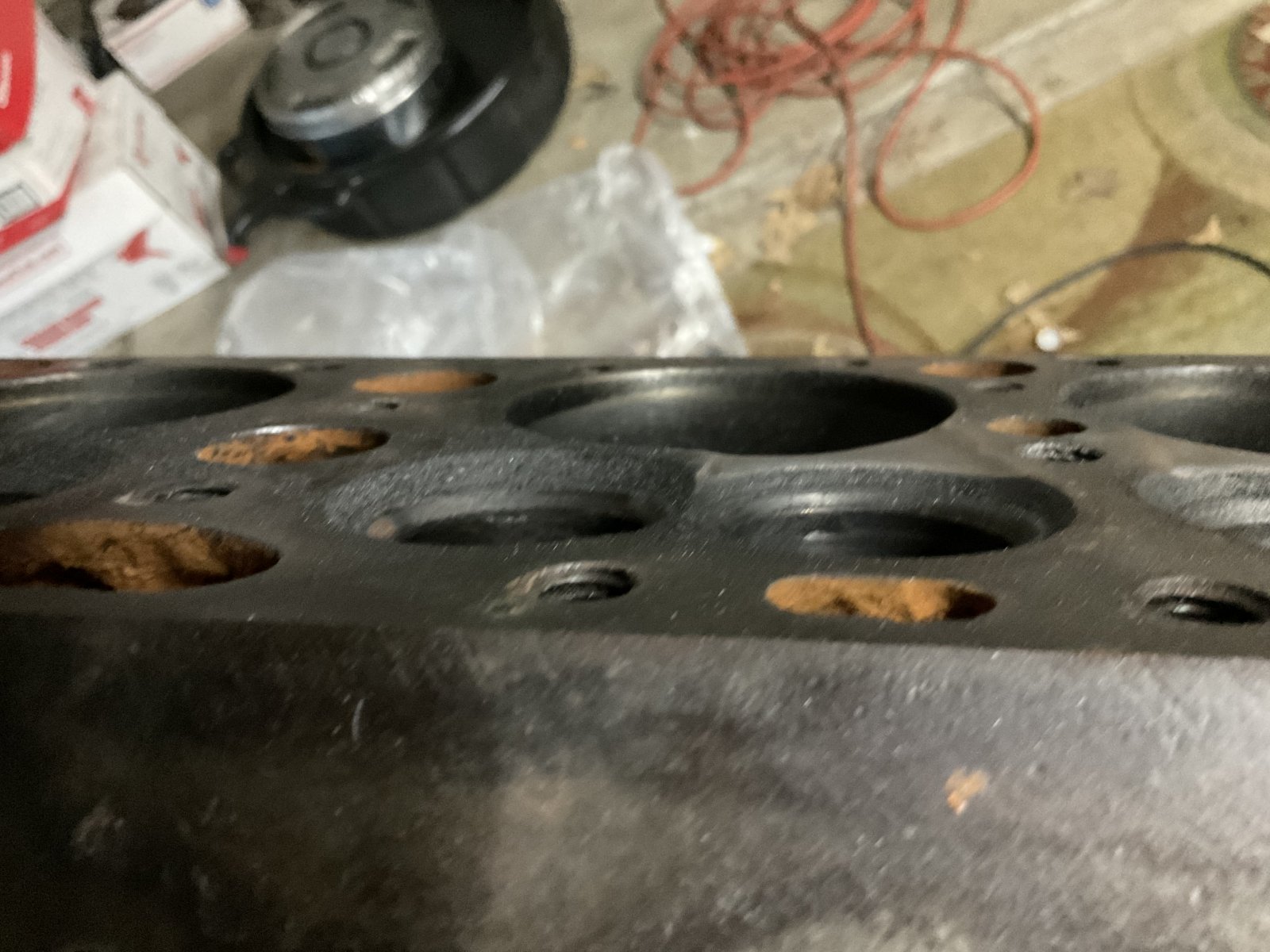

  3. Flatheadjohn47
    Joined: Aug 18, 2012
    Posts: 1,407
    Flatheadjohn47
    from Lewes, DE
    Just built engine found .002 mains and .010 rod bearings. Last tear down was because low oil pressure—the .002 mains brought oil press back up to 60 since down last year. Made drain back vent on p*** frt of pan into a real outside vent that vents to outside. Since this crank is a full floater, it would be a shame to change over to later model inserts and 8BA style rods and discard these costly parts for a 8BA crank and rods. That would be the easy solution, but I am a stubborn 75 year old rodder who will go to moderate means to at least slow down puddle to a few drips. Any suggestions are considered. Thanks John in s.Texas. 9319B6D5-5E04-4EED-A1F5-5116689C8AD3.jpeg 1FD7EF36-C2B4-41FC-B357-1AF628DFA6F1.jpeg 1868ACCE-301C-4E66-8212-090D6EDAA13D.jpeg
    Budget36 likes this.

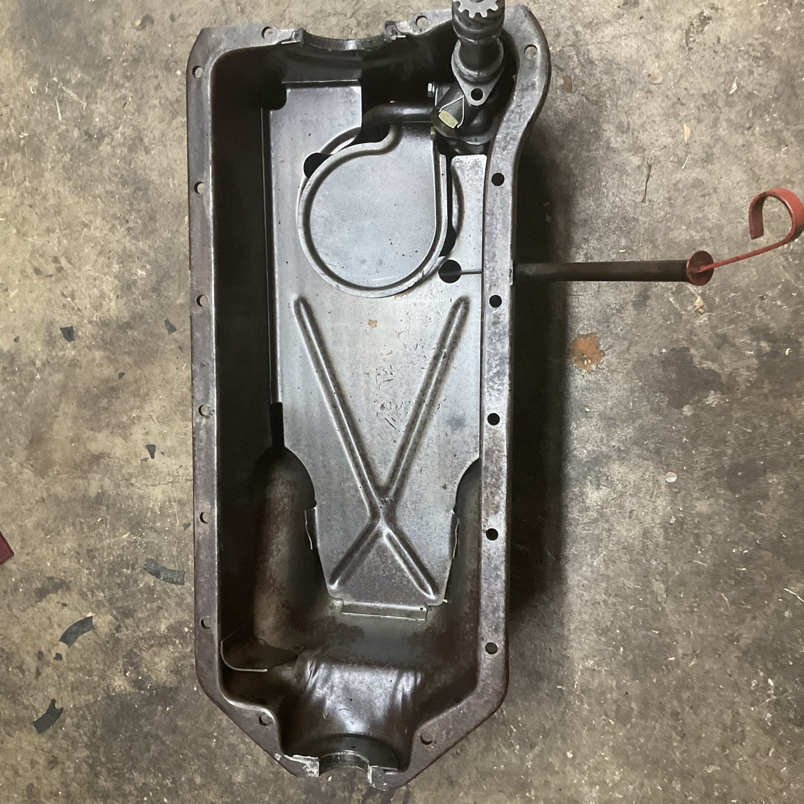

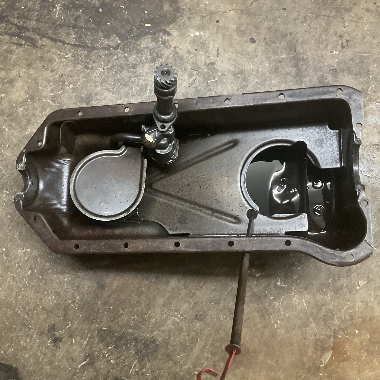

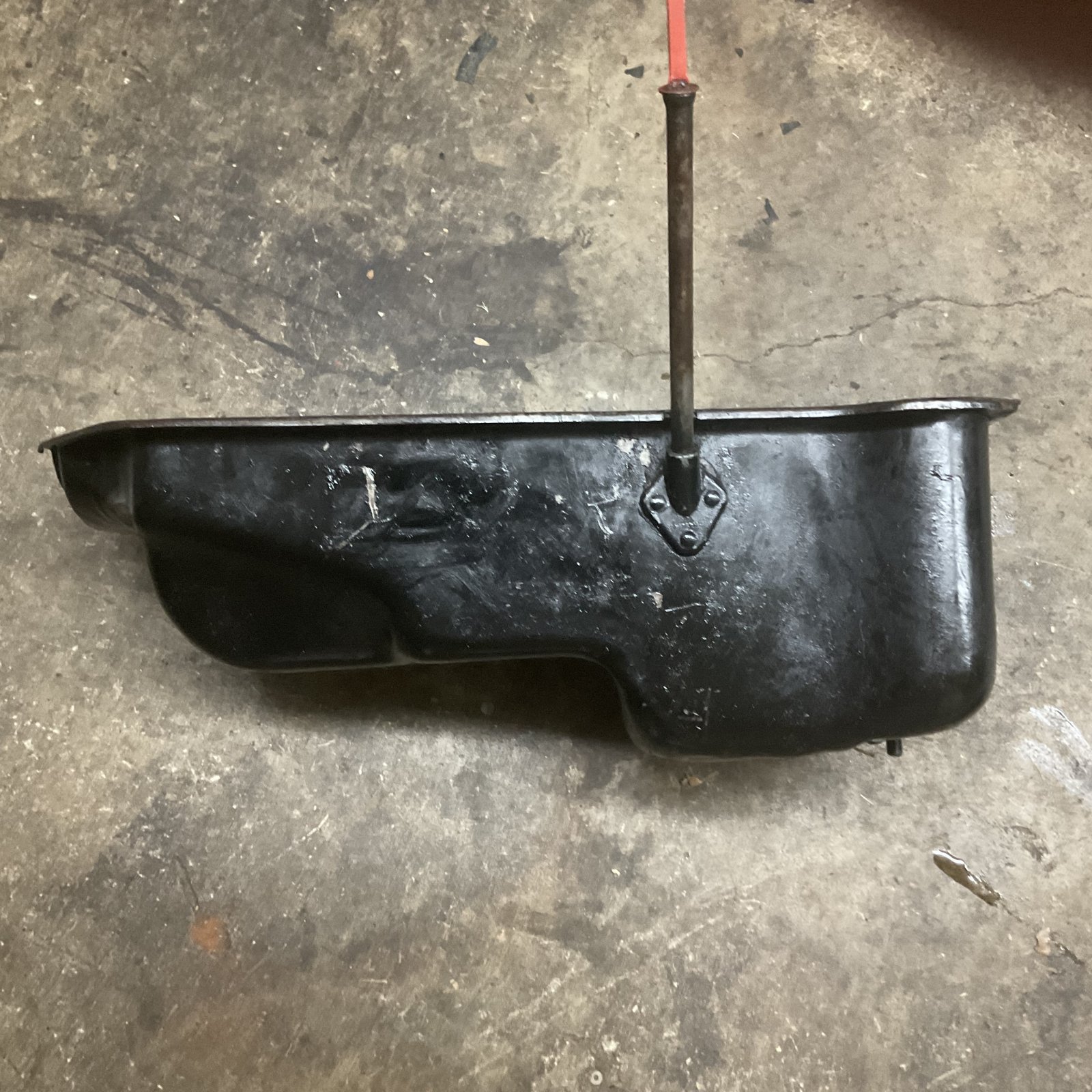

  7. John ,
    Isn’t that an 8CM Mercury pan and pickup ?
    Are you planning on using it,,,,,modified or something ?
    That’s just about the best pan you can get for these old engines .
    Tommy
  8. Flatheadjohn47
    Posts: 1,407
    Flatheadjohn47
    from Lewes, DE
    Yes, that is a factory windage tray pan(49-51 Merc only—not Ford) Chevrolet did NOT have a windage pan(separate “tray” not attached) until the mid 60’s(I think,but could be wrong). Hot Rod Mag conducted a test on a strong “mule “ engine(Chevy) involving windage tray and same engine with no tray and found 8-12 hp(??) difference at nearly 6000 rpm. Yes, I know a Flathead doesn’t rev to 6 grand but just the fact that FOMOCO Corp was experimenting with oil control 10-12 years earlier than GM was is a surprise to many. The flathead pan with the tray only fits the 49-53 style of engine and will not bolt up to the earlier 32-48 style. Flatheads Forever. BE2E5694-8613-4A29-89A6-5563EF299D65.jpeg CF5CDEAF-6278-4782-AD62-159CCC2FC577.jpeg 69C38A04-10CA-4C1D-B492-8AA413F33503.jpeg

  11. John ,
    I think Ford was really working towards oil control,,and not so much windage.
    Trying to keep most of the oil in the sump and not rolling back and forth,,side to side .
    Imagine,,,,,some of the twister cambered road beds back then,,,,,and then imagine a sump already a quart or two low,,,,and that oil sloshing around ?
    It would be easy to starve an engine for oil,,,,and then after engine problems,,or short service life ,,,the public blames the manufacturer.
    Bad reputation,,,,and you didn’t necessarily do anything wrong .
    I could be wrong,,,,,,but like you said,,,,,those old mills didn’t turn that high yet .
    Just an observation on my part .
    Tommy
  12. Flatheadjohn47
    Posts: 1,407
    Flatheadjohn47
    from Lewes, DE
    Good observation—-I never thought about any useage other than a windage tray—- now that I think about it more, you are probably right. Just goes to show even with 60 years flathead experience,you (me) are never too old to learn. The engine is not apart—-will try and do a more complete packing using pre—flattened rope seals to better fit the contour of the slingers(they are tapered)
    Desoto291Hemi likes this.
