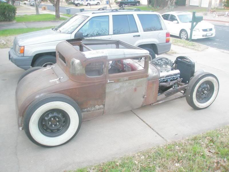

    I swept my frame cause I saw Bob do it and I liked it. He didn't invent it. But he inspired alot of guys lately.
    I can ***ure you sweeping my frame was NOT easy. It was a *****. And in my mind it was worth it. I didn't take any shortcuts or "used what I had", it's the only way to make my car look this way. You may hate it but such is life.

    Execution is everything. I never noticed either.
    The wrong kind of Z, is one that advertises it's presence.

    As to scrub line, That's as much a function of tire and wheel selection as ch***is design. I have about 4.5" sweep in front on a 4" dropped I-beam with the back Z'd about 13 inches and I still have 5" of ground clearance. I run 16" rims with 5.00 Firestones and some generic 7.50s. If both tires aired down at once on either end, I would still have air. Stay away from foolish designs used for he sake of appearance and function will lead form.
