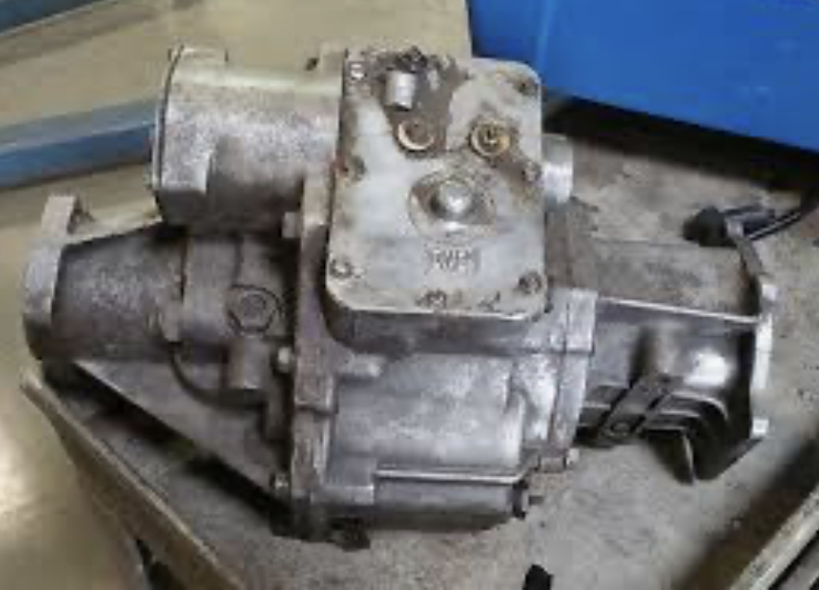

  7. Here is what they look like

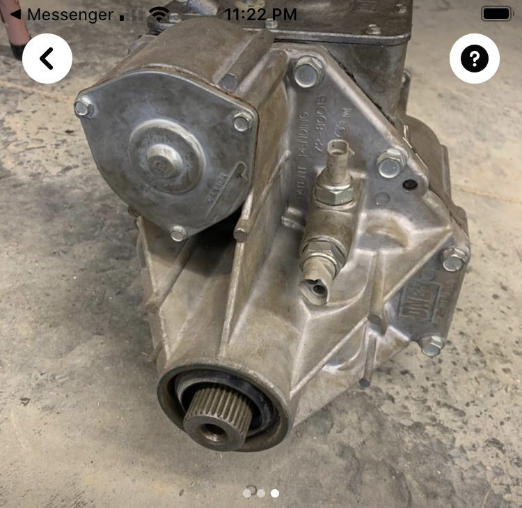

  15. Bought the OD unit.
    Super clean and smooth. Manual shifted fine. We will se when we install it.
    Should help the short bus cruise a little better.

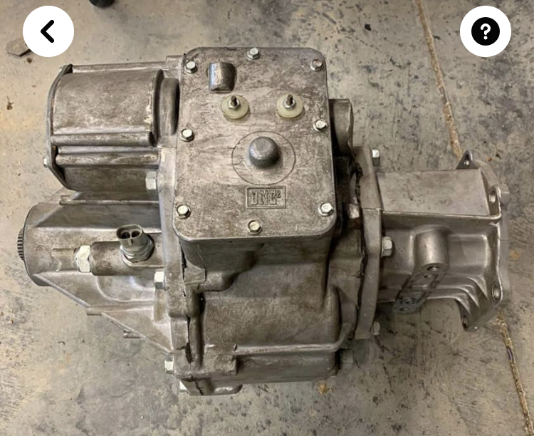

  17. 811BACAD-8ED0-47F0-A3E8-3CABBF9F23CC.jpeg 01CD6425-EF3C-42B6-8A0C-3F458401755D.jpeg
    hope it works out.

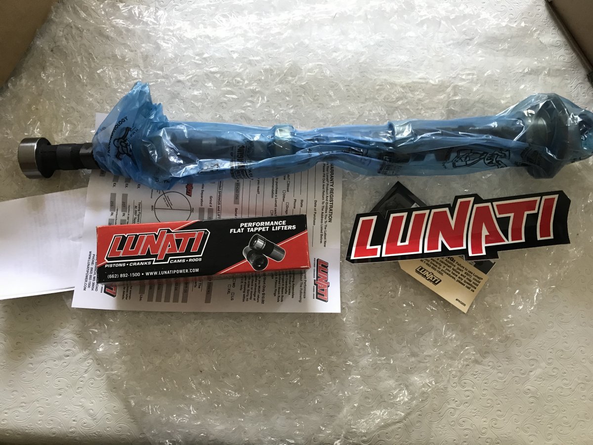

  23. Delivery truck dropped off a present today.
    now we can finish up the 500 block. Going to order springs.
    We figured out the wiring for the OD. And yes, it can be wired like a 2 speed truck rear. The Doug Nash version doesn’t use the “electronic box” the dual range version used. But that’s basically just a 2 second momentary switch anyway.
