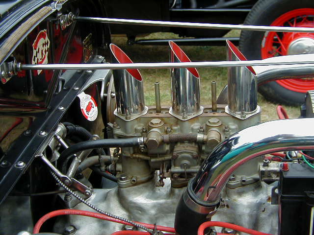

    Here's a Webber adapted to a flathead. This was done by Russ Daly from Newport, RI. He's a pretty clever guy.

    As far as performance downdrafts, there are 3 major series of the top of my head dcnf, idf and ida. These are non-progressive. Each is available in several sizes. The 52mm that someone mentioned were an aftermarket item. Webers are sized by the throttle plate rather than the choke (venturi).
    The weber shown on the flat head and most likey the one someone mentioned running on a Porsche (assuming it's a flat-6) would be a 40ida3c. 3c meaning that it's a 3 barrel as most webers are 2 bbls.
