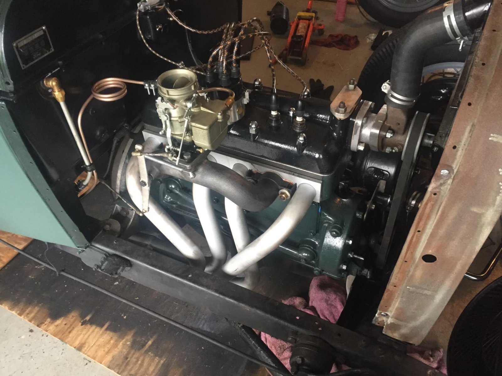

    I bought this one from Snyders 5 years ago or so. I’m not sure who made it. It had a Winfield type shape, but not exactly as smooth.

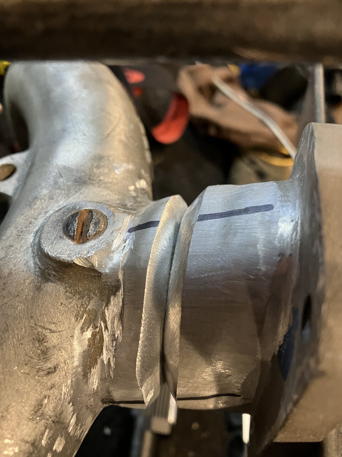

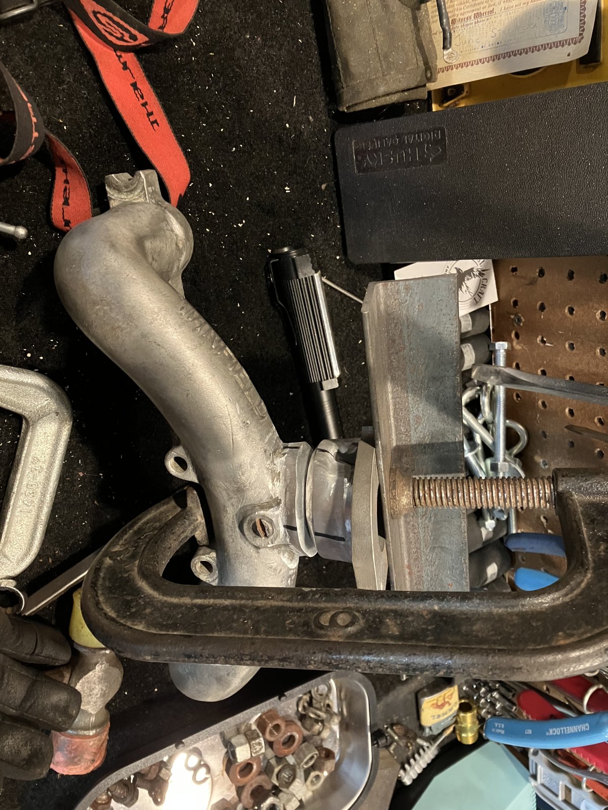

    And I’m currently modifying an old damaged Winfield to mount a Stromberg.

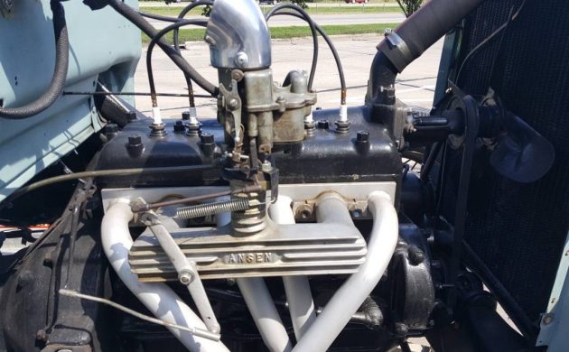

    Have you searched 'model a intake' in parts for sale? Seems to be lots of options. Whether they are sold or not is another question. I'm running an Ansen with a single 97 myself and Reds headers.
    Warren

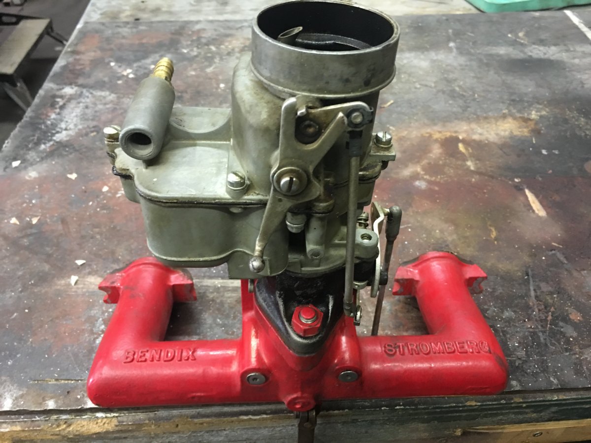

    There was also the stromberg-bendix single downdraft intake.
    I pulled this from google images.
    Period correct too, if that matters.
    These come up for sale every now and then.

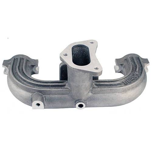

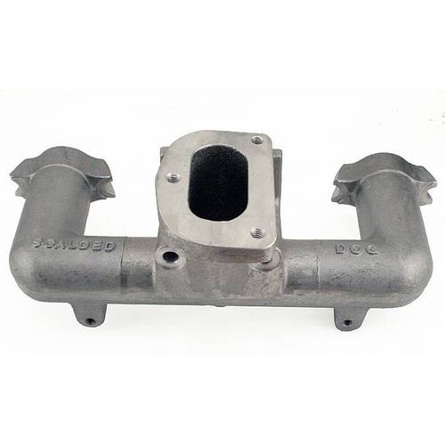

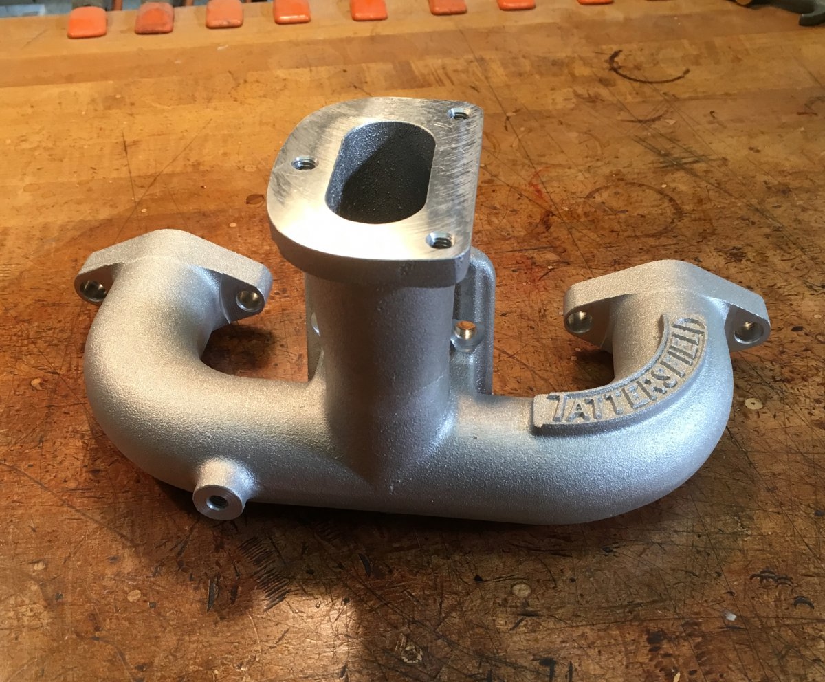

    Might as well post pics. Somewhat available single downdraft intakes as of 2022
    Scalded Dog
    Weber
    Ansen
    Tattersfield
    Burns
    01266717-A092-47C9-A9E1-46316ED3DE29.jpeg E04CD6E0-7C99-4212-8F46-4677E08423BE.jpeg 5108C5BE-E5B8-4FFA-BE24-6EA7393181CD.jpeg

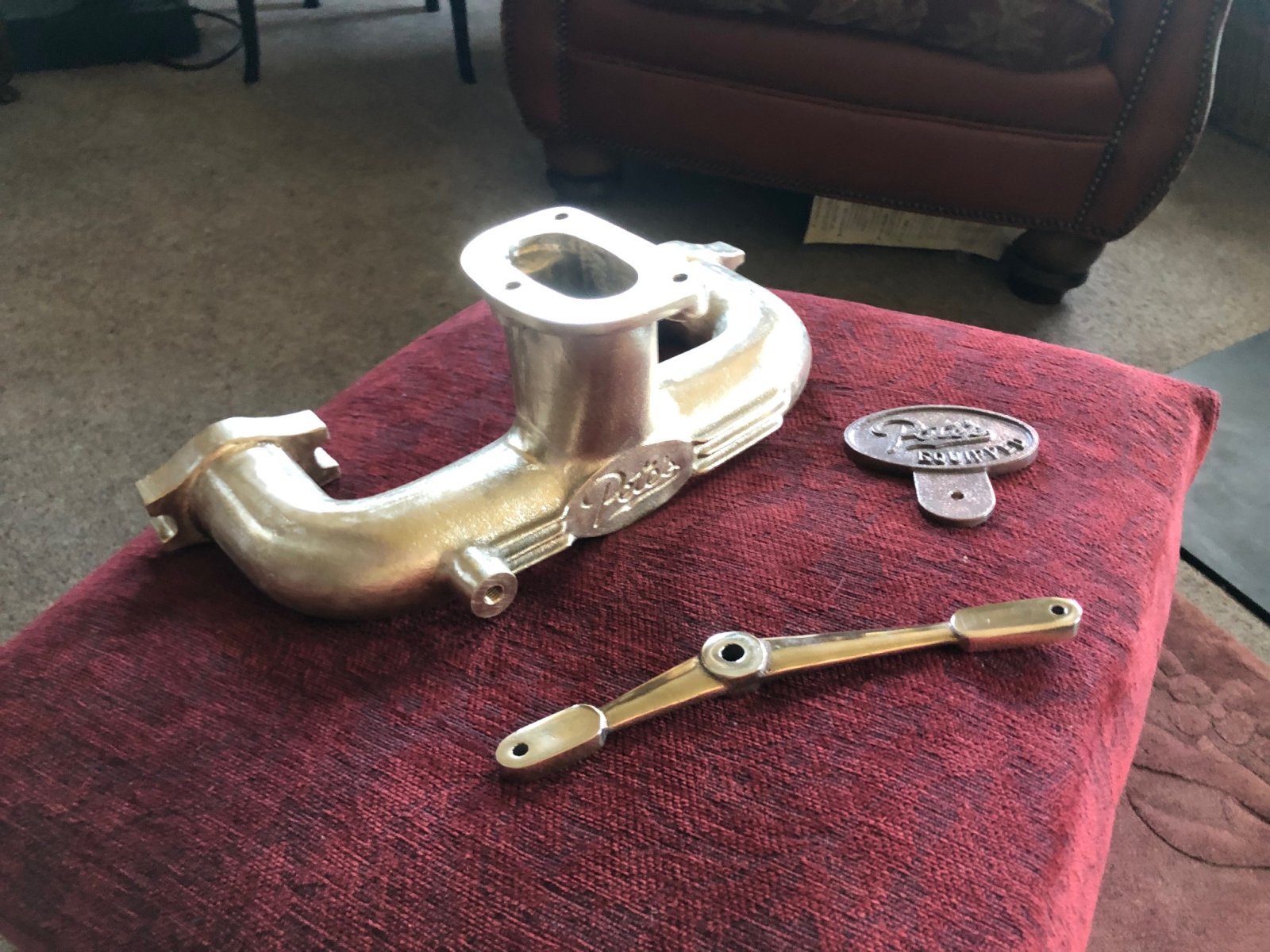

    I was just about to mention Pete's Speed Shop, he is a top fella making some cool pieces. I've been to his place & bought some parts from him. - not a manifold though.

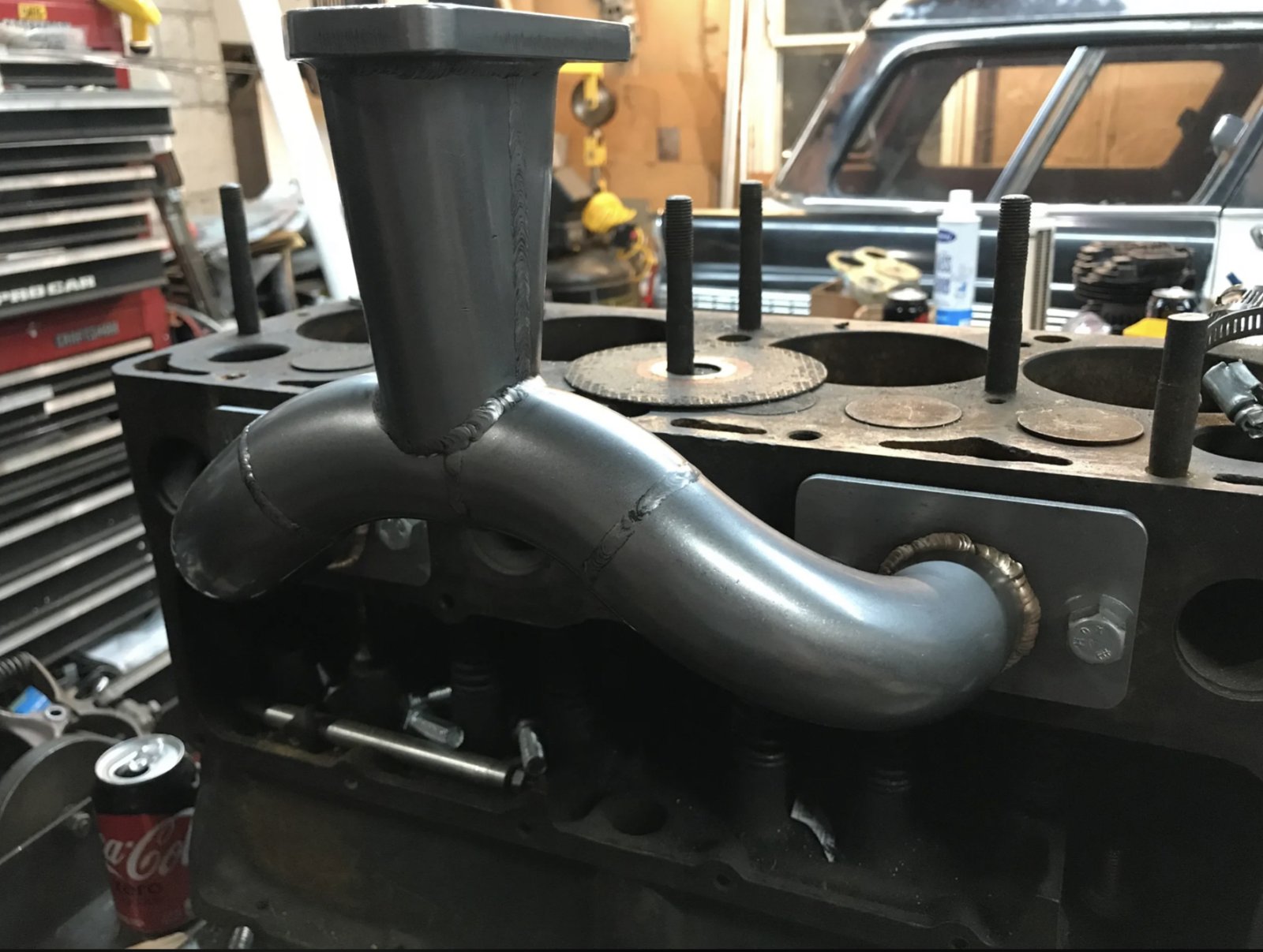

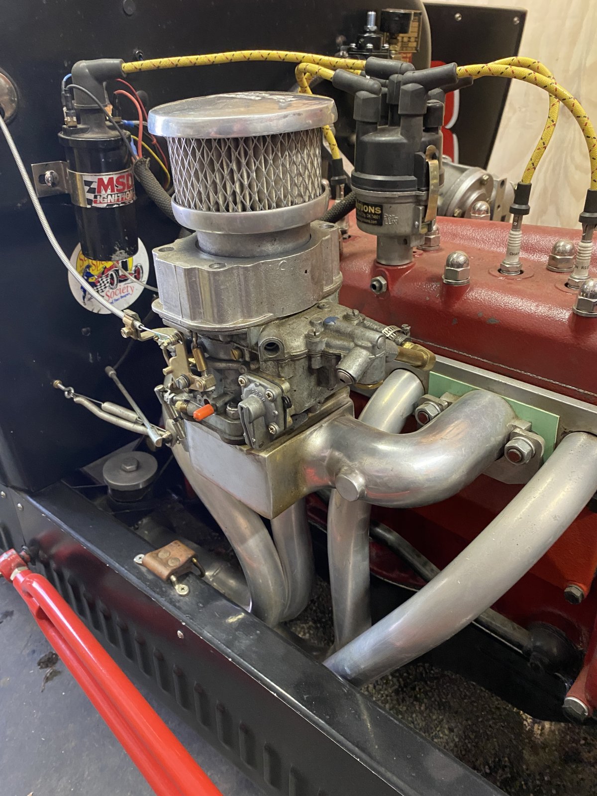

    Unless you're after an authentic cast ally vintage look, and if you have the equipment, it's fun to have a go at making one.
    I surprised my self by making one that works for my '28 Chevy banger, it doesn't have smooth bends, but neither do some of the ones above, and it can be argued that on a low revving engine sharp corners keep the mixture in suspension better. Not sure about that but it does work so much better than the original setup.
    Now planing to make one for my Ford B banger but using the exhaust heat instead of water heat, it'll be cheap (free) and cheerful.

    Depends on the state of tune which 2bbl you choose to use, a 162 cfm Stromberg 97 may be too big for a stock banger, but the visually identical 116 cfm 81 with its smaller venturi produces a much faster airflow.
    I messed about with various carbs with not much success until I spoke with Clive at Stromberg, he recommended an 81, it came jetted for my stock Chevy banger.
    It's the one shown on my home made manifold, it ran really well out of the box, no flat spots, hesitation, or popping at all and gives a huge improvement over the stock updraft carb.
