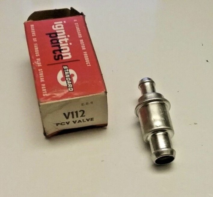

    This pcv valve (read vehicle I entered) is an inline and or push in. Grandpa’s car either received a replacement engine or a valve cover swap. IMG_2755.jpeg

    True, I asked since this topic comes up so often and could help other’s. For myself, I never can get a good number for closed system’s where vapors travel into the treaded end and out the hose end.

    I guess a guy could thread a hose ****** to the fitting on the filler tube and another on the threaded part of the PCV and use it inline because you could then turn the valve the correct way

    :cool: IMG_2758.jpeg
    that I’m using on the avatar. Flip it as required.
