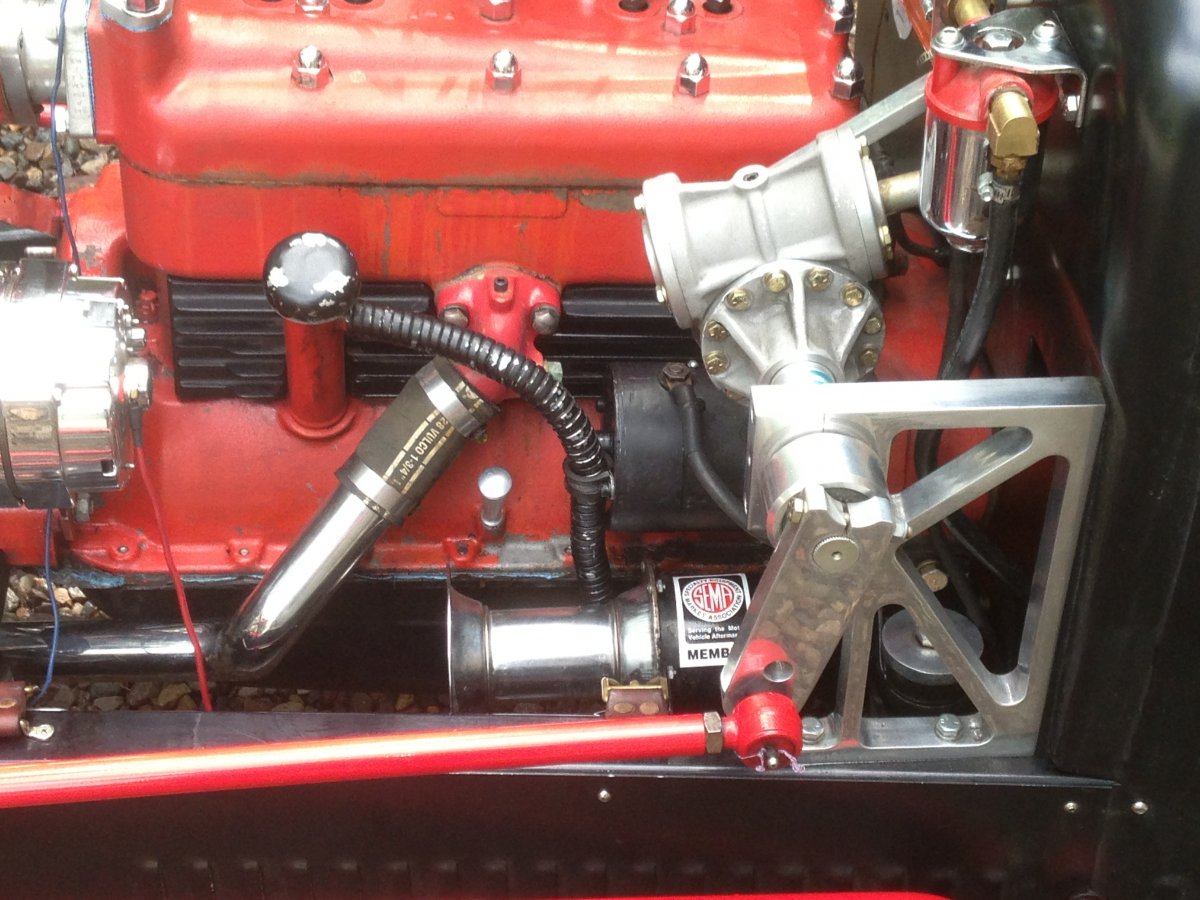

  15. denis4x4
    Joined: Apr 23, 2005
    Posts: 4,429
    denis4x4
    from Colorado
    These are available from Bert’s, Snyder’s and other Model A supplier. F98C92FE-F1DD-4925-A76A-5977F0A4C51B.jpeg
