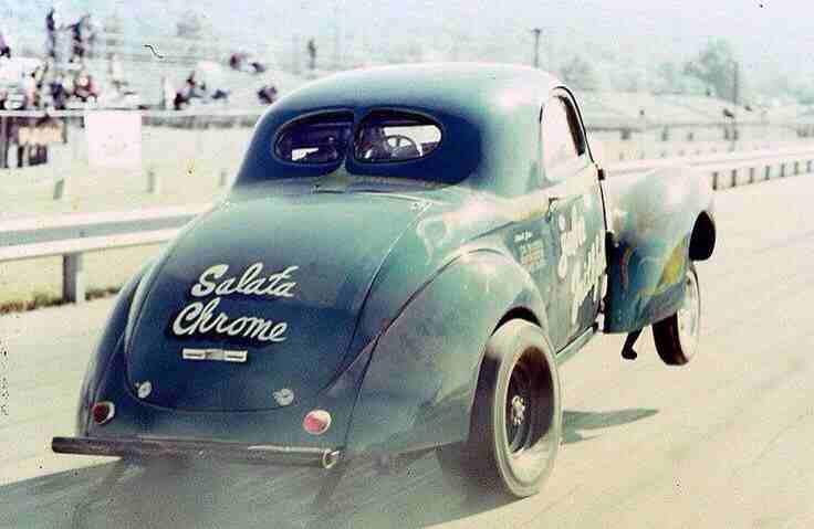

  8. elgringo71
    Joined: Oct 2, 2010
    Posts: 3,867
    elgringo71
    For a g***er it the pipe bumper was done to get the center of gravity as far back as possible to transfer the weight to the back tires for increased traction. The tires were narrow in those days and the tire compounds were hard and didn't bite well.
    The push bar usually wasn't done on a g***er. attachment-29.jpeg 9781058_orig.png
