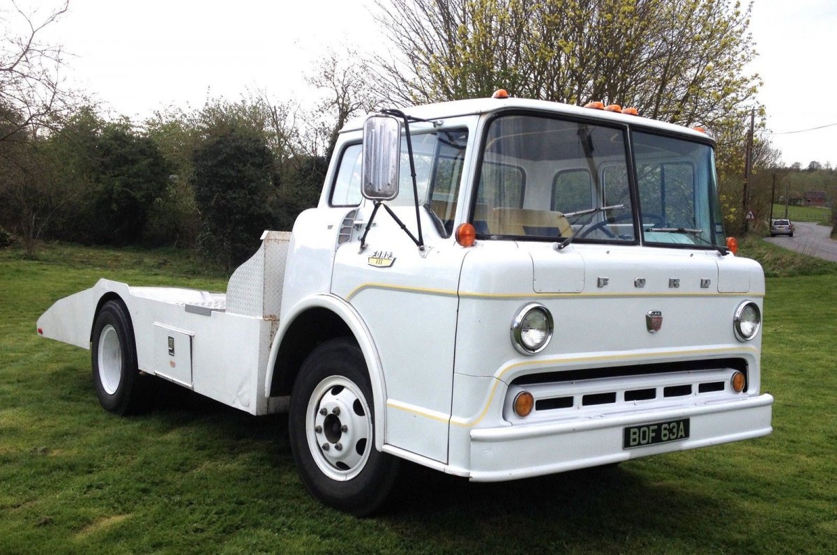

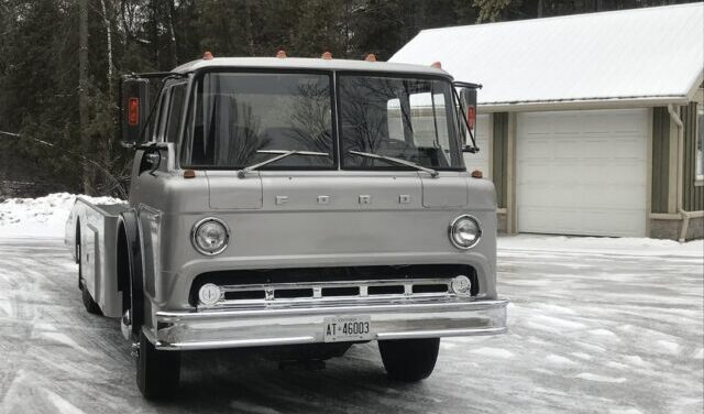

    Now of course these are way too big. But the above photo caught my attention. Even though I think that is a C800 or something like that. I kept searching and finally ran across this one:
    Still a bit too large, not to mention, one car has certainly been enough of a headache by itself...LOL! But it got me thinking and really dialing in on the C600 style unit.
    This is perfect, but of course it is just a model. From what I can find, a figment of someone's imagination. So I guess I will just have to figment something up of my own! LOL. Albeit in full scale!

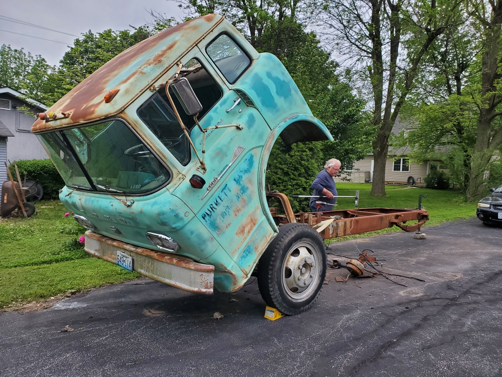

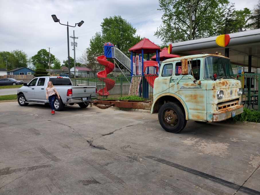

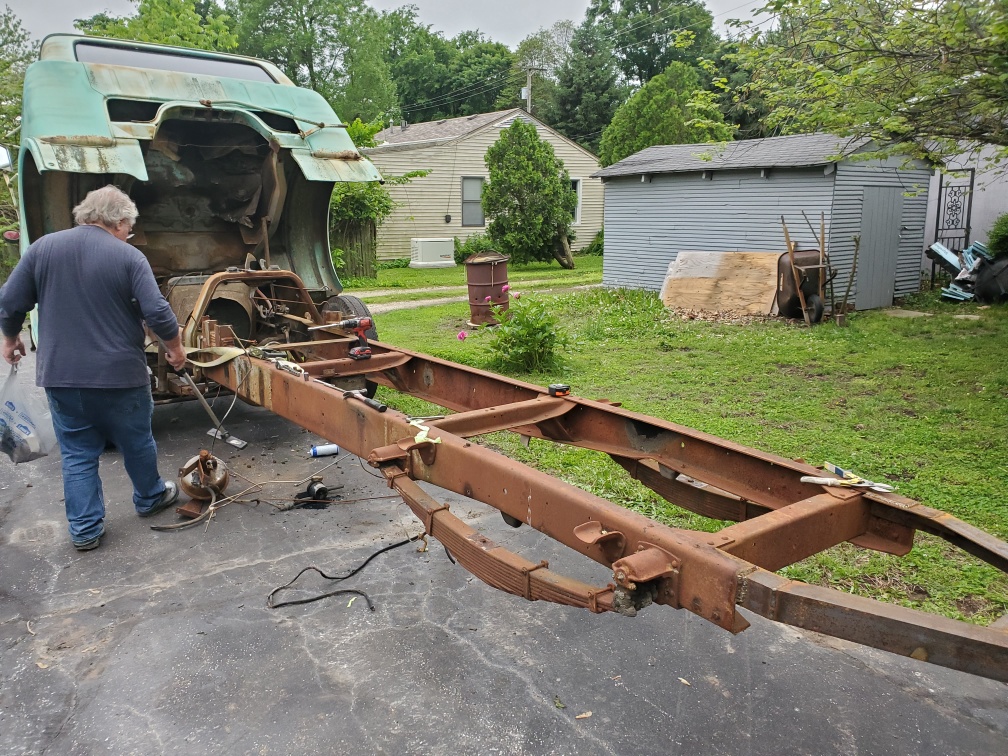

    After Jackson had the truck dropped off at his house, we headed over to have our first look.
    I don't know if it was the lighting with the sun just about to set or not but I thought she looked amazing!
    Jackson is not too far from MOKAN Dragway and that is a good 1.5 hour drive to my house and that is pushing fairly hard. We contemplated for a bit on exactly how to get this beast back to Republic. We finally decided the only cost efficient way would be to flat tow it. But probably not the way you are thinking. We took some good measurements and beat it back home.

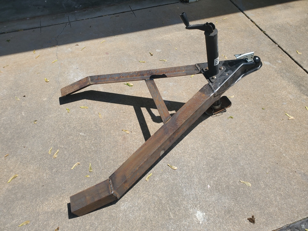

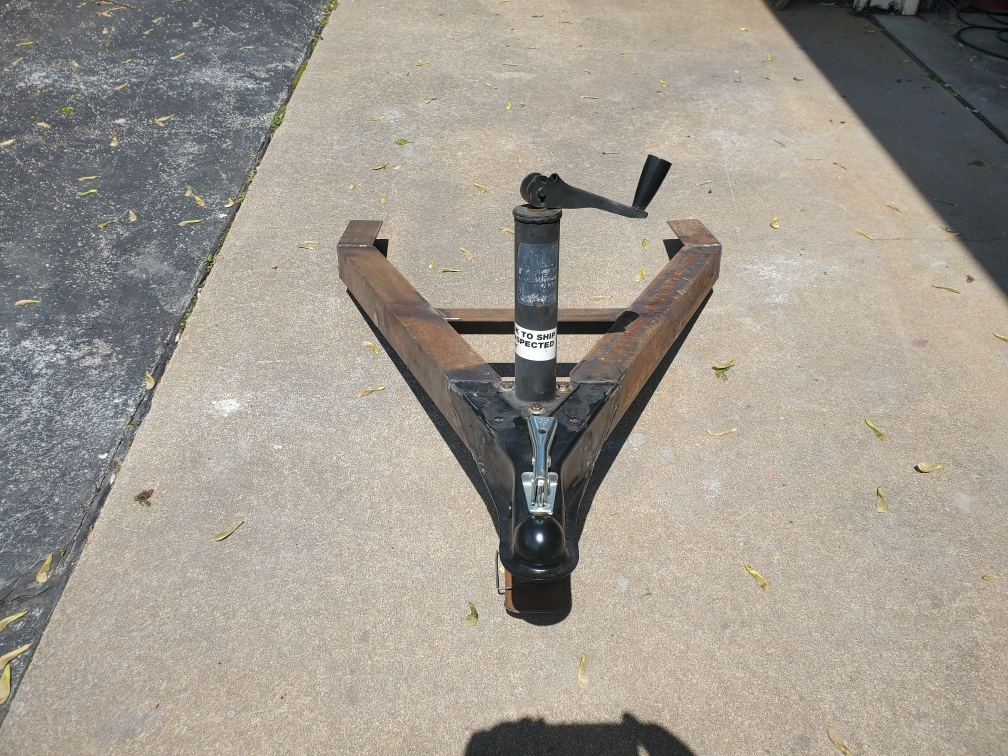

    I built what would have to be called a pretty heavy duty tow bar. I started with a new trailer coupler and bolted in the hand crank unit we took off my enclosed trailer when we isnstalled a power unit.

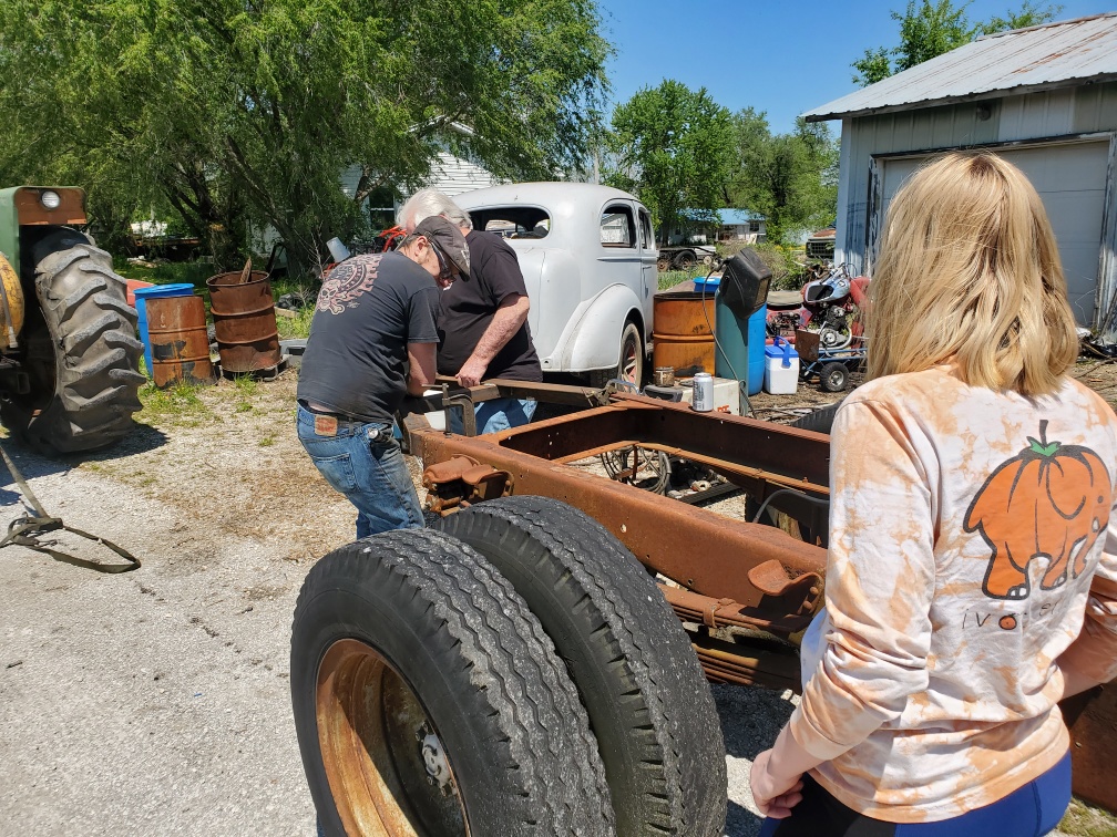

    Hoping our measurements were good, a few days later we were back to put our plan into action. The tow bar fit like a glove and while it was clamped in place, Jackson welded it up for the trip home.
    After it was secure, we torched the ubolts on the 60 year old rear end, lifted the rear of the chassis up and rolled it out from under it.

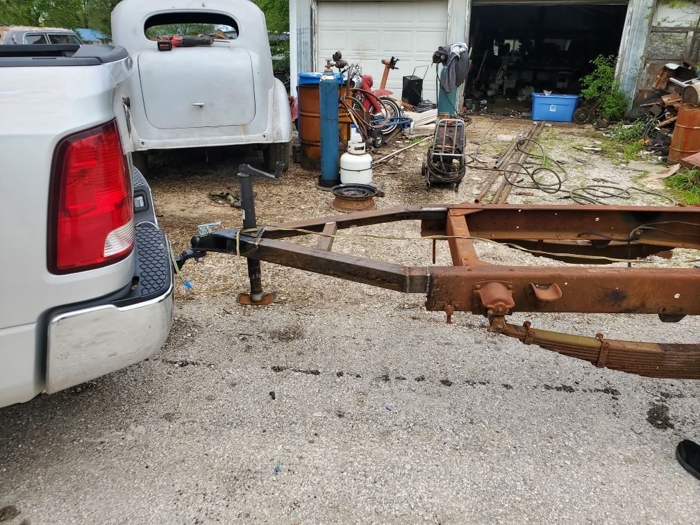

    Then we sat it back down on the trailer crank and wired up some magnetic tow lights. While Jackson was welding Dad and I strapped both the pitman arm and steering wheel in place and hoped it was straight.
    Then we latched it to the ball on the truck and I took a quick spin around the block to see how she tracked. I saw no issue with the test tow, so we loaded up and headed for home.
    We sort of kept to two lane blacktop. I mean she seemed to tow nice enough but certainly not something you want to hit the interstate with. But we easily managed 55 or better all the way home. Above we stopped about 20 minutes in to have a look at the tires and make sure the bearings were not on fire etc. There was no visiable issues with the tires and front bearings were as cool as cucumbers. We all had a cherry limeaide to celebrate and hit the road again.
    We actually made pretty good time, at least we got home before dark. LOL The tow bar worked perfectly.
    AND to be honest, that trailer crank was pretty darn good idea!

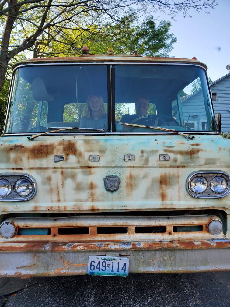

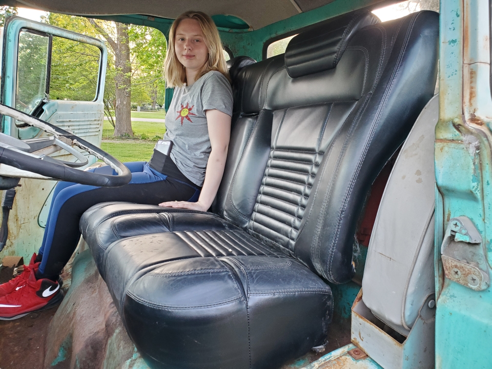

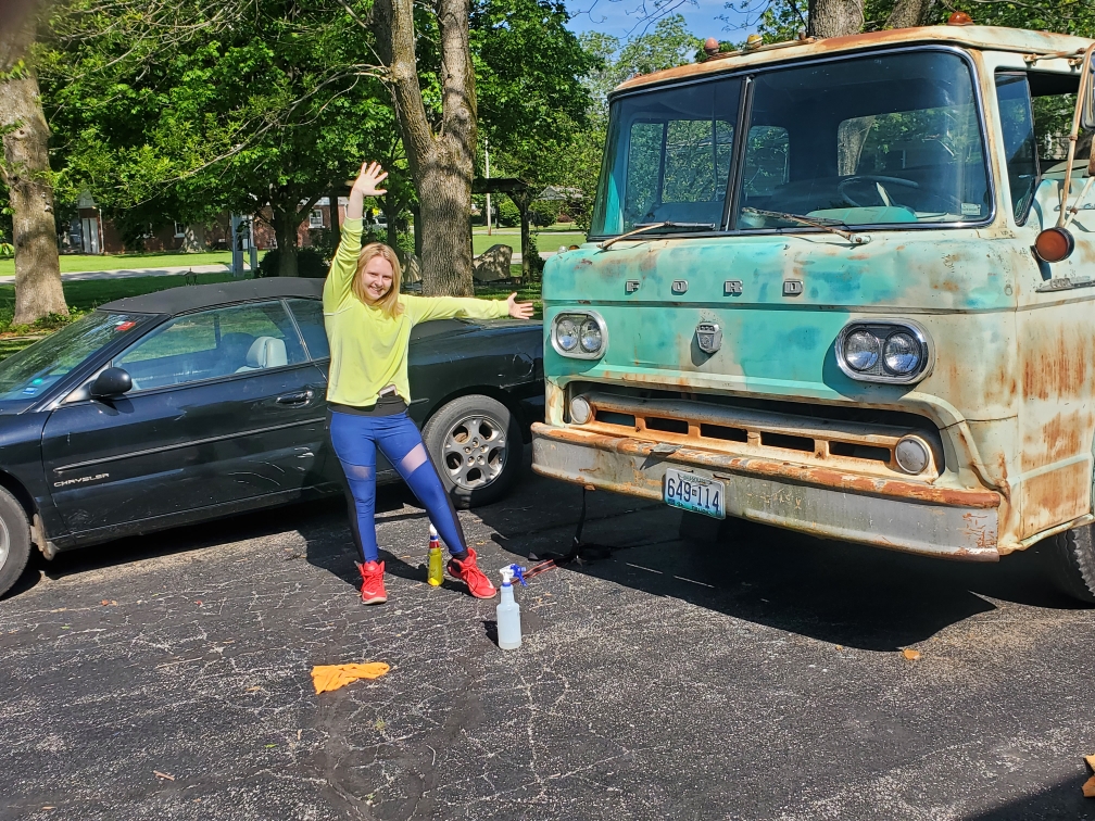

    The following weekend, my daughter and I cleaned out the cab and even tried out a leather back seat I snagged from an old Cadillac my neighbor had and took to the scrap yard.
    It was a pretty darn good fit if you ask me!
    Comfy too!

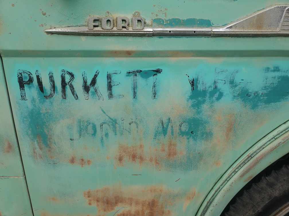

    Then last weekend, while Dad was wet sanding on the Cobra's new Wimbledon White paint, Zoe took a piece of 1000 grit and the hose over to the truck and before I knew it she had put some much needed color back in the old girl.
    We carefully discovered where the old girl had spent most of her life. Purket MFG Inc. in Joplin, MO. We did a little research and that was a company that was in the Industrial Laundry business. They manufactured equipment and held several important pattens therein. How ever after doing a Google street search of their old address we found only grass and a vacant lot. So apparently this old truck and the remnants of the lettering on her door is all that is left.

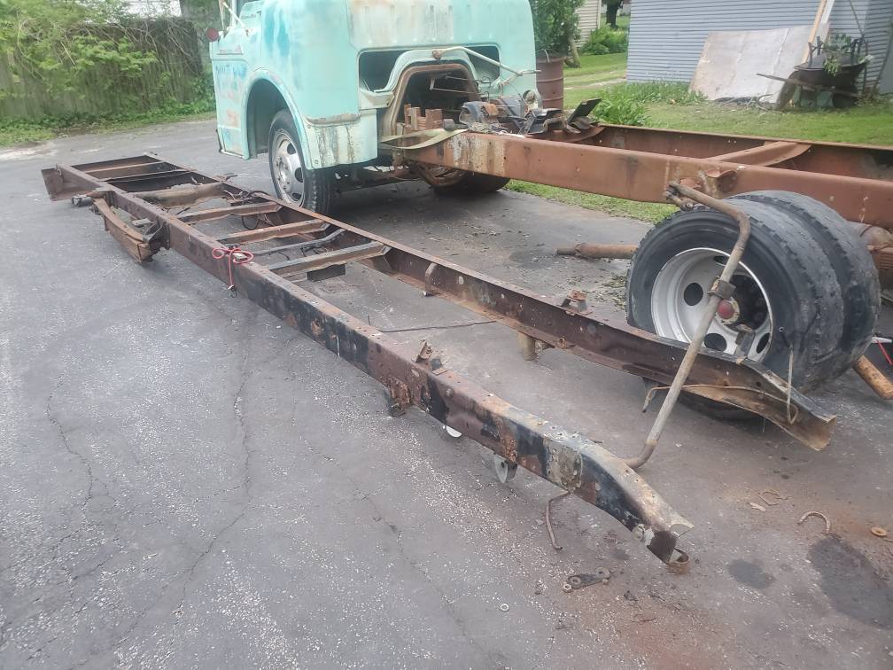

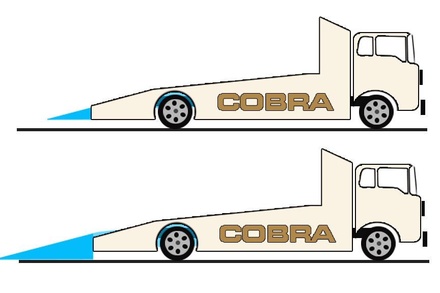

    After taking a few measurements, the initial plan was simply scrap everything but the chassis and drivetrain, drop the cab on the front, figure out how to fabricate the steering and build a ramp bed. There were a few concern on my end from the beginning. The biggest was aethsetics. The width of the front end of the bucket truck is a bit narrow. About 6 to 8" shorter from hub to hub. I was not sure what it would look like in the already exhagerated large wheel openings on the C600.
    Then this week, I found this chassis for sale practially in my own back yard:
    This is from a later model Bluebird 28 passenger bus. It is the correct width and length to drop the cab on and continue the build just using the motor, trans, and other ancillary parts and pieces from the bucket truck, including the title! The other crazy cool advantages of this unit include 4 wheel hydraulic disk brakes and a power steering box. Not only that, but the original bus was a cab forward design meaning the steering is already way up front and engineered back to the axel etc.
    The rear is not attached that is why it looks a bit twisted. But while it had some killer positive points, the chassis itself was very flimsy. In my oppinon for what we are trying to do it is way too light. I had no idea this is what was under a bus. I guess they get their rigity from the body and frame combination.
    Sitting back at home looking our cab sitting on it original frame rails we had a very obvious thought...
    ...NOW THIS IS A CHASSIS! I mean take a look at this thing. The original truck according to the fading hand painted door graphics noted it was licensed for 24,000 lbs. Not to mention, the stupid cab is already engineered to this chassis. How stupid would it be, not to mention heavy duty work to put this cab on any other chassis then the one where it currently sits! So we decided to purchase the Birdbird stuff from above and simply bolt the rear end to our springs out back and swap out the front end. We are headed over this morning to pick it up. I figure we will simply cut it up, keep what we want or need and scrap the rest. Last night after we made the decision, we started unbolting and cutting off all the stuff we don't need.
    Right now the plan is to drop the motor and trans in a bit further back than the original 292 (sort of a mid-engine design). We really don't care where it sits as long as it does not interfere with the ramp bed. If we are successful with the before mentioned rolling back ramp bed, it should basically expose the motor for easy access when it is rolled back. We are off to snag the Bluebird stuff!

    You made the right decision on keeping theC series frame with the C cab. It’s a strong frame and you saved your self a ton of work. I just wish you would have kept this project all Ford . Putting the 454 Chevy in kinda defeats the theme I thought you were going for. I know most folks won’t see the engine, but we will know it’s there.
    I think the smaller wheels are not going to look right, unless you get adapters and put larger than the 16 inch wheels.
    I would like to have seen you guys keep the large/ Strong C series rear end and put an auxiliary transmission in it. TruckDoctor mentioned the brakes were marginal. All the CSeries I have dealt with had air brakes and they worked good!
    Going auto transmission is going to save you a ton of problems. They actually put automatic transmissions in the C series trucks. If you could find one equipped with one you would have a bolt in shifter with a nice heavy cable, that could be adapted to your transmission. I know that two of our old C series fire trucks with chrome bumpers and chrome grills, in perfect shape we’re taken to a scrape yard here on Muskogee a few years ago. Our automatic ladder truck is probably junked there too, by now. There is one thing on those trucks that will give you fits! I don’t know how much of the cab wiring you are going to keep, but Ford put a multiple point connector over on the passenger side, behind the grill. It has a tendency to come loose when you open the cab. You will loose power to the cab. A .02 zip tie is your friend here! Lol
    I will be following this build, as I did the Cobra. Knowing you guys.... your going to knock it out of the park! At least with this project, you have more room! Lol Good luck!

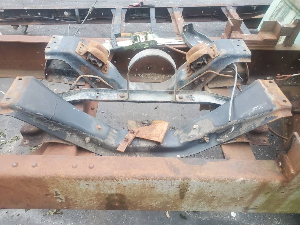

    Well the Bluebird put up quite a fight this evening but we finally clipped her wings.
    Now to chop it up into manageable pieces and off to the scrap yard. A few of the valuable pieces that we have robbed:
    The power steering unit. Which we were really excited about, especially when we found the exact same tilt front yolk on it as the 600. However it is totally bas-ack-wards!
    The pitman is on the wrong side. The 600 box is inside of the frame rails with the pitman arm toward the drivers side. The Bluebird is way to the outside of the chassis with the pitman arm opposite etc.
    Unless we decide to go right-hand drive, we have some serious engineering to do and I am not sure if we can pull it off.
    We did however snag both the cross members for engine and trans mounts.

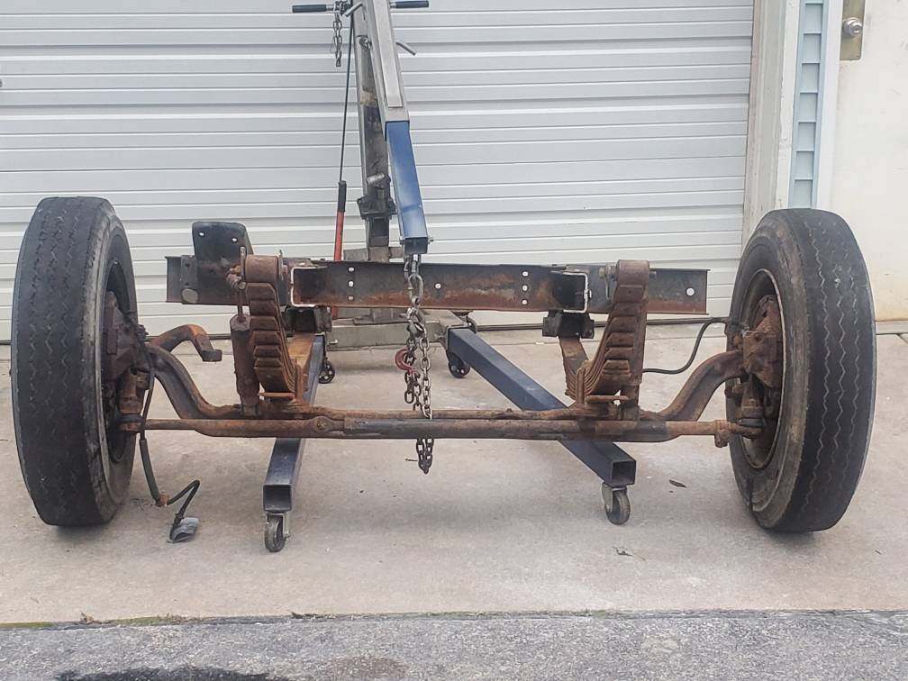

    Woo-hoo...check it out. I got me another straight axel vehicle. How about that 12" drop...LMAO! We finally got everything stripped off new front axel.
    I got a good look at the rotors this evening and I think they have enough meat on them to turn.
