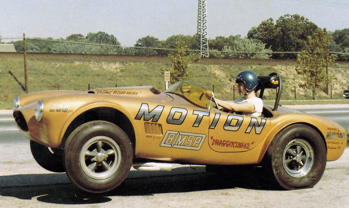

  22. Deuced Up!
    Joined: Feb 8, 2008
    Posts: 4,224
    Deuced Up!
    This is what I am looking for... I understood it was the dow7 color if the wheels were left in much longer. I could be wrong maybe just ran hard and put up wet Magnesium wheels...lol
