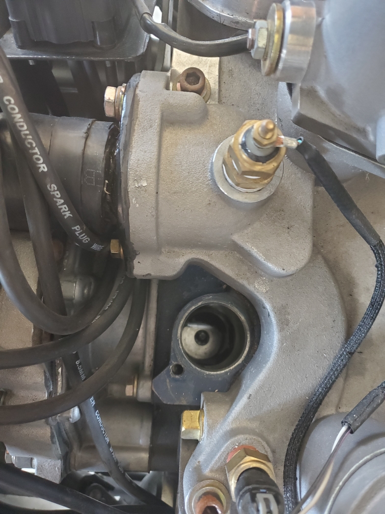

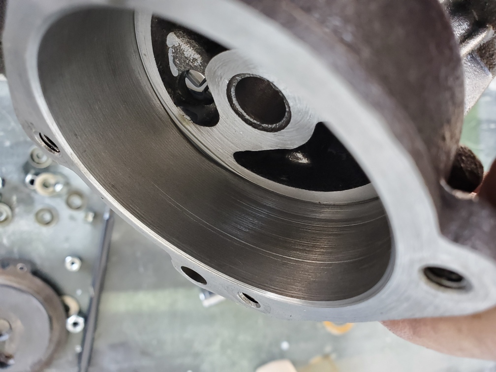

    So with the better part of the day left yesterday after getting the Riviera off the jackstand, we decided to work on the Cobra. Since the lift is still out of commission, we put it up on jackstands high enough to safely get under it with enough room to manuever a bit.
    I had excellent room to get to all of the pan bolts and quickly removed them. The pan dropped easily down on the ch***is cross bar. However, it was immediately apparent that was as far as it was going. I really thought we would be able to manuever it around a bit and get it out but know go. So I put a couple bolts back in it and broke out the sawsall. I cut the cross bar leaving about 3" of it on either side. We fabricate some plates so we can "bolt" the cross member back in place.
    Regardless, we got the pan down and of course found a few metal flakes hanging about. We removed the windage tray and completely drained it. I removed the oil pump to have a good lock. We diss***embled it to have a look at the inner and rotor outer gears or rotors.
    As you can see the housing where the outer gear turns obviously had a few pieces get in there but nothing at all in the pump when we took apart. The inner gear and inner area of the out gear where all the oil is pumped did not have a mark any where on them. So super cleaned the pump, oiled it up with Pengrade, re***embled it and reinstalled it.
    Before reinstalling the oil pan I took a photo to do***ent to myself that the stupid oil pump shaft is in place. LOL. I have done that before! The shaft is a high performance ARP brand. We inspected it very closely to make sure it was straight and not twisted at all etc. It was in perfect shape.
    We took all the oil lines, remoted oil apparatus, oil pan and pick up tube etc. to the car wash and cleaned the living daylight out of all of them. Then came back and dried them completely with high pressure air etc. Just before reinstalling it all, we went ahead and pulled a couple rod caps just to have a look at the bearings. The ones we looked at were in good shape, so we decided to move forward.
    It went back together with reletively no issues. We filled it with 6 quarts of Pengrad 20/50 and popped a new Wix Racing filter on it. Speaking of filter, we did cut the old wix filter apart to have a peak.
    Now we are just waiting on the composit distributor gear to arrive and we are ready to go again!

    Knew a guy years ago would drain oil then dump in kerosine, remove distributor & spin oil pump to flush all lines & wash dirt into oil pan for draining. This on SBC & seemed to work. I never tried it & do not know if helped but sort of makes sense - maybe???? Only mention for consideration or others to comment.

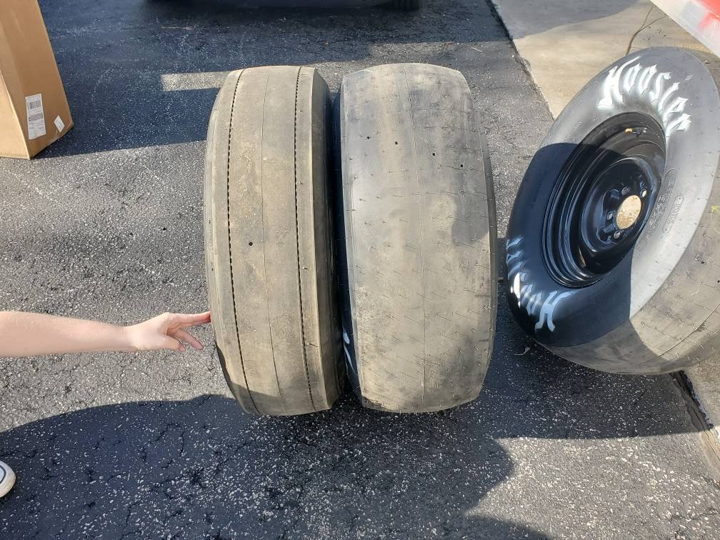

    I had a lurker pm me yesterday (you know who you are)(LOL) asking how I chose the Hoosier D06 Compound and why. Well that is a very good question. As far as I can tell the entire Hoosier compound number system is a big internet mystery. Maybe it is because Hoosier feels like if they try to explain the differences it might make someone accidentally purchase the wrong slick. So of course by saying nothing, a person still might snag the wrong tire but Hoosier will not be directly at fault. LMAO!
    I tore up the internet when I was trying to purchase a set for the Austin. Here is what after an exhausted search I decided. The D in the number is for bias ply. I was not interested in the whole drag radial gig which it appears to me have a C in their compound description. You can find a chart from Hoosier which simply list all the compound numbers from left to right and indicates you are looking left to right softest compound to hardest.
    Now this chart straight from Hoosier is extremely helpful (not). There are the D05, D06 and D07. It is obvious the D05 is softest and D07 is the firmest of the 3. However you would think the D06 would be in the middle, but it is not. It is actually a bit closer to the D07 so I ***ume, according to the chart that it is just a bit more than 50% firmer than the D05, may around 64% or so. Now on the top line the C07 radial is right there with D07 which one might ***ume, however, the C06 is so close to the C07 that I can't imagine there could be much of a difference between the two. The the C09 has dropped down on the Bias Ply line and is according to the chart quite a bit firmer than the C11 which seems to toss the entire number system of higher number firmer tire in to question.
    And the what the hell is N/TF? NOT TOO FIRM? No idea but I like it... Maybe Hoosier could just go that direction with compound discriptions. S/OF - Sort of Soft, K/OFBNTF - Kind of Soft But Not To Firm, N/TFBNTS - Not To Firm But Not To Soft, Well laugh it up because that would make just about as much since as what I can gleam from their current system on the internet!
    Here is what I know from experience regardless of the labels. The Heavier the Car and Higher the Horsepower, the Harder the slick and then take if from their. High horspower and Heavy car gets a hard slick, High horsepower and lighter car, you can soften the slick a bit, Stick cars like stiffer sidewalls but again dependent on the weight of the car, and about 1500 other questions or combinations of width, height, and brand. On the Austin, I went in the middle with D06...being it was high horspower and fairly light car, around 3,000 lbs. I was really happy with the hook with a manual, they always seemed to give the right amount of spin off the line and with no tubes we had no issues on the big end through 150 mph plus.
    So I figured if it is not broken why fix it. We do not have as much horsepower as the Austin but we are quite a bit lighter etc. So that is how and why I went with D06 again. AND to be honest the only way to be totally for sure is mount'em and light'em! We shall see. Or you could just call Hoosier...LOL!

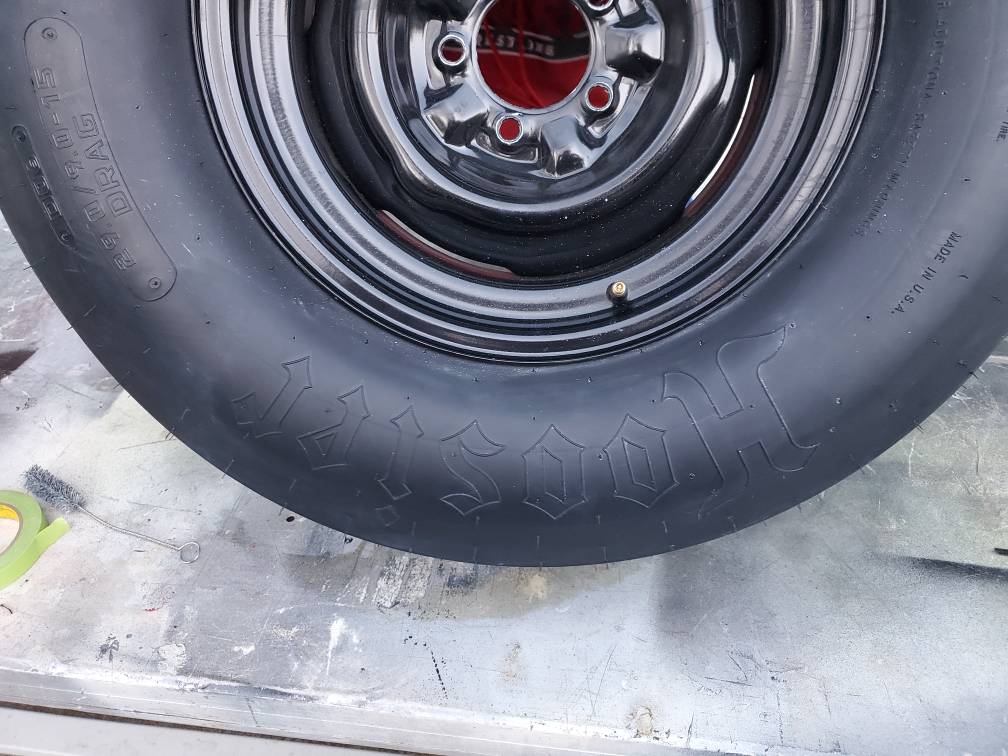

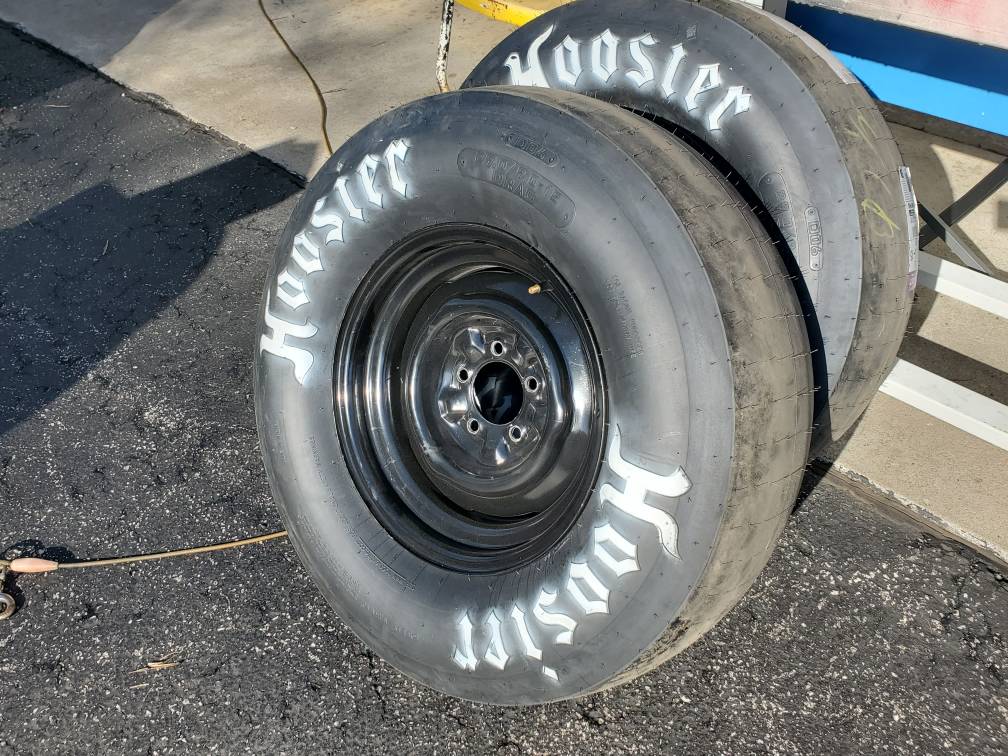

    Slicks came in today. Mounting them tomorrow and then declorinated brake clean takes it off. It works well, Dad's issue on the Austin was he did it with the tires on the car while on the rack. Lol

    So I got the slicks mounted today, man I love tires!
    I am pretty excited about them. Quite a bit of difference between them and M&H Dragster they replaced.
    And...if I say so myself...they look totally bad*** on the car.
    Just for all of you wondering about removing the white letters...a little non-clorinatex brake cleaner and small brush and it comes right off. We spent less than five minutes on these white letters.
    Easy breezy.
