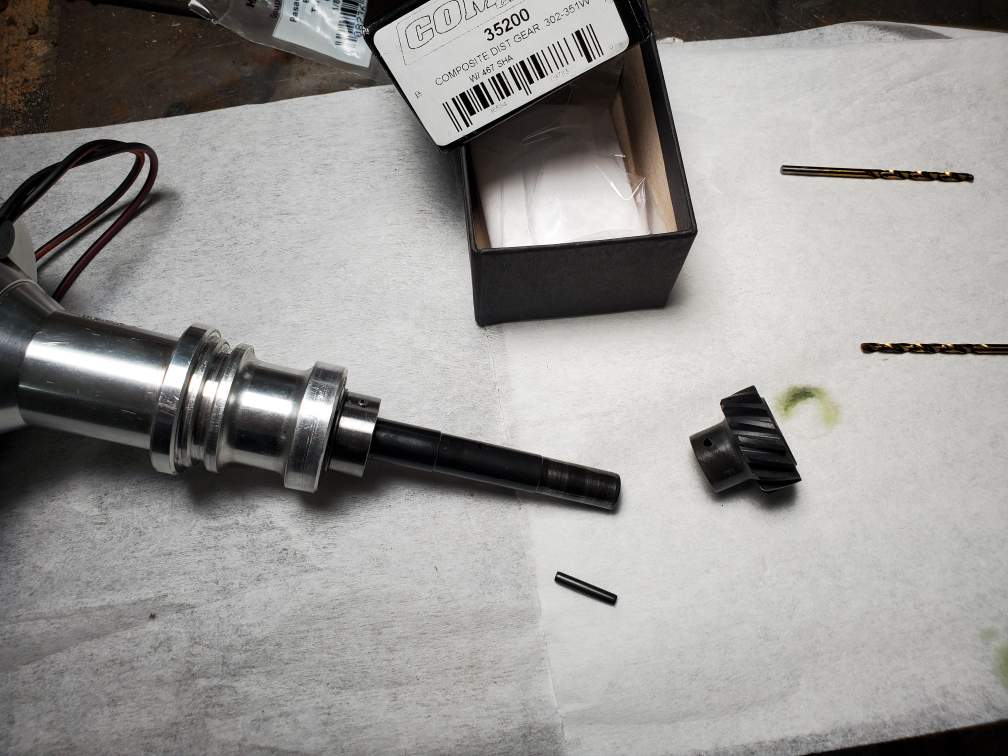

    Good to hear, glad we got you squared away with a correct gear. My gear came in too. To be honest I sort of hate to stick it in there, it is so light, it feels like something from a toy store. AND believe it or not, it showed up with some ***embly required. It didn't come with a new roll pin and it only has one hole. AND according to my calipers and reported MSD replacement pin size, that hole is too small.
    So I guess I will find a .125" x .75" roll pin somewhere today and a new 1/8" drill bit. You would think for what Comp Cams charged for that little beauty they could have at least included two holes!

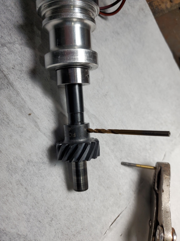

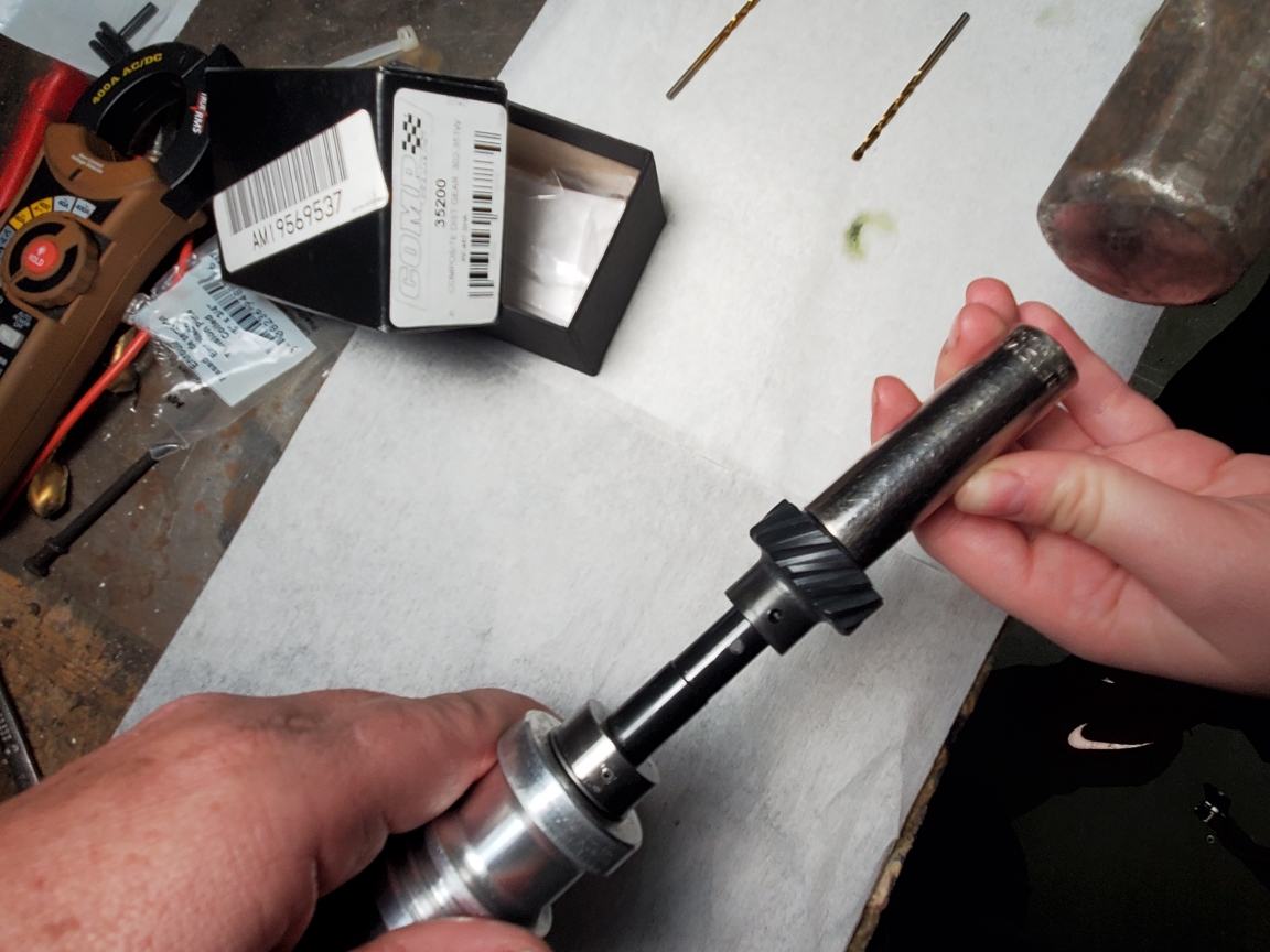

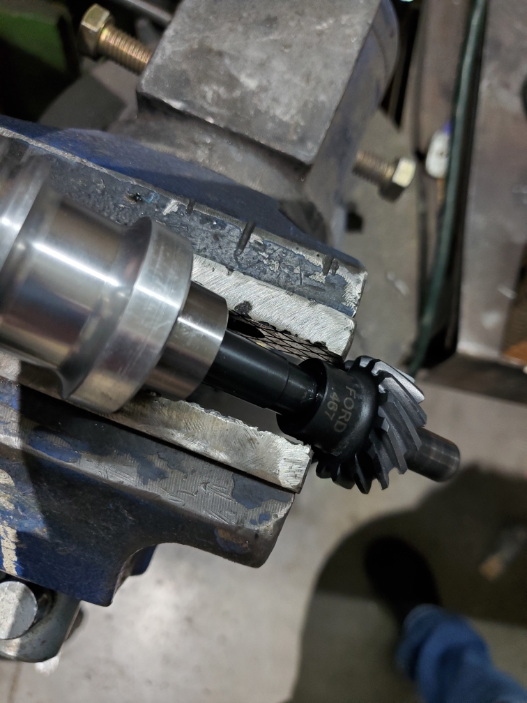

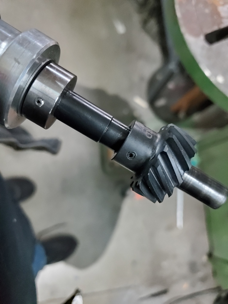

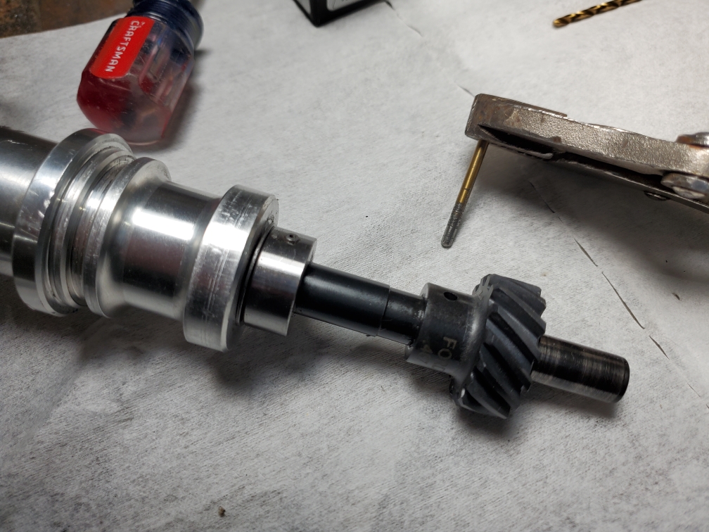

    Okay here is the scoop. We started this morning making our standard Saturday morning run to Springfield for breakfast. After we ate I headed over to a farm supply store where I get the majority of my nuts and bolts to snag a roll pin.
    When we got back I double checked the roll pin size in both the shaft and the "one" hole in the gear. It appeared to be the right size. The gear is tight fit on the shaft as expected. I oiled both up a bit to ***ist with the install. I eyeballed the holes in each and got the gear started on the shaft.
    With it on as far as I could slide it by hand, I took deep well socket and very carefully we tapped it on and up the shaft until the holes aligned. Knowing we had to be absolutely perfect with the alignment, I sacrificed an old 1/8" drill bit.
    After the gear was on, my "bit tool" would not slide in. No way we could align the holes perfectly the first try but we were extremely close. I ground the end of the drill bit tool a bit making it sort of a rounded point. Then I slipped it in the gear hole and lightly tapped it until it slid all the way in and aligned the holes.
    I took a pair of vise grips and worked the bit tool out and replaced it with a brand new 1/8" bit. After gently tapping it all the way in, we carefully chucked it up in the drill and made quick work of the other side of the gear.
    I started the rollpin with a light tap and then used the vise to simply press it all the way in being careful not to hit any of the teeth etc.
    ...and easy as pie, we are in and ready to drop the distributor back in place. I snagged the special priming tool and we headed back over to the Cobra.

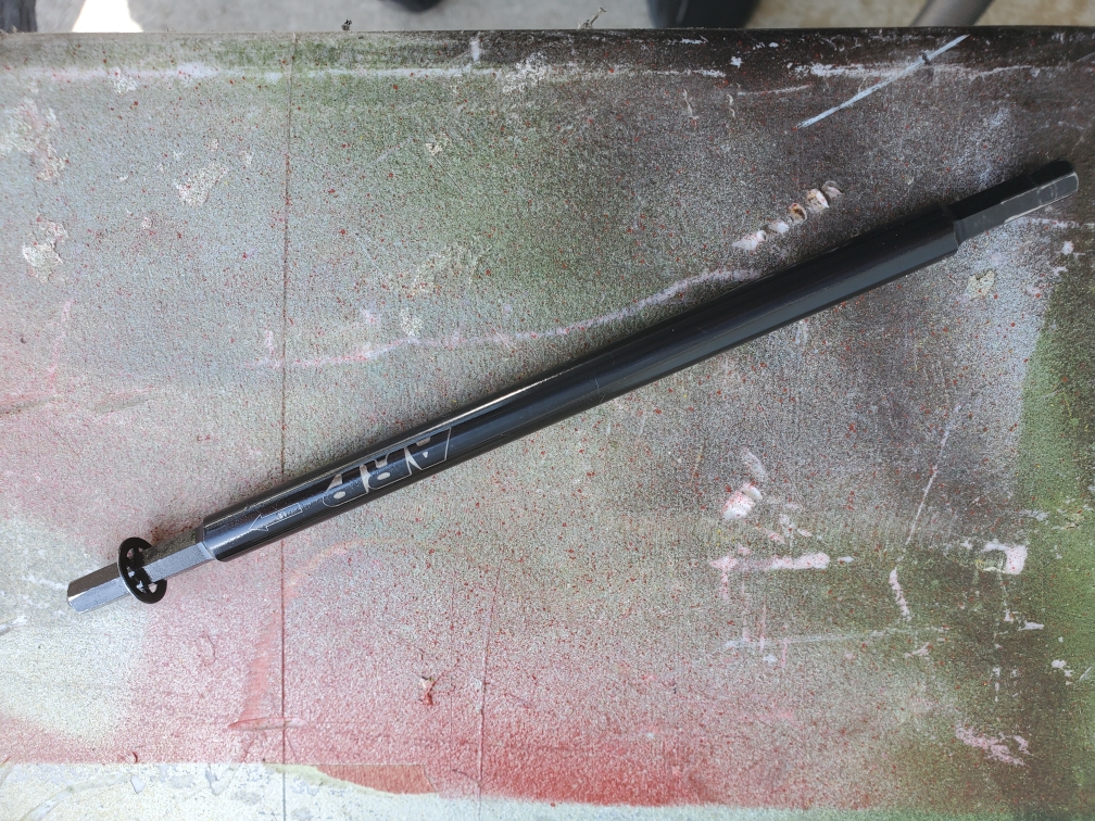

    We got the car all jacked up again, high enough to move around a bit under it. We drained the fresh oil into a very clean container and then took pan off. Of course the rod was submerged in what oil was left in the front drop area. I pulled it out and wiped it down.
    As you can see it is an aftermarket ARP unit with an arrow on it showing which direction goes up...LOL. I made sure it was pointing correctly this time around. We removed the oil pump, reinstalled the shaft and then put it all back together. However before reinstalling the pan, I decided to try and drop the distributor. LOL
    Unfortunately, nothing changed. It still only dropped to the same depth as before and that was it. There was nothing obvious going on this time so we took a closer look. The depth of the boss is 4" from the top the intake. After measuring the distributor, that is exactly how deep it was stopping. I could only ***ume the shaft, for some reason was not going in the hole in the boss.
    To be sure there were no other issues, we decided to take the gear back off. With the gear off we got the same results. So we removed the shaft. I dropped the distributor body in and it easily fell straight down etc. Then I took the shaft, by itself and a flashlight to watch and sure enough, it would not go into the hole.
    So this was quite a mystery. There is no way the hole could have gotten smaller. I could see it might get bigger, wallowed out or something but no way it shrunk. As for the shaft, there is no way I can figure it could have swelled up...LOL. I thought maybe there was a bur on the shaft (which to be honest would not surprise me). But it would have had to have been microscopic. I couldn't really check the hole in the boss as simply. I took a drill bit the exact size of the boss hole and taped a ratchet extension to it. I put it in top area of the boss hole and it went right in and turned freely. So I felt there was no bur there.
    I tried the shaft again same thing. It would not go it. So I grabbed some emory cloth and went after the last inch of the shaft a bit. I tried putting it back in and it actually started but was a bit tight. So I went after it again. After a few more attempts, the shaft dropped right in the hole. I have no idea what could have caused it, but we put the distributor back together and it dropped right in, you could feel the gears engage etc. So we went ahead and reinstalled the pan before calling it a day.

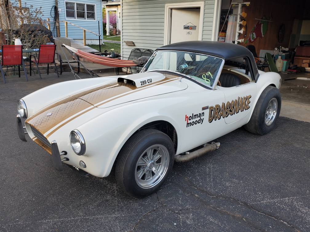

    Well I finally broke away and got the slicks mounted again. So for better or worst, they are on the car.
    Sent from my SM-G970U using The H.A.M.B. mobile app
