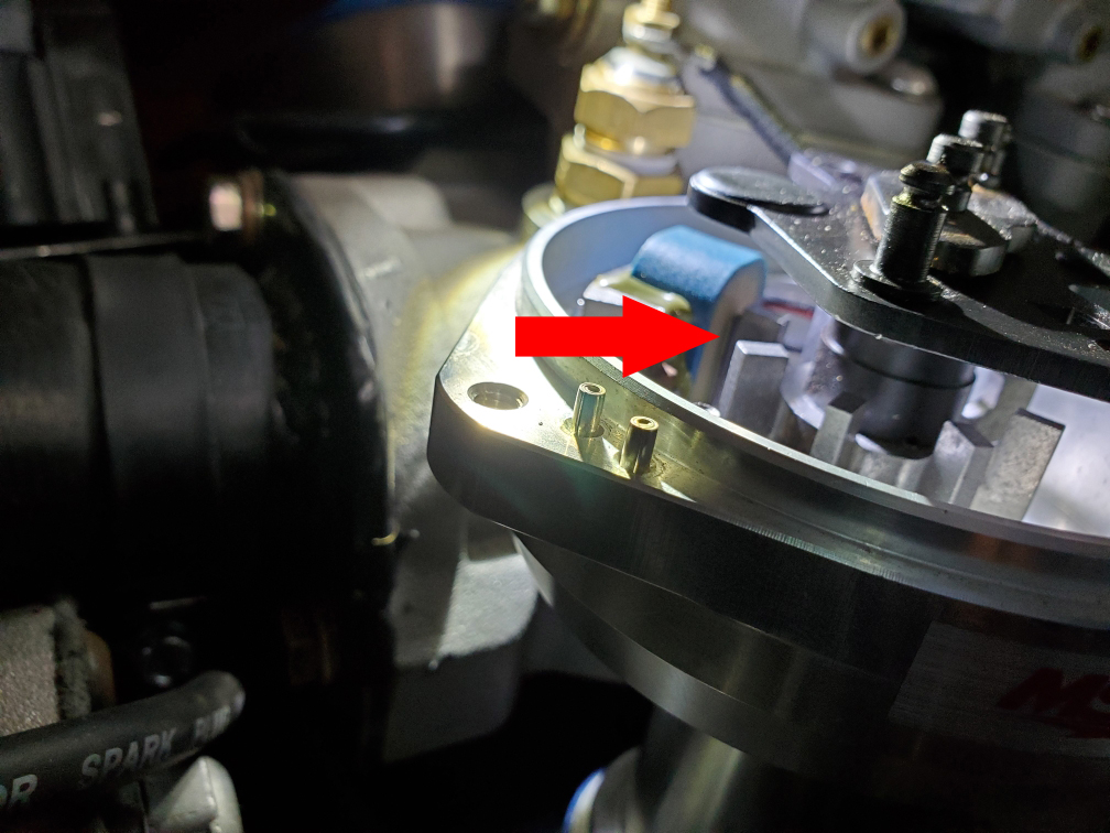

    ARROW on Pickup.jpg To begin, with the distributor fully engaged we rotated the body around and centered the closet fin on the reluctor wheel with the pickup. It has to be dead center on it. Then we locked down the distributor. This is when I discovered the before mentioned issue.
    Being careful not to move anything, I installed the hold down bracket and tightened it down. I just happened to have my hand on the top of the distributor shaft and I felt it make an odd movment. It is hard to describe, I mean it really didn't move, not a rotation, more of a stiffing up if you will. I loosened the bracket a bit and I could feel it realease. You could wiggle it a bit, you know just a few thousands of an inch. Not really even a wiggle, but you could feel it. However after tightening the hold down bolt a half turn or so, nothing. I told Dad, I don't like that...it felt like something was in a bind.

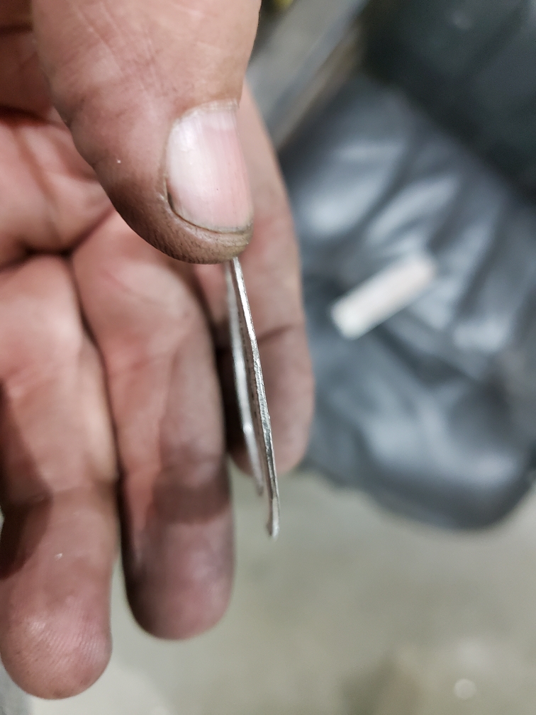

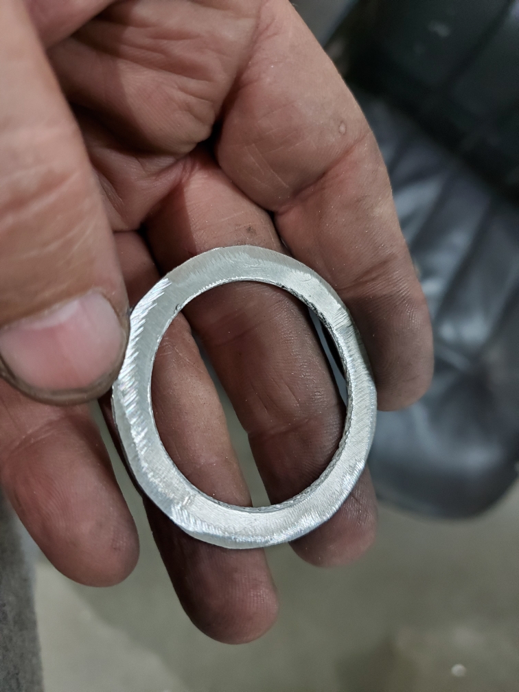

    Now I have quite a left over parts shelf after so many projects, but there was little chance of finding a .040 1.5" inside diameter shim on it. So we set out to make one. With calipers in hand we started looking for something to create one and you will not believe what we used. Zoe asked if she could help and I said we are looking for some really thin metal. She started looking and found a piece of aluminum that was .060 in a s**** box. That would have probably have worked but I said no a bit thinner. A few minutes later she hands me an old HAMB Alliance tag from the top of my tool box. It was .040. Freaking perfect!
    We clamped the tag to a piece of 2x4 wood block, drilled out the center with a 1.5" hole saw and then hand trimmed and lightly ground the outer edge to make a nice ring.
    It took few more light shaping p***es after the above photo was taken. But when I was finished it fit perfectly.
