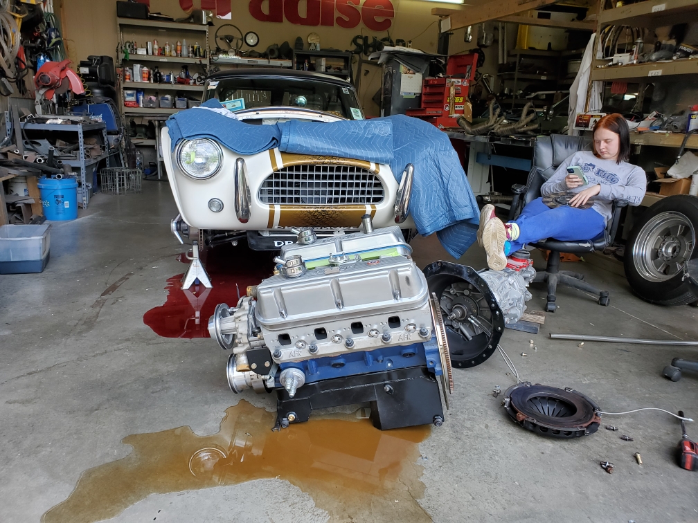

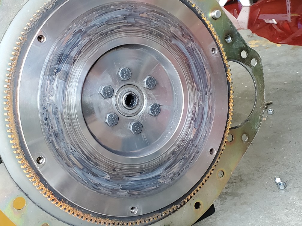

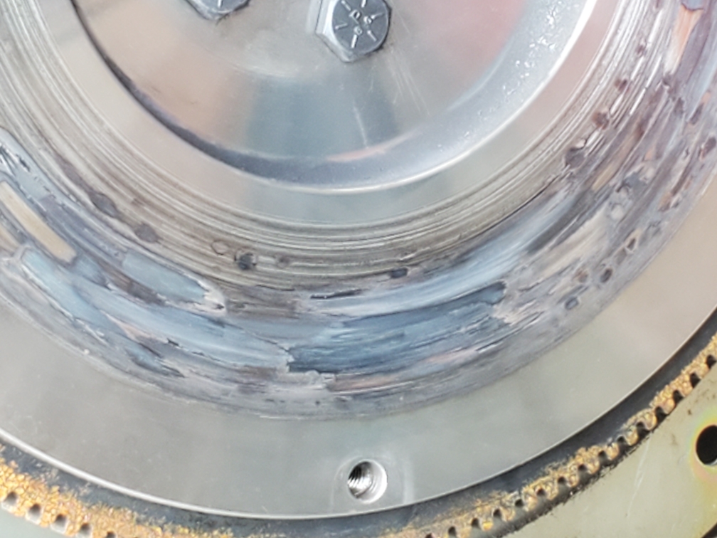

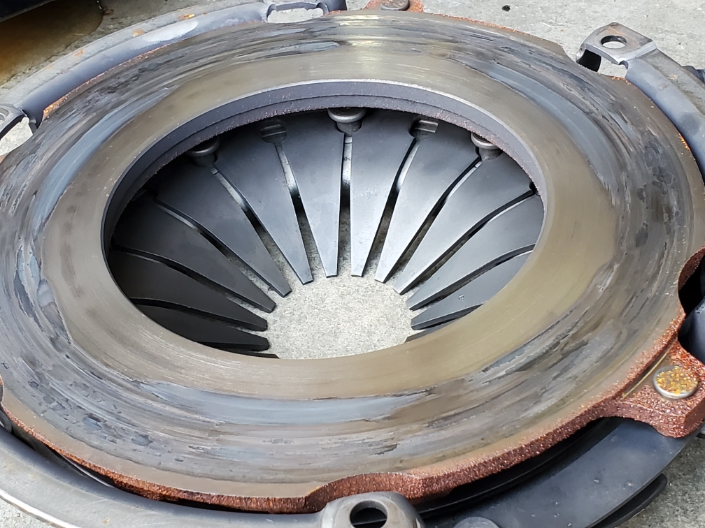

    Well the Cobra is obviously not going to make it to Ark City which we were really looking forward to. Sorry, I have not had time to update here for a while. Not to mention I am completely lost with the HAMB App. Hope the big guy gets something figured with there... Anyway last weekend we pulled the motor and trans to have look see.
    Resized_20210605_124137.jpeg What a mess. We knew we had to come out a pretty steep angle and my daughter was following the transmission tail out with pan but with the motor all but out and hanging precariously I had to reach over and push the trans down so the shifter stub would clear the firewall. When I did that, I actually moved the car a bit (doesn't weigh much without the motor and trans LOL). We had two jack stands on the crossmember area and after my tussle, one was only on by about 1/2 inch. So I had to quick snag the floor jack and come from the backside (because to the cherry picker), I knocked over the pan with trans fluid. From that point, the car was secure be we lost all the fluid to the garage floor. James said it looked like we killed the poor thing with all the blood on the floor. LOL

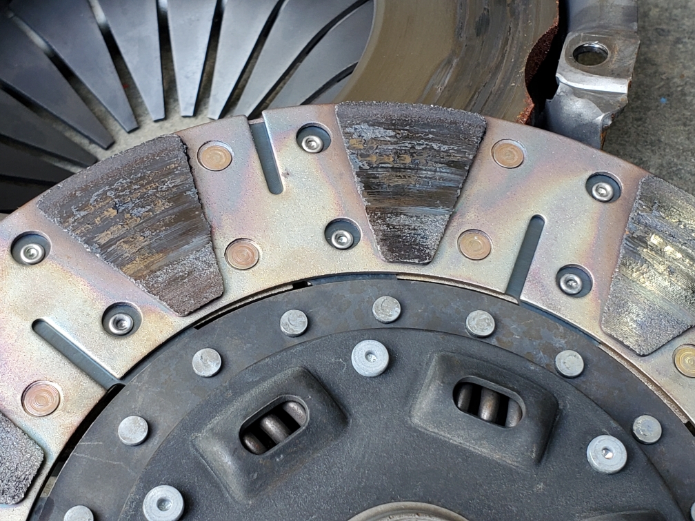

    Well we didn't kill the snake, but apparently after we got it apart, we did kill the clutch!
    So as you can imagine, I am not terrible impressed any longer with Mr. Silver's opinions on high performance clutches. I am currently shopping for another. It will likely be Mcleod twin unit. That is what I had in the Austin at nearly twice the horsepower etc. But I doing the correct amount of research right now before I take that plunge again.
    But for this weekend we are definitely out of the race. I am planning on taking Dad's coupe to support the event, but sorry boys, no Cobra!

    All good things take time. Did you check see if the clearance spec was in the ball park?

    Yep Seb, my clearances were still perfect (I knew they were). AND nothing had "Moved". LOL So just a ****py clutch in my opinion and dumb choice on my part. I was going back with Mcleod before they talked me out of it etc. Always go with your gut.
    I am still shopping around!
