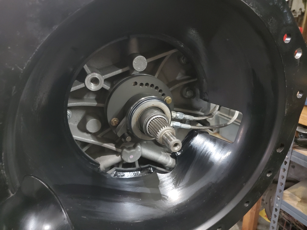

    So I heard from RAM and the clutch is scheduled for ***embly Tuesday. Now as I mentioned earlier this is a dual disk unit in a very tight place. We needed two hundred thousands spacing for the throw up but didn't have it.

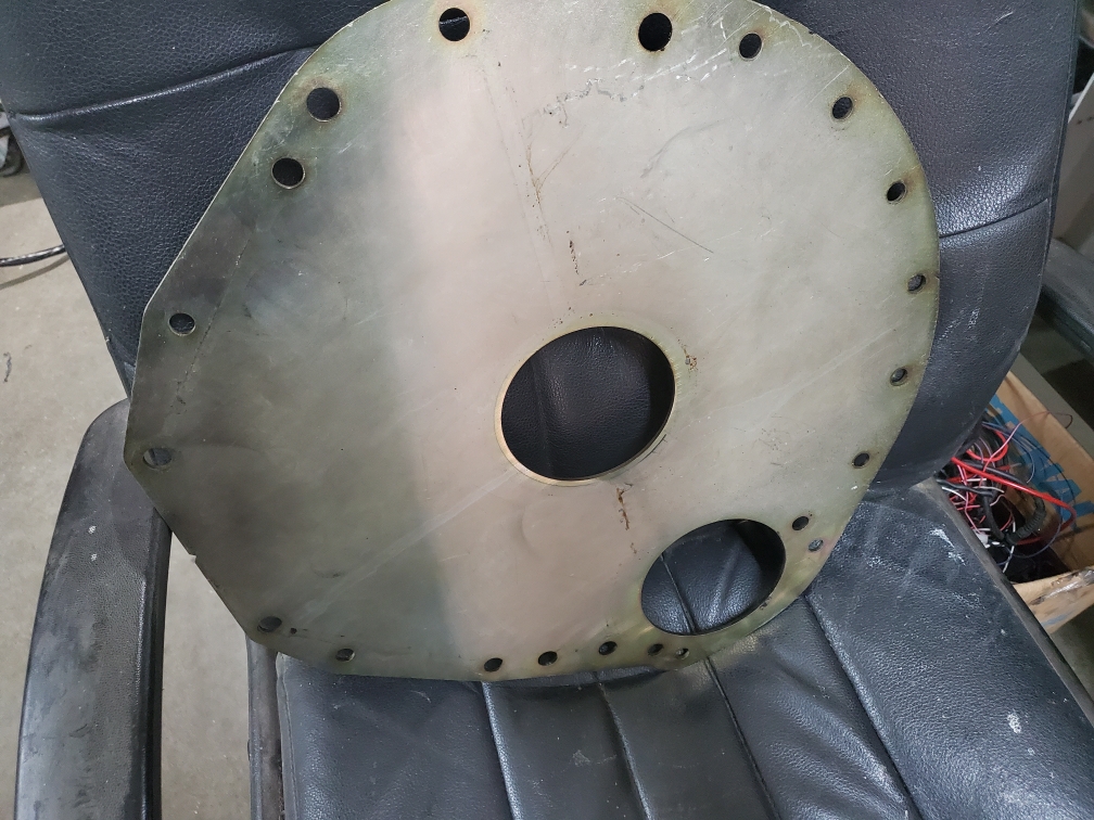

    Originally I had planned to simply snag another Quicktime ****tershield plate. They are .125" thick and that would give us the necessary tolerances and a pretty easy fix.
    So this weekend, with the clutch now eminent, I got online to order one. How hard could that be right. Well as it turns out fairly difficult. None of them looked like mine above. They all a different shape at the top. Just to be clear I was ordering a Quicktime unit. I am guessing they would have worked, all of the bolt patterns seemed to line up, but when I hit the order ****on, every performance sight on the planet said it would ship from the manufacturer. No estimated arrival etc.
    So I decided no big deal. I would just snag some .125" plate steel, trace the plate and holes etc. and then plasma cut my own giant shim if you will. I went out to the shop and after looking at the situation decided a better shim would be between the "TRANS" and the Bellhousing. So that is what we are going to do. Smaller area to trace and make etc. I am going to snag a piece steel today and see if we can beat the clutch etc.
    Seams the easier, smarter way to do it.

    Randall you might want to just make a block plate like you were goin to because the trans has to be centered in the bell housing properly so the trans to bell spacer has to be very precise
    Deuced Up! and loudbang like this.
  26. Joe H
    Joined: Feb 10, 2008
    Posts: 1,847
    Joe H
    What about the input shaft to crankshaft engagement?

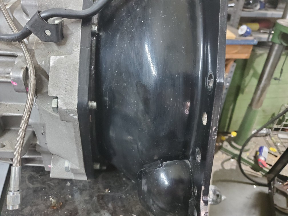

    Well as luck would have it, I do not have to fabricate anything. When I was talking to Silver Sport about potential problems with input shaft length with an extra plate they said you know we have plate that goes between the trans and the bellhousing for just such an emergency. LOL
  29. Deuced Up!
    Joined: Feb 8, 2008
    Posts: 4,224
    Deuced Up!
    It is sort of funny. Just like @Joe H, I am wondering if another 1/8" will affect the input shaft etc. I would bet good money against it but I certainly do not want to pull this all back out again. So I decided to err on the side of caution and call Silver Sport since they sold me everything including the bellhousing and plate etc.
    It took a bit to get through hold mode but I finally got someone on the line from the tech department. Without saying anything about how we got to this issue I just asked the question, would another 1/8" spacer cause any issues. He said no and then asked if he could ask me why I was spacing it out further. I said you probably don't want to know. He said, well inquiring minds you know? LOL
    I said well "Jack" sold me on a single stage clutch for this thing saying it would take 6 grand plus launches and shifts all day long. I said I just didn't realize he actually meant ONE DAY. LOL. I said we basically destroyed it in 3 burnouts and few hard launches. He said Oh No. I said no problem, I have RAM building me a custom two disk unit now but even with the new thinner style throwout bearing we still do not have enough room for required cushion etc.
    He said you know we actually have a spacer for your trans that goes between it and the bellhousing for just an occasion. Already contemplating fabricating my own I said so you have it in stock. He said yes. I said that sounds perfect, how much is it. He said, it sounds like I just need to send you one. I said I would certainly accept it. So pretty good guys over there even with the clutch craziness.
