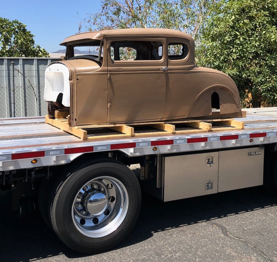

    I am trying to stay very focused on the Cobra right now because Saturday morning this little thing arrived and I am sort of chomping at the bit to get my hands on it.
    View attachment 5465082 [/QUOTE]
    Are you going to hinge the roof so you can get in and out of that thing! none of us are as flexible as we use to be. lol Glad to see you guys back at it. I was worried I might have to start learning by my own mistakes again! Larry

    milwscruffy
    That'll be a tight squeeze to get in and out of !

    SS327
    That was my intention! You have had some rotten luck with that Garden snake.
