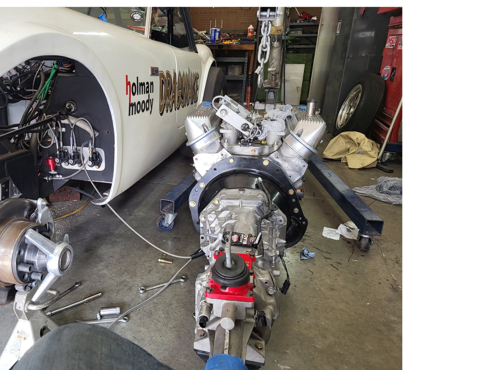

    Well she is back in place as of 10 p.m. last night. We are ready to start putting it all back together this week hoping to make it to the Route 66 Festival Car show here in Springfield, MO Saturday.

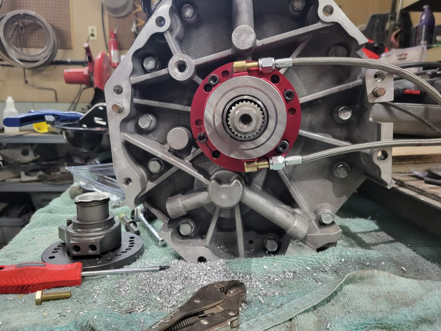

    This was our test bed, LOL. We had issues again with the bearing cushion. When we slid the trans on Sunday morning, very certain of ourselves and the process, it slid right on but stopped about a quarter of an inch from flush. After the last issue I stopped to have a good look right there and then. AND of course, the bearing was already touching the fingers. Now we had, as shown by our calculations two .050 spacers on it. So we pulled it back apart, took both of them off and we tried again. Same outcome.
    The crazy thing was still making contact with the stupid fingers. So we pulled it all apart and put the 3/8" spacer back between the trans and the bellhousing and put it back together. This time I could spin the bearing so it was not in contact. I took a .035 feeling gauge and tried to stick it between the fingers and bearing and it would not go. I tried a .025 and it went. I tried a .028 and it went but was tight. So I figure we are in the neighborhood of .025 ish, looking for .150. We spent a while to contemplating (if you were anywhere within a state or two you probably smelled the wood burning). LOL!
    To start with Dad found some huge flat 2" washers with that were just under a .120. We thought about just putting them between the block and the ****ter shield plate. We could have probably got away with it but really hated to half-*** anything at this point. The ****tershield plate was 1/8" thick and then suddenly it hit me. I have another one of them. When all of these parts started rolling in several years ago we didn't get a ****ter shield even though there was one listed. I called them about it but didn't hear anything back and in the meantime I took the part numbers and snagged one from JEGS because I needed it in there as were setting up mounts etc.
    Then about a year later, out of the blue one arrived from Ford Racing. Anyway we just tossed it on the shelf (the special FORD shelf where I am pretty sure misordered or miss fitting Ford parts go to die around our bowtie shop). Anyway sure enough I had one and it is .125 which puts us just over the .150 cushion mark by the hair of our chinny chin chin, but I will take it! The only modification I had to make was a precautional cut. The starter works perfect and ****s up against and bolts through the current ****ter shield. I didn't want to move it out any, not even an 1/8" so we marked it and cut it out were the starter goes, slapped them all back on and we are ready to rip tater chip!
    We hooked it all up there on the floor and bled the clutch. I took some doing to get all the air out of it but in just a bit, this is what we got!
    https://youtube.com/shorts/7vnPUmUexHY?feature=share
    As I said in the opening by the end of the night we had the engine and trans back in the car and bolted in place.

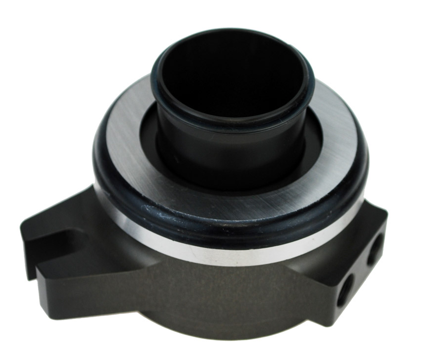

    I sat for quite a while. Running over in my brain what could be causing all of this. Then it hit me. It is the bearing width. The original RAM Unit that came from Tremec had a much smaller face, the second slimmer unit from RAM had the same size bearing on it. The one on the McCleod is three times as wide:
    The Mcleod is designed for a clutch where the clutch fingers are set in a wider configuration, our RAM unit has the clutch finger tips much closer in. So while this throw out is working perfectly in the beginning (in that it makes contact with compression points on the RAM fingers) but as it pushes them in it quickly gets to a point where (because of its width) the outer face area comes in contact with the fingers or bottoms out on them higher up. This totally changes the strength it needs to continue to push them etc. It totally explains everything.
    I talked with RAM this morning and Mike is amazing. He had not seen my transmission and simply sent me what the specs called for, not really his fault. After seeing photos of the front of my case he was floored. That is not what it is supposed to look like! The reason there were no real holes tapped in the case from Tremec was because on this transmission there is supposed to be a quill tube pressed in there. If you remember back to the stupid little aluminum adapter that Silver Sport sent with the trans in the first place... well apparently they removed the factory quill tube and came up with the stupid adapter to go in its place. In fact instead of being the model as marked on this trans and sold to me, this unit (while brand new) is actually the unit for early 2000-2004 Shelby Cobras.
    Had RAM know this (rather had I know this or the difference there in) none of this BS would have happened. So what to do? ....well the car is coming all back apart again, which I absolutely hate. I said as we were putting it back together this month if I have to do it again I am done!
    However after brainstorming with Mike here is what we came up with. Tear it all back down. Take the Mcleod unit out but since I have the case all drilled and helicoiled, drill out the aluminum plate so it can be put in place and properly screwed to the case. Then take a new RAM bearing cover, measure and take enough off the end so it does not contact the back of the outer clutch plate which is the issue that caused all of this nonsense. Then install a new RAM throwout bearing on it as we destroyed the last one, plumb it and put it back together with correct bearing cushion.
    I guess we will give it one more try. Mike took amazing care of me by selling the all the new stuff we needed etc. at cost and covered the shipping. I thought that was a pretty stand up thing to do since none of this was really his fault.
