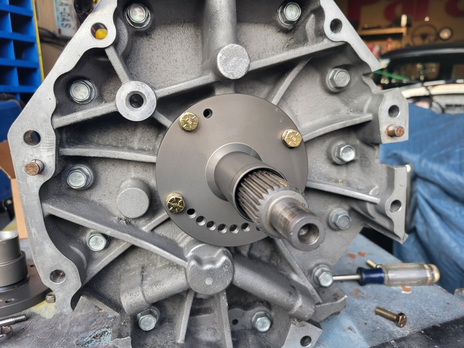

    So to start with if you look closely to the left you can see the original housing which is identical to the new one in place in the photo. So we removed the Mcleod stuff and dug out the original Silver Sport adapter, fortunately it was hanging out on the used parts shelves. I decided to use the original as a test mule for drilling the holes etc.
    I put it in place real quick just to see if any holes matched up. Believe it or not two of them aligned perfectly. We also had to make sure all of the hole choices for the floater pin were in the seven o'clock-ish range. The racing gods must be smiling on us this afternoon because that is exactly where they were after aligning the two bolt holes that worked.
    Now I had to drill them out a bit to get the large bolts through and then marked and drilled the other two holes and test bolted it down without the adapter. You can also see where I marked the tube there on the end to be cut off. This will prevent it from bottoming out on the back of the rear clutch plate like last time!
    Then we took the aluminum adapter, put the test housing on it and rotated it around until none of the original holes were showing, marked it and drilled it to match the test housing. We also marked and drilled out where the floater pin screws in so it did not bottom out on it etc. Then we took the test housing and marked and drilled the new one. Above is where I originally thought the floater pin would go but after test fitting the throwout assembly it hit the bolt head there and would not slide all the way back. So we had to take it apart and redrill the adapter so the pin could go in the next hole down.
    We test fit the housing and the adapter etc. I tightened it down and we took feeler gauges around the inside of the housing between it and the shaft. It was as close to perfectly centered as you could get so we took it all apart again, put thread lock on the bolts, reinstalled it and slid the throwout assembly in place.
    Now my nemesis, the freaking bearing cushion! I hate this crap with a passion. I think I would rather block sand a car than try and take these stupid simple measurements. The first thing we did was measure from the mounting surface of the trans case or actually the spacer on the case as shown above.
    Then we measured from the housing mount surface to the clutch fingers. We did it a couple of times and ended up using a .060 shim. When we did the math that gave us a cushion of .165. We are looking for .150 according to the manufacturer. However I have had several discussions with folks in the know that .100 is a better number. We put in a .030 shim, and double checked our measurements and math again and that gave us .135 which is close enough. About that time I looked over at the test mule housing and that is exactly what we used the first time, so we feel pretty good.
    We also double checked the length of the housing tube and according to our match we have nearly .5" between it and the backing plate. Perfect.
